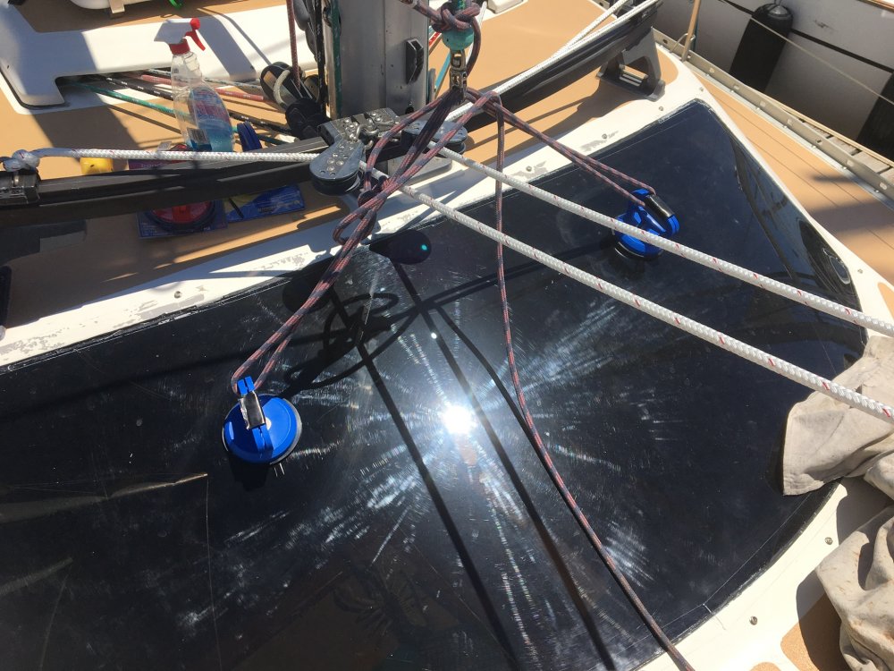

F9A15675-92AD-44E5-B7D3-BB3F128D3866.jpeg It doesn’t work on wrap around windshield it helps but the wedges and a Dremel from inside will, but don’t plan on reusing old windshield

So you don’t think it was the Sikaflex that failed on the boat yard installation but the fact that the windshield was 1/8” bigger than the bedding hole would be my guess. My new windshield was cut smaller and fits in bedding hole a lot better

I have a second problem with boat yard after they laid new glass and resin the bedding surface on both right and left side on top was not flat and straight the window was sucked down by the glue and it looked like a sign wave the old bedding had been redone and beat up pretty bad when the 1st windshield was removed by them we saw the damage so I’m going down to re resin and glass so it will match shape of new shield

So when we look at what happened it proves that if surface the glue is on is not even and straight which this one is not you can see with out straight edge then the glass will be pulled down where the bed falls down and up where it rises I have the pics of the upper wave form

The previous owner had auto bondo falling out when the 1st window was pulled so we have to rebuild correctly
