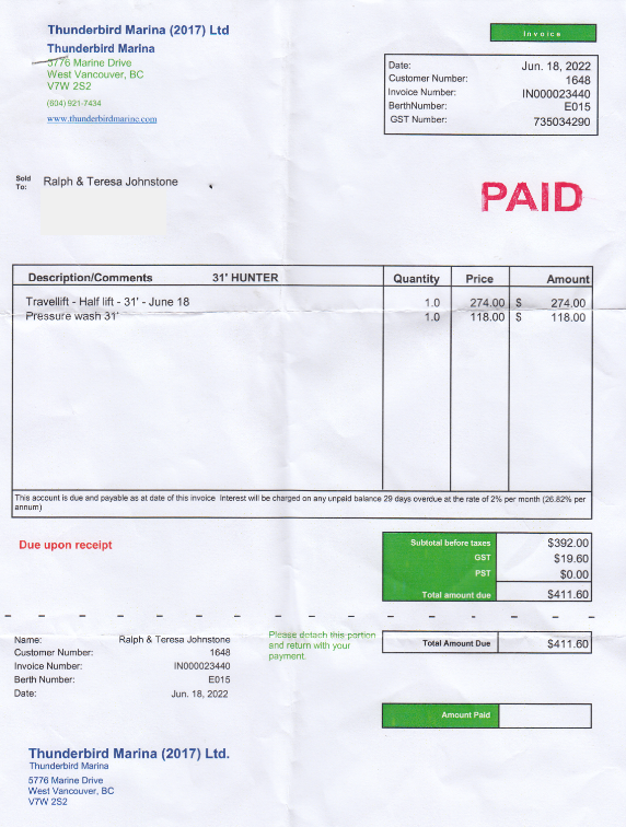

Jan 4, 2006
7,870
The corrosion is annoying but manageable.
Given deep pockets, yes.
A half lift every year is $274.00
A full lift is about $450.00.
My last period between bottom paintings was 7 years and it didn't need it. Looking forward from here and ignoring inflation, each time I would have to patch up my rusty keel would be an extra #176.00 plus yard extras plus finding a small amount of bottom paint and a few other plusses.
My planned life expectancy for my current bottom paint is 10 years. I only plan to pay for a full lift if work is required.
Given two new identical boats, one with lead and one with cast iron, I'd gladly pay the difference between the two metals for the lead keel.

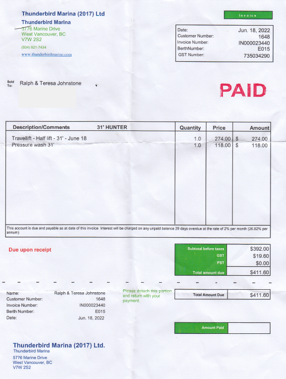

May 17, 2004
6,262
Fair enough. Around these parts seasonal hauling for winter is common anyway and included in annual marina contracts, so no additional cost for an out-of-cycle haulout for the keel.
