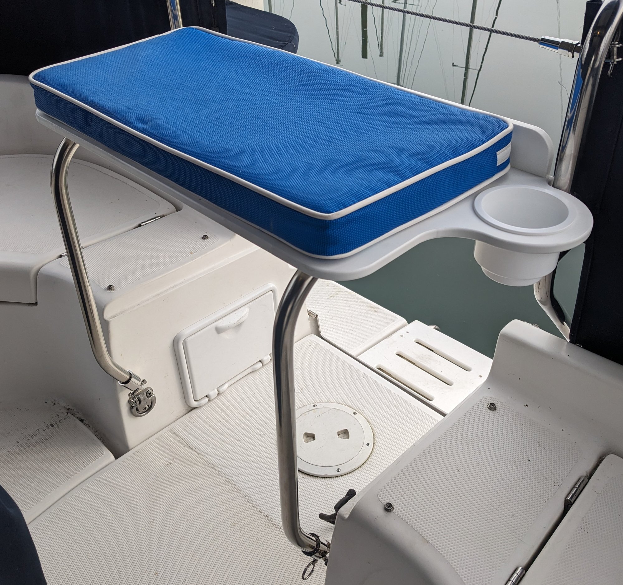

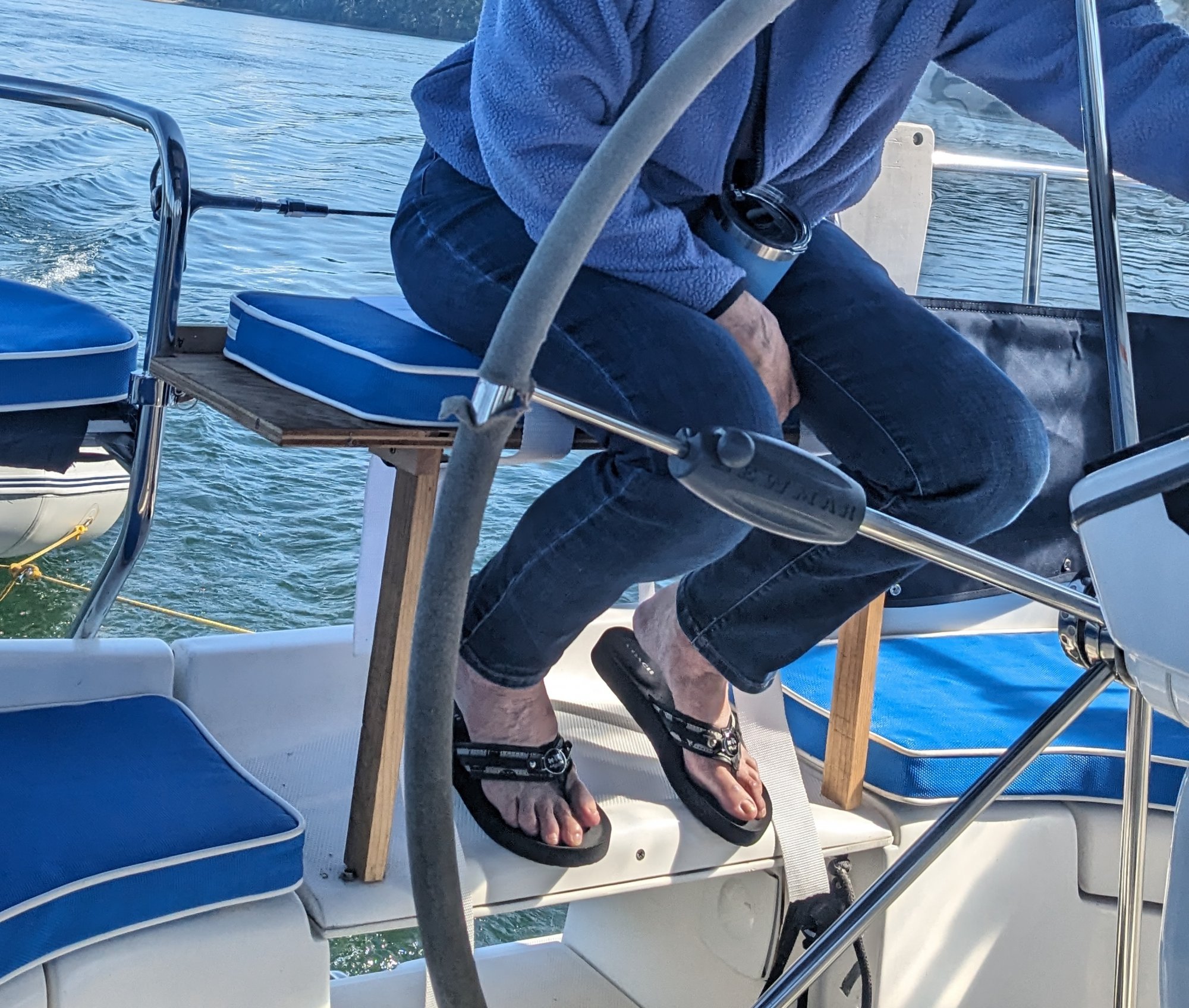

Ever since we got our boat we have had issues seeing out over the bow while seated in the cockpit. I came up with an idea for an elevated helm seat last year and installed a proof-of-concept plywood prototype which we used for the whole past season and were quite happy with.

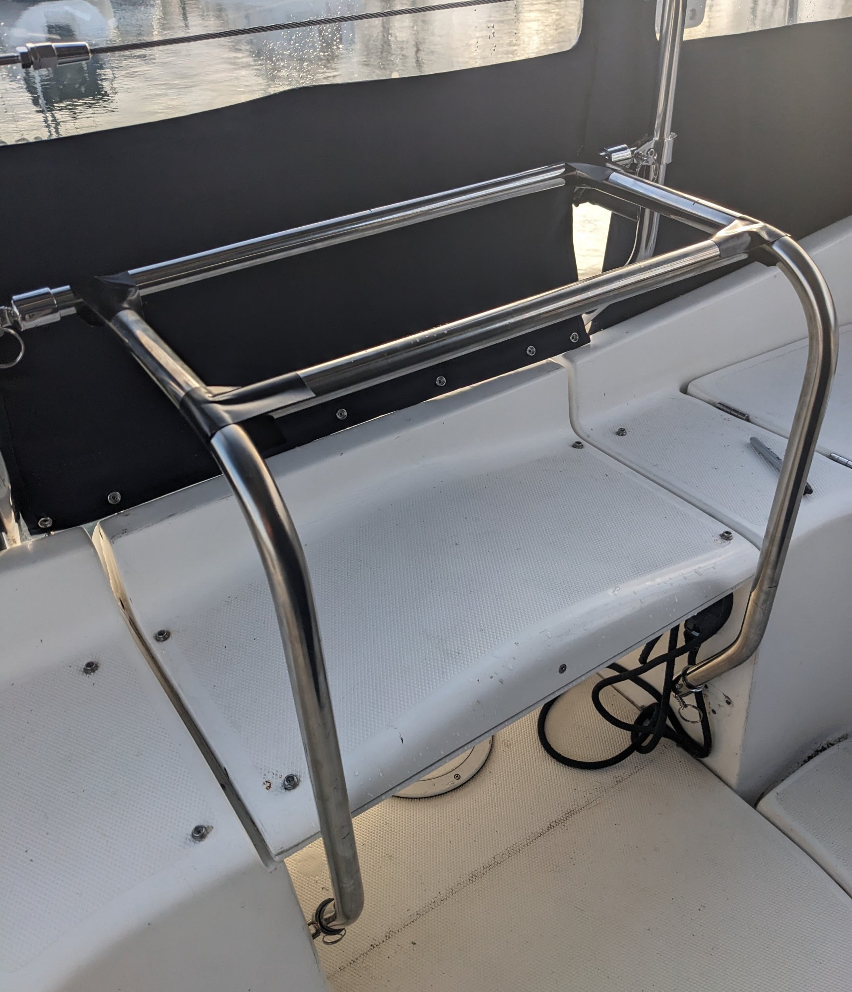

I designed the support frame to be constructed out of 1" stainless tubing and had a local shop do the bending and welding. I have a small home machine shop so I was able to do all of the metal work in preparation for the welding as well as cutting the seat base out of Starboard.
Today, I finished the installation after having installed the support brackets for the lower legs which fasten through the fiberglass into a 1/4" aluminum backing plate. While I was at it, I also installed a pair of padeyes to be used as tether anchor points which use the same backing plate. The helm seat can be removed by removing four clevis pins.
The first photo shows the plywood prototype in use. The second shows the seat frame prior to being welded up and the third shows the completed installation.

I've attached several files. The first shows the bimini fittings I used - two of the top one are needed, four of the middle one and two of the bottom one. I got mine on eBay but they are available at West Marine, Amazon and elsewhere.
On the top and bottom ones the screws circled in yellow are discarded and the holes are drilled out to accept a 1/4" clevis pin. I used spring loaded clevis pins because they're one piece but the traditional ones with the curly cue clip work fine, too.
Here is an Amazon link for the spring pins:
Amazon Spring Pin
The other two files are drawings. The first is the support leg of which you'll need two. These were made from 1" 304 stainless tubing with a 0.065" wall. The shop that did the bending (Sheffield Propeller in Portland) used a mandrel type bender and that is the minimum wall thickness that they could bend without getting wrinkles on the inner radius. West Marine has 1" 304 tubing but it is only 0.042" wall. The bending shop ordered the tubing from their supplier. The lengths of the ends shown on the drawing are a minimum - you'll want them left long so that you can trim them to the exact length needed as determined by a test fitting on the boat. The shop bought two 6' lengths and bent one of the seat supports using each of them. The excess length was cut off and used for the two side-to-side straight pieces. The ends of the shorter one needs to be "fish mouthed" so that it fits closely around the half-diameter of the leg pieces. The same is true of the upper ends of the leg pieces.
I made a jig out of plywood to hold the pieces in their proper positions, square and plumb. The tubing was held down to the plywood using screws through the tubing (which are eventually used to affix the seat base) and some clamp pieces that I made out of 2x4 lumber that straddle the tubing and hold it in place. The plywood jig was actually a horizontal piece and a vertical piece and the assembly fit into that L shape upside down. I cut large circles out of the plywood in the areas where the welds were made so that the assembly wouldn't need to be removed from the jig to fully weld it.
After the frame was welded up, I test fitted it in place and determined where the lower legs should be cut so that the hinge fittings fell in a suitable location. On the port side, you can take the ceiling panel down in the port aft corner of the aft cabin. That is where the autopilot steering actuator is located on our boat and you can see the inside of the port side wall of the walk-through to the swim platform. On the starboard side I might have been able to reach the back side of the walk-through wall from the swim platform lazarette but I chose, instead, to remove the swim shower fixture allowing easy access to the back side of that wall. The fixture was sealed with a silicone-like sealant that had to be cut through with a putty knife before the fixture came out. When I re-installed the fixture I used 4200 sealant.
The "eye endcap" bimini fittings were blind riveted onto the tubing using stainless steel rivets.
The padeyes that I used (which are optional, of course, but nice to have if you're going offshore) are Wichard 6605. I got them on eBay but they are available at West Marine, Amazon and elsewhere. The backing plates were cut from 1/4" 6511 aluminum plate. At the final fitting, I used TEF Gel on the 316 stainless screws that hold the lower brackets and padeyes to the backing plates. I drilled and tapped the hole pattern for the padeyes in the backing plate in my shop and then used screws through those to hold the backing plate in place on the boat which then allowed the holes for the lower leg brackets to be drilled/tapped precisely where they needed to be for the seat to be plumb and level.
The seat base is made from 1/2" Starboard. I bought a piece large enough from TAP Plastics for both the base and the vertical part at the back of the cushion. I made a template for the seat base out of some scrap Starboard. I was able to cut nice smooth arcs and straight edges using my vertical milling machine and a rotary table. I then cut the actual Starboard piece to the rough shape using a reciprocating saw and then used a router with an edge routing bit to follow the shape of the template which was clamped down to the base material.
The drink holders are identical to several others on my boat. They are Beckson Marine GH43-W1. I got mine from powerboatsupply.com but you can find them on Amazon and eBay, too.
