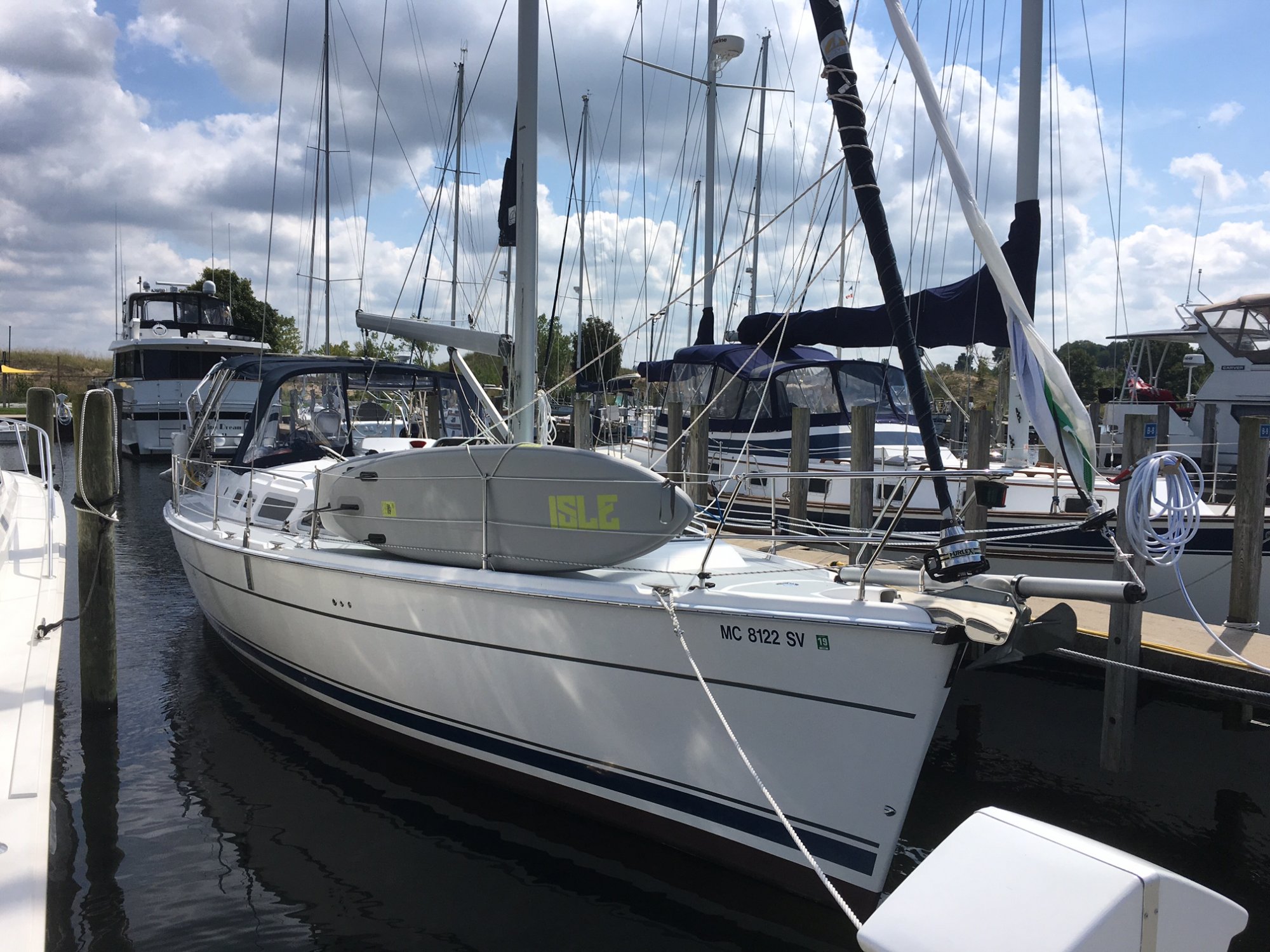

Not a Hunter 41AC/DS with a fractional rig, but my Hunter 386 fractional rig topdown furler tack was attached to the anchor roller ahead of the jib halyard so anti-torsion cable cleared the jib halyard without fouling and head halyard swivel bar to mitigate mast abrasion by the anti-torsion cable.
I am now using this setup. I used it a fair bit (couple dozen times maybe at least) over the last 8 or 9 months.
1. I used a halyard shackle to attach the bottom of the furler to a hole already extant in the center part of the bow roller assembly (dual roller). I think it might be intended for a retention pin for the anchor which I don't use. A snap shackle might be a better option if you think you may need to get it off quickly.
2. Regarding getting it on and off quickly, its unlikely honestly as you'll be reaching far over the bow pushpin and its not comfortable and would be dangerous in anything over a light chop tbh
3. Think about where the fairleads for the furling line (continuous?) need to go. The drum will likely be at a pretty good angle to the deck and you may not have a good location, or the location may prevent the anchor locker being opened while in place. I made up some small Amsteel soft shackles, but that's a temp solution, I'm going to fabricate something.
4. Regarding 2 and 3, that means you'll be installing/removing the spinnaker/furler assembly, furling line, and its fairleads at anchor or the dock. Find a place to clip off the spinnaker halyard that doesn't chafe against the spreaders or anything else (don't ask how I learned that one doh!)
5. Make sure you have a way to prevent the furling line from moving to prevent inadvertant deployment.
6. These things are a bugger to use. I purchased sail sfbay's unit. I cursed it a lot. In fact, for the first half dozen or more uses it was not really a top down furler, in fact it's still not a top down furler, but it's at least a furler now. I was just an automatic back wrapping device.
7. More tension on the torsion cable (at least for this crappy CDI designed unit) is not the answer. You don't need massive tension on it. When I learned to ease it off a bit it made furling easier. Its not something really doable single handed either, crew needs to ease the sheet fairly rapidly but in concert with you furling, keeping the sail luffing juuuuuuuust the right amount so you get a good wrap without big bubbles or backwraps, takes practice.
8. Get some breakable yarn (thanks for the tip Steven) and tie a half dozen around the furled sail to keep it together and help prevent accidental deployment and keep the sail nice and tight before you need it.
9. Sailing to wind with the sail up but not deployed is doable but it will cost you several knots as it spoils the wind over the jib
The CDI design I have is an early entry to the marketplace and I hope designs have improved. Honestly mine is a poor design, for example relying on the supposedly low drag of delrin bushings instead of having a proper bearing in place. Of course, that low friction property of delrin does away when any tension is put on it. I'm considering modifying the top part and milling it out to accept a proper tapered roller bearing instead.
I find it much easier to gybe the sail around in front of the boat that furling/unfurling or chicken gybe. I head off to 120-140, ease the sheet till its luffing a good amount, then start furling rapidly while my wife continues to ease the sheet.
fwiw idk why the term "anti-torsion" cable is used. This is, in fact, a torque or torsion cable. It is intended to transmit the torque you apply at the furling drum up the length of the cable. imo the "anti" is improperly used.
