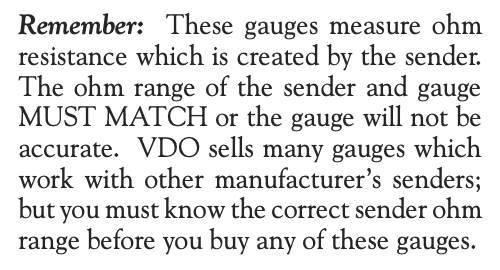

24,453
I replaced both the sender and gauge.
Maybe the gauge range is, and has been, wrong
Temp Gauges have a temp range. They need a sensor that matches the gauge range.
I just bought a new sensor for my VDO gauge. The range of the sensor needed to be 12V, 250º, with an ohm reading of 30-240.
The VDO install manual says it very clearly. What is good for a VDO gauge applies to the rest of the world... Even Hunter boats.
Also when installing the sensor do not use teflon tape. A dab of pipe dope is ok, but tape can block the ground the sensor needs (metal on metal) of the engine block to properly work.

Problem has to be a mismatch between the Yanmar OEM senor and the no name gauge. I would think a Yanmar gauge would match as I installed a genuine Yanmar sensor and it doesn't matter that it reads in C to me. But the cost difference is just hard to accept.
So replaced with an Yanmar OEM gauge to go with the OEM sender and it reads correctly now. The Yanmar gauges must have a different ohm range than "vdo" gauges. I bet the boat didn't come from the factory with a Yanmar sender and gauge.
