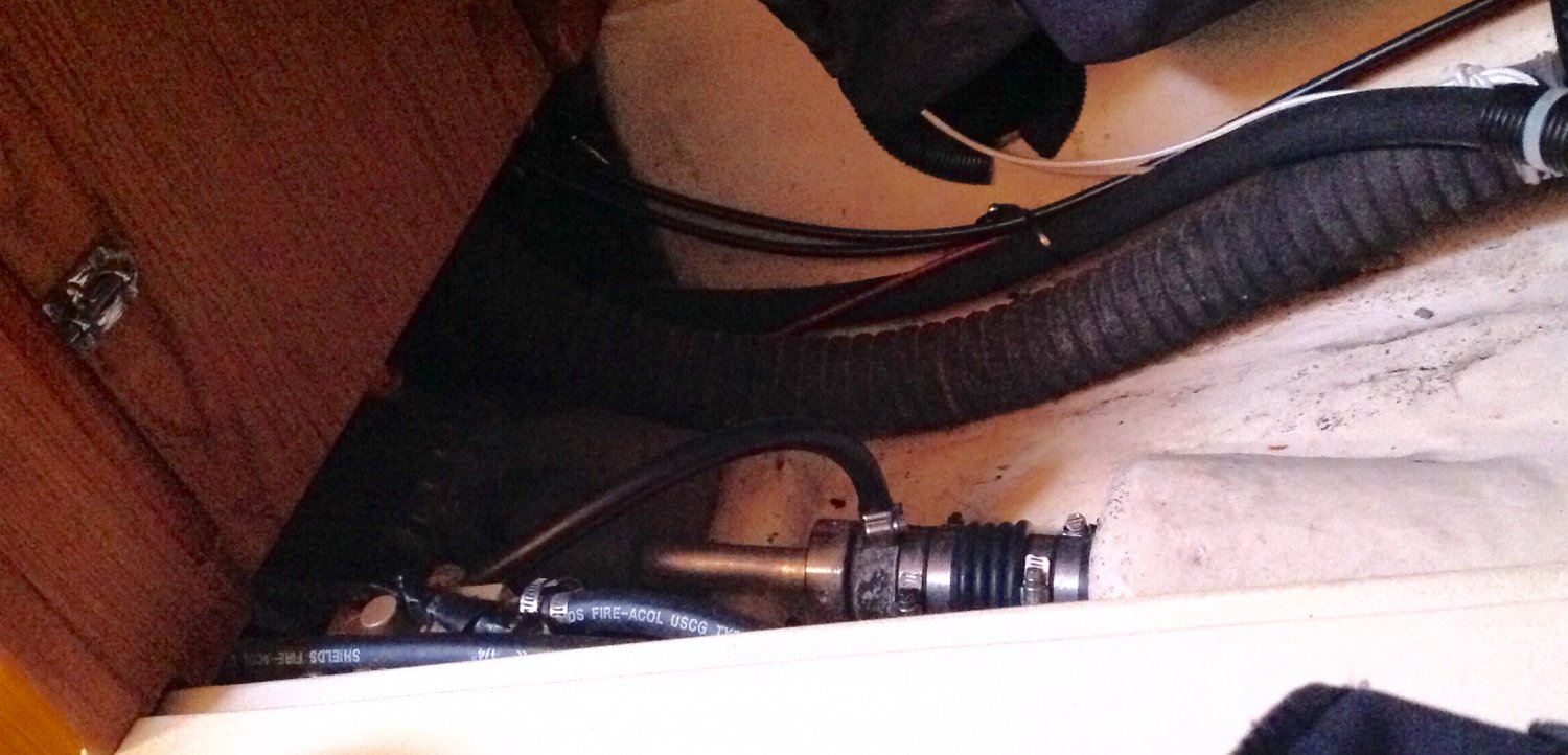

I think my shaft seal is wrong. The manual says the stern tube is 2-3/8 OD and the PSS seal is 1-1/4x2-3/8. But my boat has a different shaft seal and the tube is clamped around the fiberglass. Could this be wrong? Is the stern tube suppose to stick all the way into the boat and the shaft seal tube clamp around it?

Basically, should the shaft seal tube be clamped on the stern tube that is bolted to the outside of the hull, or to the fiberglass inside?

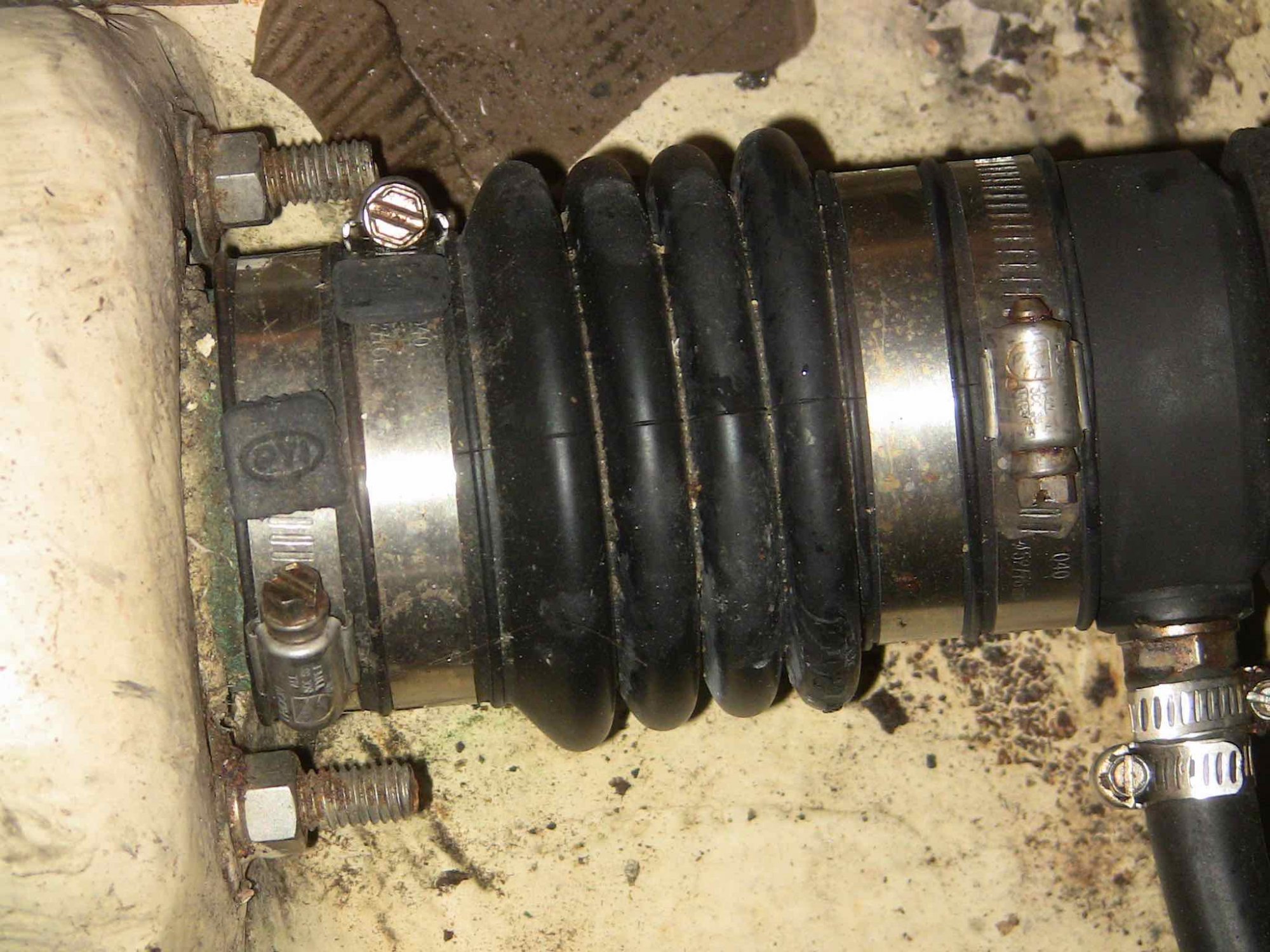

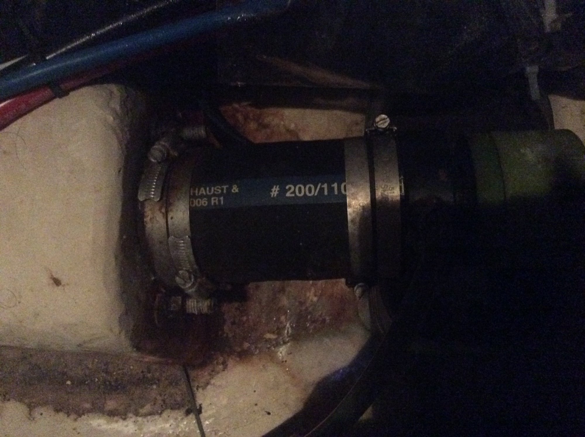

Guess maybe it isnt like I was thinking. Going to measure the diameter of the hose, but assuming wall thickness is 1/4” this looks like a lot more than the 2-3/8” that the manual lists for the oem PSS seal.

I changed out my PSS Seal on my Hunter 30, last year. The diameter of the shaft is important, as the PSS unit is sized accordingly. Once I pulled the boat, the hardest part was breaking the shaft seal to allow me to remove the old to add the new unit.
My old PSS Seal did not have the hose that is shown in your picture, so had to add a loop in the engine compartment to acomodate the hose.
Well the the circumference is 10" and after subtracting 1/2"for the thickness diameter works out to 2.6". So within unknows that is pretty close to 2-3/8".
Guess it will have to wait for haul out to pull apart before ordering a replacement.

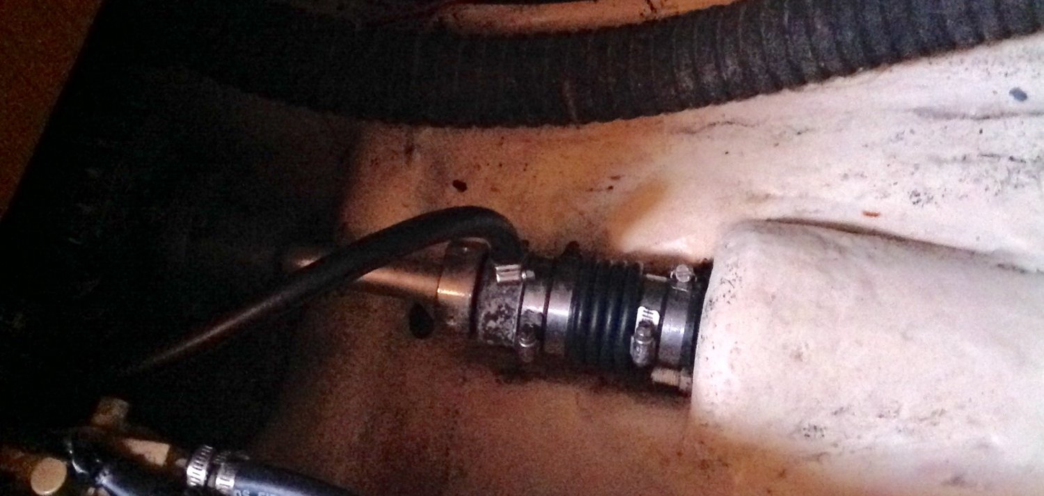

Here is the shaft seal fro my boat. Same as yours.
Pss Shaft Seal 1-¼" Shaft 2-¼" Tube

Now the challenge I have is removing the coupling. Could not do that so ordered a new split one and will have to cut the old one off. Project schedule for next haulout.
