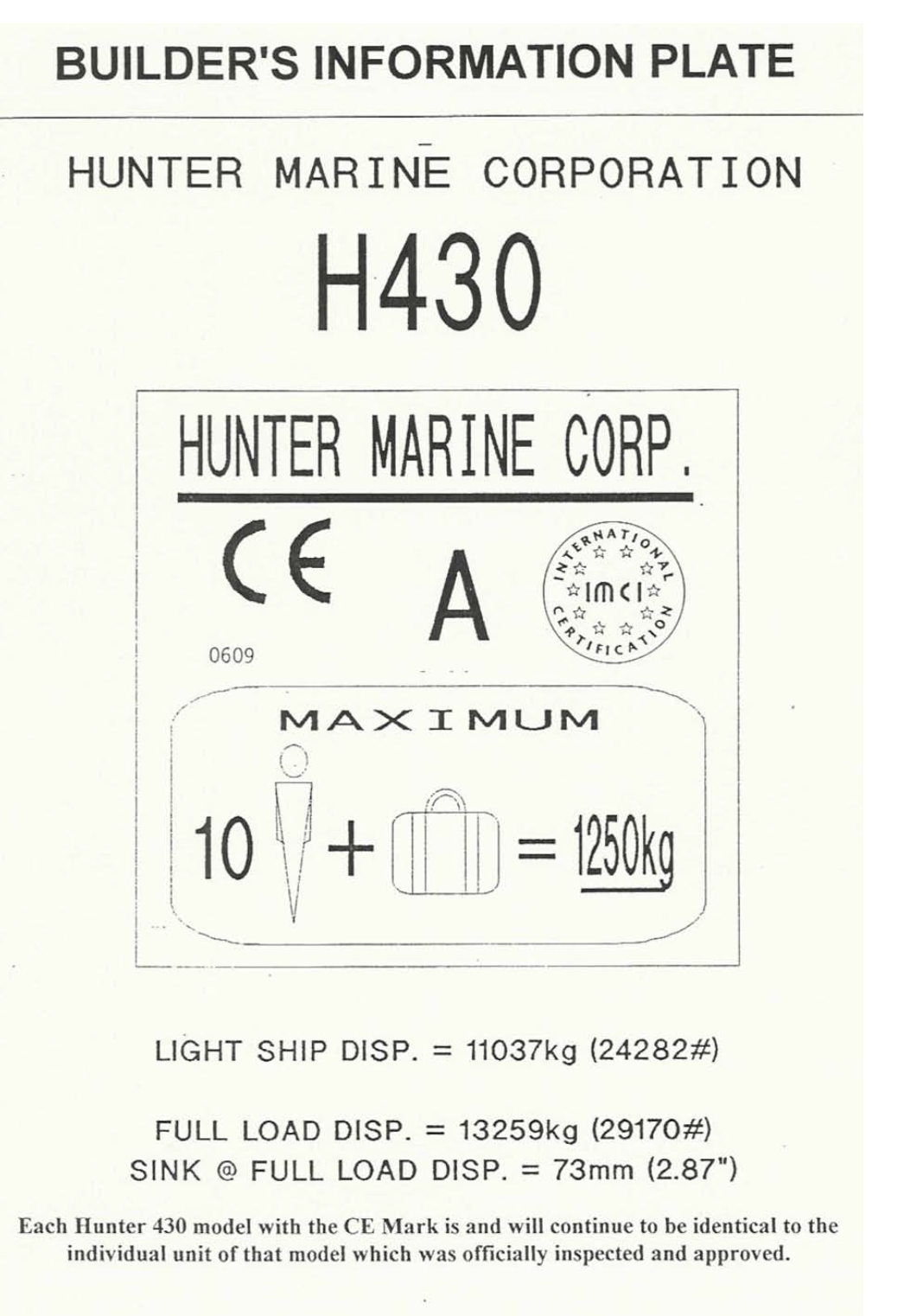

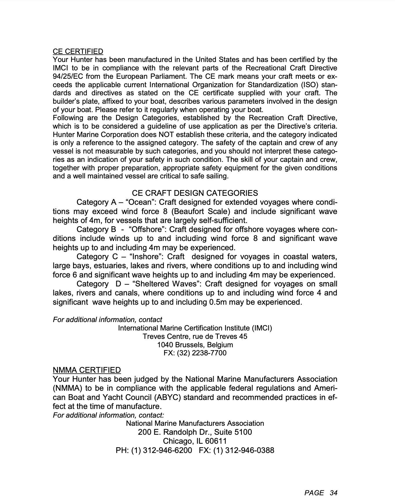

Hey guys. A friend and I are attempting to start up a little day charter with our newly acquired 2008 Hunter 41 AC. Some items we are missing to proceed with the process are "Builders Plate' information stating maximum persons / weight allowed on board that you usually see affixed to a vessels hull usually in the cockpit area. We have not been able to locate this plate on the boat or see reference to it online. The 2004 manual states that there is a builders plate affixed to the boat but does not show a picture of it. The 2008 manual that we have doesn't even mention the plate. I can see this information provided on other Hunter boats manuals for instance the 40.5 shows a capacity of 10 persons.
Another item we are missing is any documents detailing the buoyancy, flotation, or stability of the vessel.
I was wondering if anyone with a Hunter 41 produced from 2004-2012 may have a builders plate on their vessel that they may be able to share the information with, and if anyone knows anything about the other document on stability that our governing body is asking us for.
