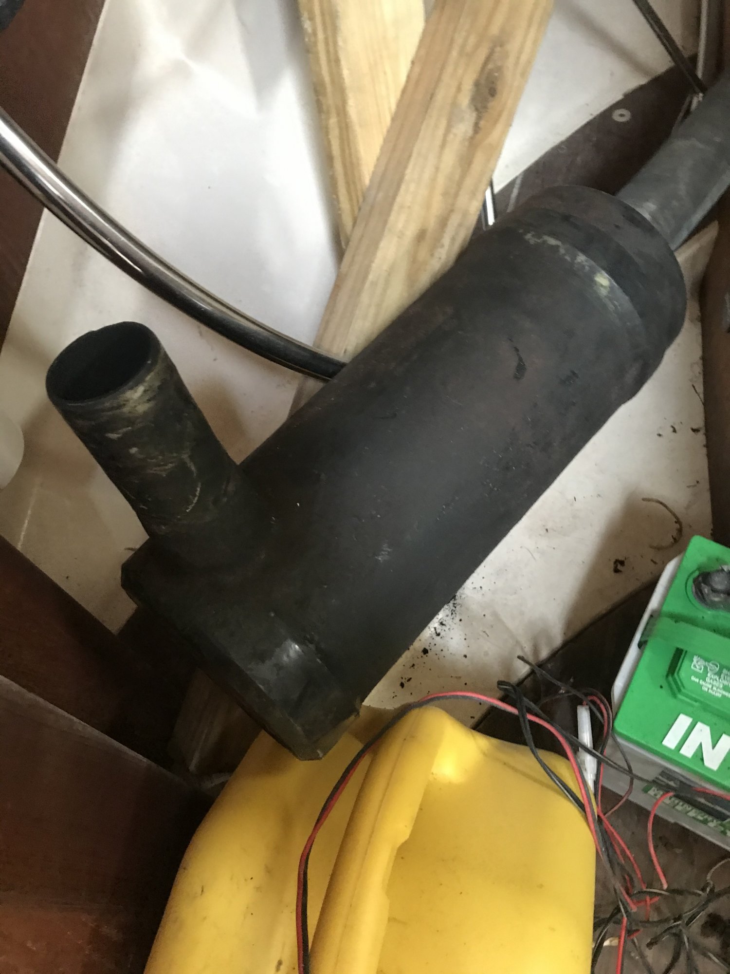

H hunter healer . Jun 12, 2013 213 Hunter 40 back creek Nov 17, 2019 #1 Is this correct? Wet muffler is mounted under the engine and i was wondering if anyone has a better solution for mounting this one? Attachments C0C60A6D-F503-4704-A513-6FEAD4E3A2E8.jpeg 309.6 KB Views: 219

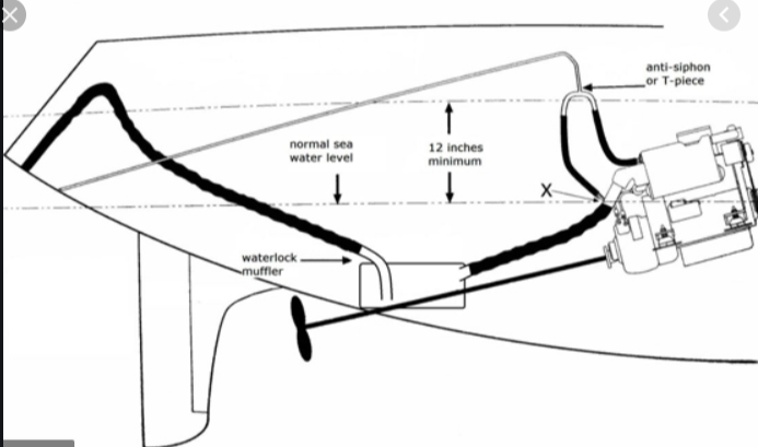

sail sfbay . Feb 21, 2013 4,638 Hunter 46 Point Richmond, CA Dec 8, 2019 #2 Could that be a waterlock muffler as shown in the diagram below? You might this article relevant: Maintaining your Diesel Exhaust
