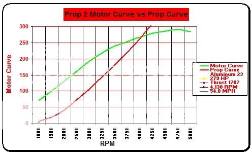

Yeah that's beneficial at sub max power IMO. I think you will find if you look at the power chart of your engine and the power delivery chart of any prop you will find that the engine curve bulges up and the prop curve goes the other way. What that means is that when a prop which is geared to deliver max power of the engine, there will be a massive excess of available engine power in the lower RPMs. In other words it will not be overloading the engine at lower revs with too big of a prop and you will be getting more power into the water at lower revs. This comes at the expense of overloading it at high revs, and max power loss as the engine never reaches max power.
For me that is fine as I never run anywhere near max power.
radom pic I found
You can see the prop is chosen here so the prop curve aligns with the engine power at just over 4000rpm (which will allow max speed as that is close to max engine power) but at 2000rpm the engine can produce around 3 times more power than the prop can transfer to the water!
If they really only cared about top speed they could reduce the pitch even more so the curves lined up at 4750rpm. This would result in horrible low RPM performance though!

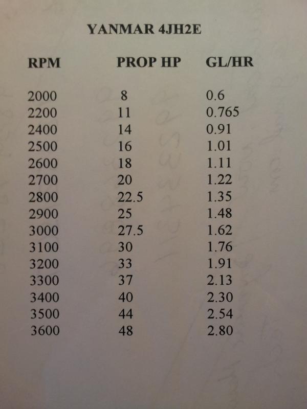

Thanks guys! That fuel table could be handy!

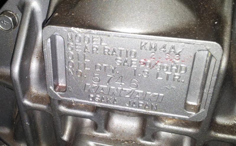

Trans ratio stamped on back of box. 2.63
