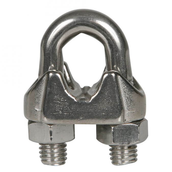

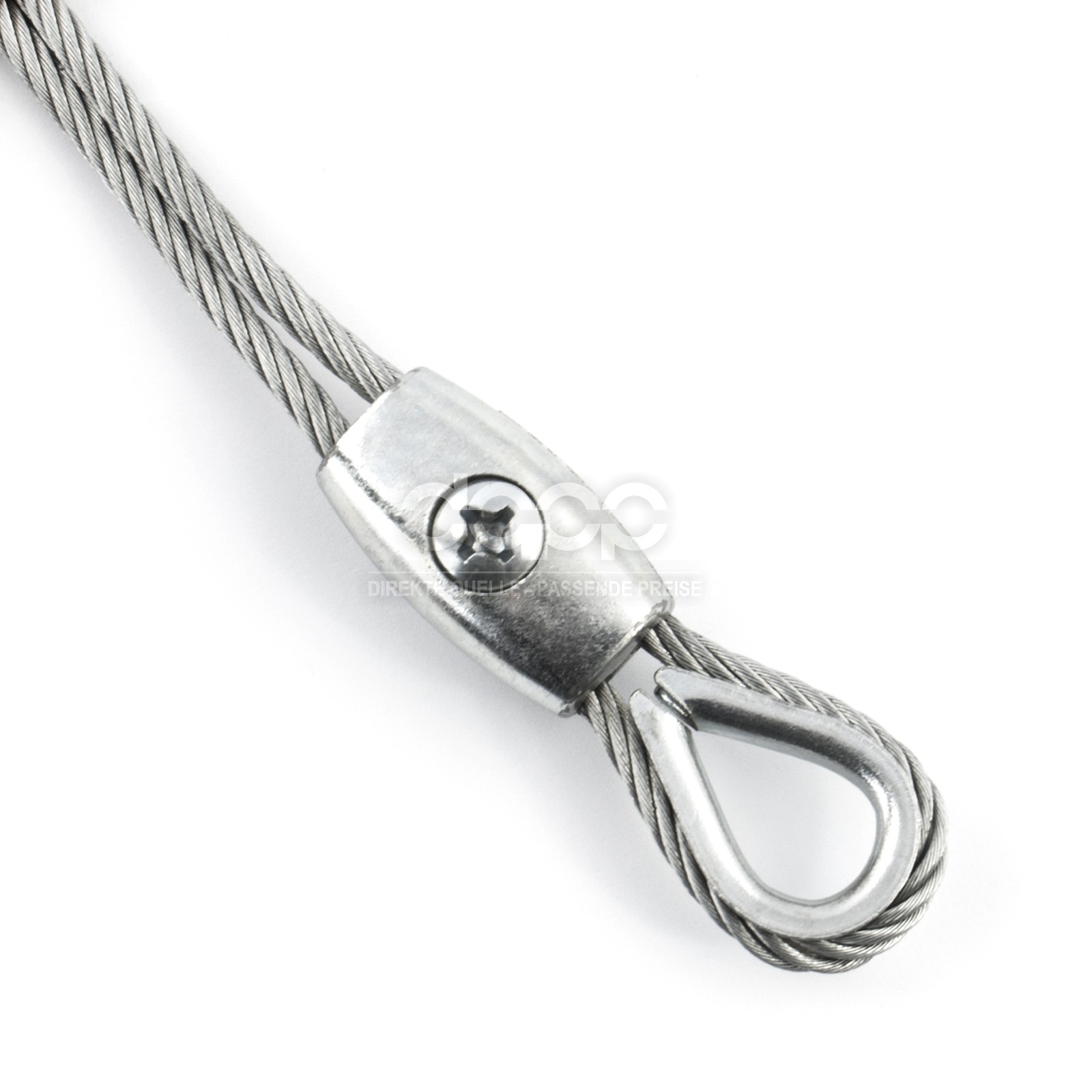

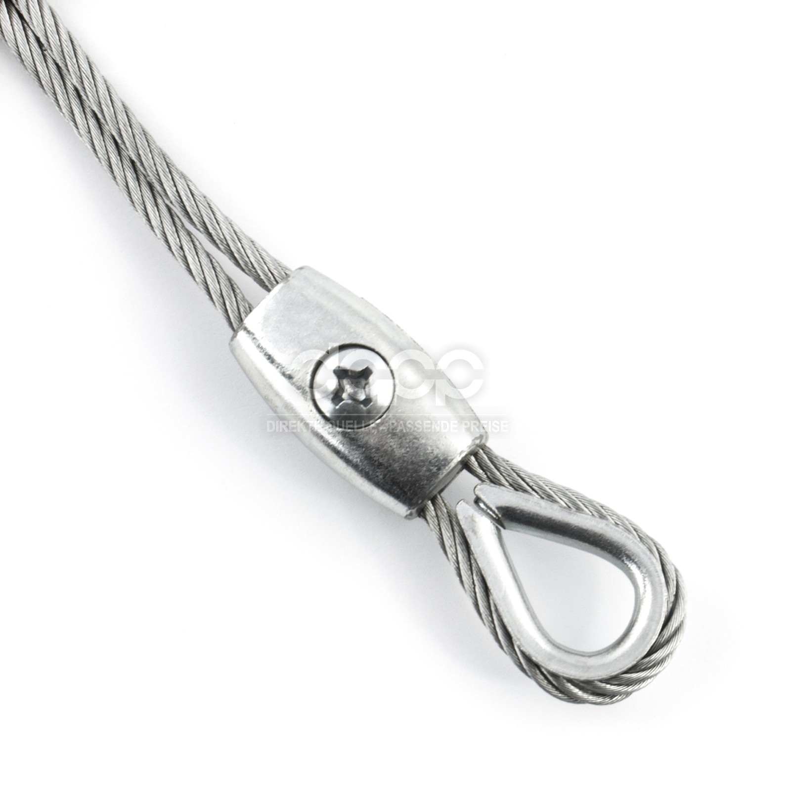

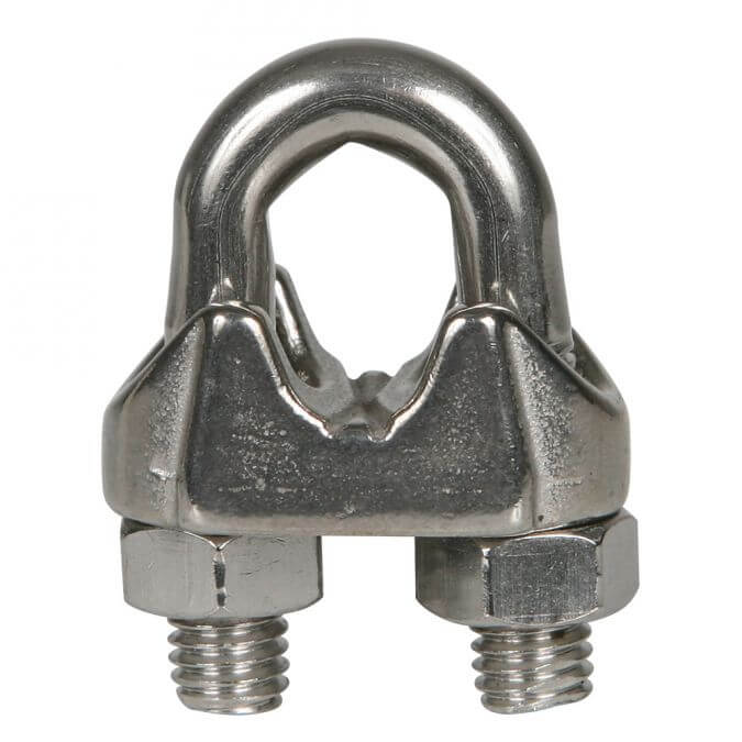

Smokey, you idea of a wire clamp on the cable, and then a tie off to th boom will be a simple fix til you decide what to do.
Something like this, perhaps a pair might hold the boom in place. Attach a soft shackle through the thimble to the boom and you could attach when the main is furled / release when the sail is hoisted.
Or a couple clamps like this might provide a more secure holed while you await the final decisions.
But they look clunky and could damage the sail unless careful
