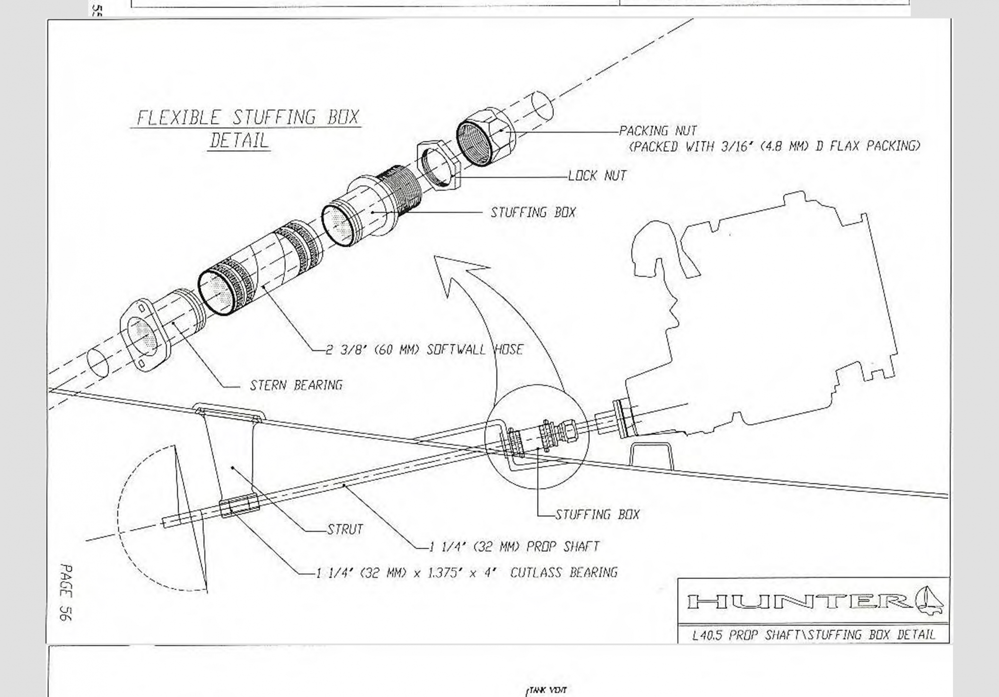

I need to order a PSS dripless shaft seal maintenance kit for my 1994 Hunter 40.5 but I'm not at the boat right now.
I know the shaft diameter is 1 1/4 inches but I don't know the stern tube diameter which is needed to order the correct kit. If you happen to know this or can measure or know the correct kit to order I'd greatly appreciate it.

He needs the shaft tube outer diameter....I think.
Oct 26, 2010
2,234
Hunter 40.5 Beaufort, SC
Dan,
I am at my boat now. Exactly what measurement do you need?
I need the outer diameter of the shaft stern tube. It is the part that where the shaft goes through the hull and where the aft end of the PSS bellows fits over and is secured with two clamps. For some reason I don't have you cell number in my phone any more. If you have my number give me a call or you can just post on here and I'll get it that way or by an email.
