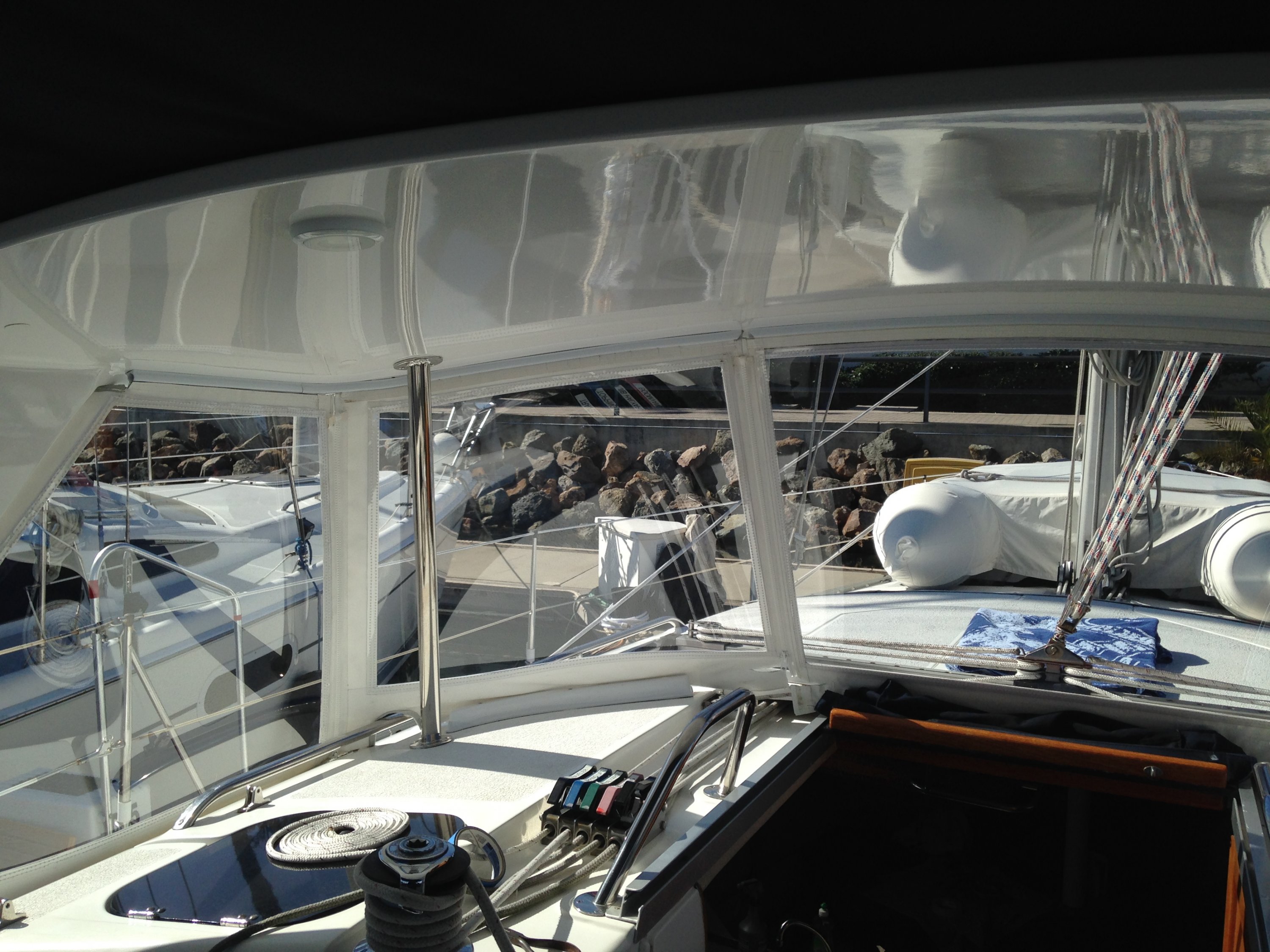

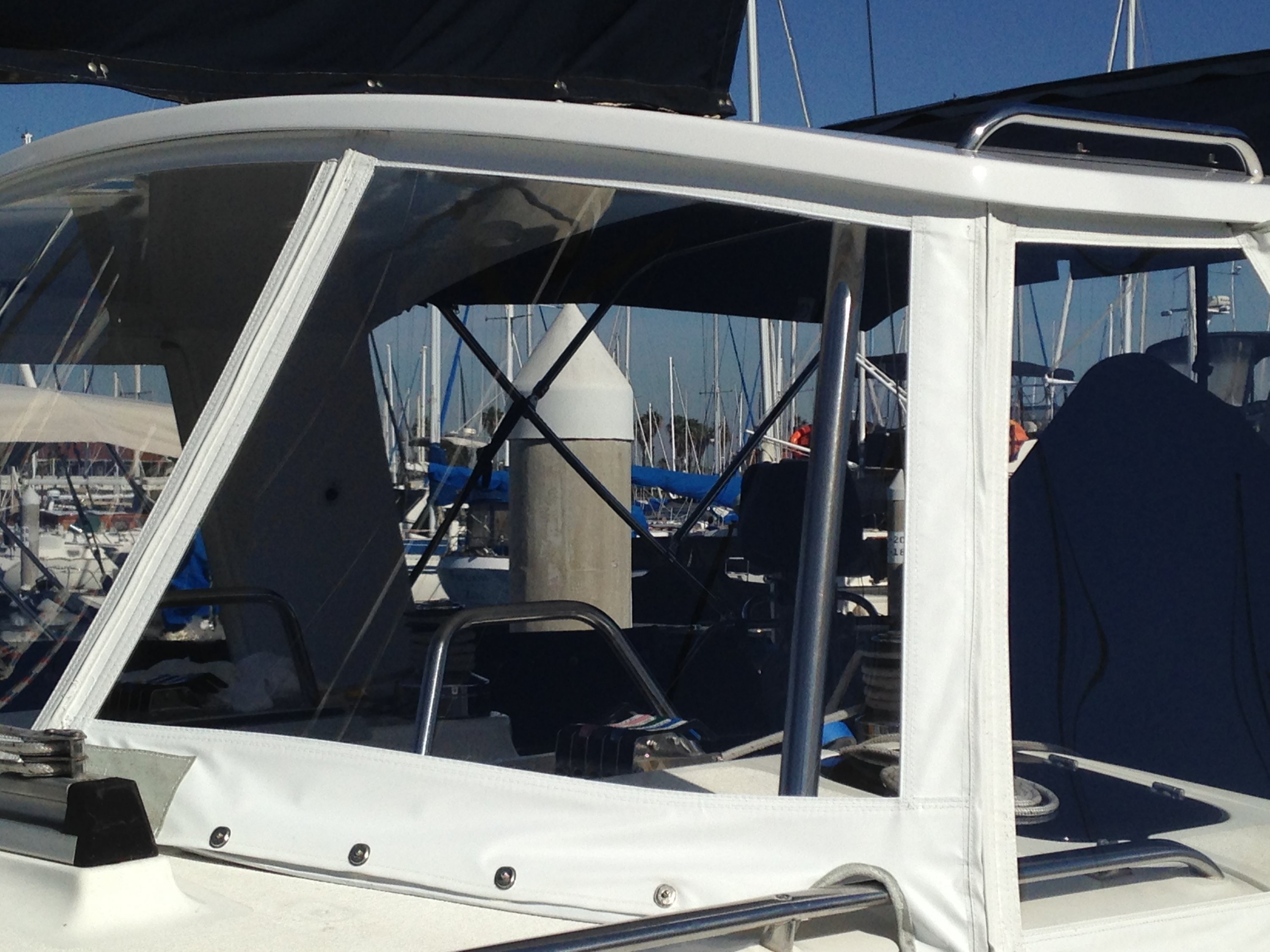

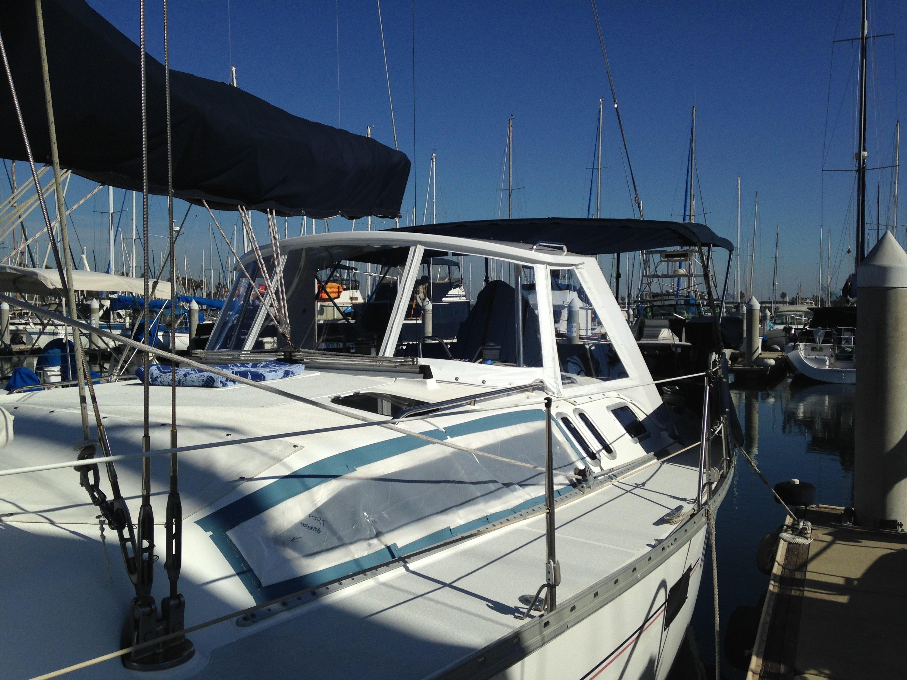

For any of you interested in hard dodgers, here are some photos of one I just completed for my 40.5. I built this with the following:
- Divinycell foam core
- 1208 biaxial and 1.5 oz mat, polyester resin
- White/red LED lights with dimmer
- Stamoid canvas sides with Makrolon glass.

Looks great @Frank P a project which is on my list as ....... some day. How did you support the aft section of the hard top? I see the forward support posts.

The aft support and top are one integral piece (Divinycell/glass). I was originally only going to make the top similar to the Catalina hardtop with an all stainless support however I was getting quotes from $2,800 to $3,000! One of these quotes was from the company that make the supports for Catalina. I think I paid under $300 for the two individual supports and that was with me mocking them up to get the angles so the fabricator would not need to come to the boat.
I have not added all the cost for making this, I don't think I want to....I made everything except the stainless supports

Nice.... it appears to be supported with single poles on each side, like a "T-top" with canvas side curtains. Looks like it will do the job.... and it's pretty.

I'm not sure, my son and I easily carried from the trailer to the boat at the slip. He and I got it from the dock to deck of the boat without too much hassle. I would WAG 80 lbs max

@Frank P - why did you use the stainless for the front supports and not fiberglass like the rear? The quality of the work is so clean, I was thinking the front was fiberglass, until I saw the other photos.

I didn't want the view obstruction of the mullions as they would have been fairly large to get the strength and stiffness needed for front supports.

Hope you can add some detail. What thickness or gauge is the Makron and was it sewn of the sailrite.
