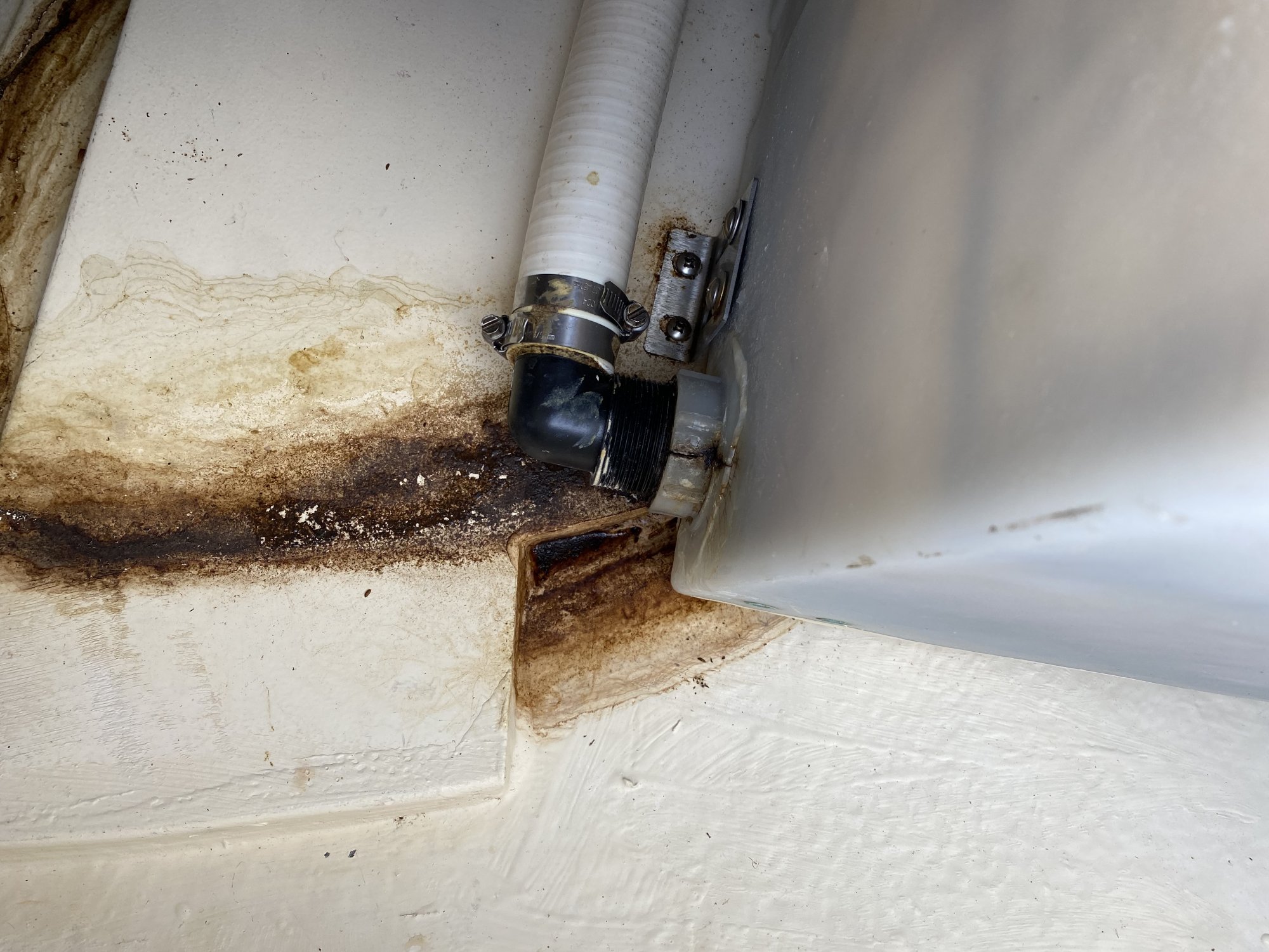

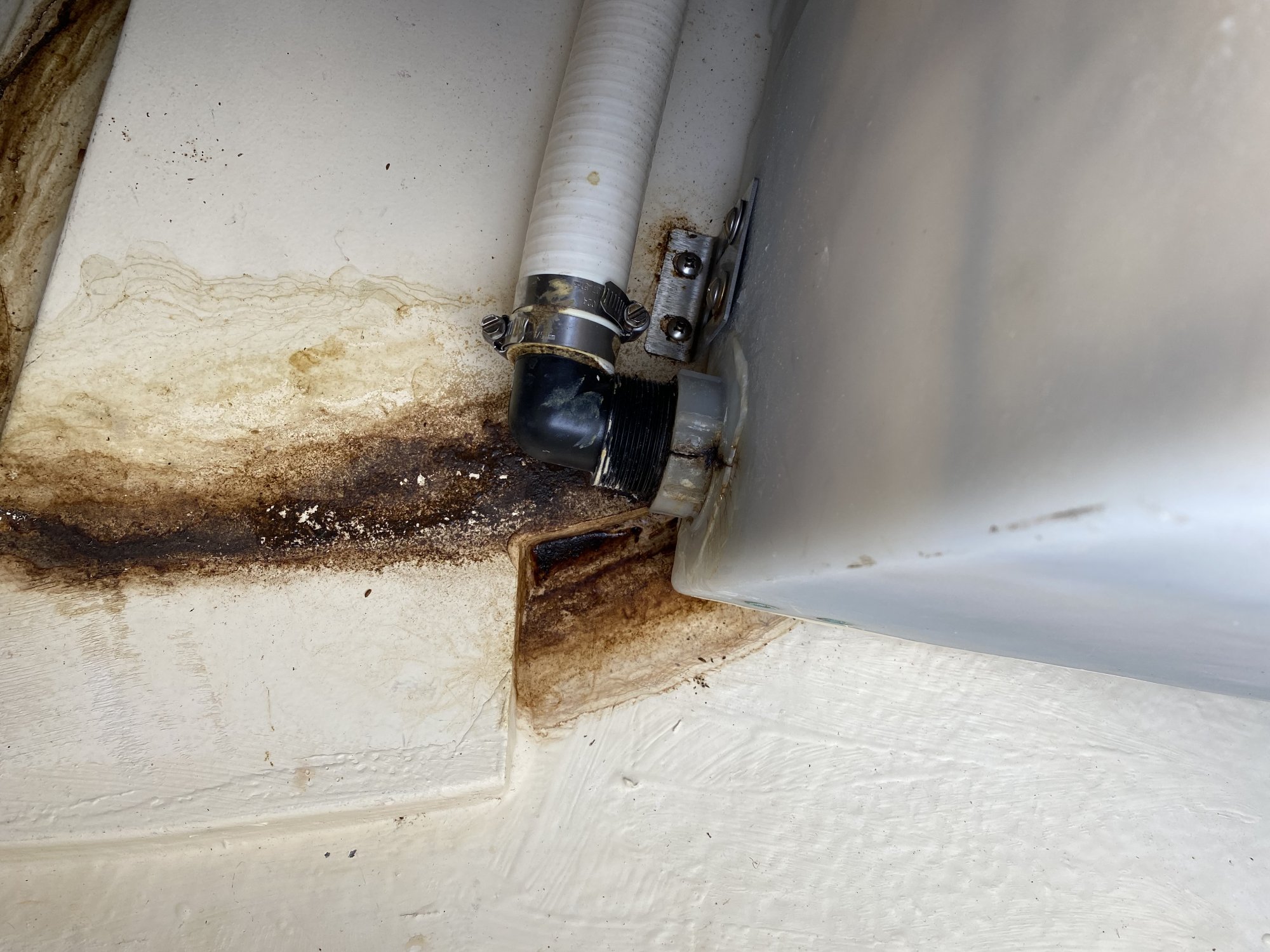

we have a 2008 36, pretty close in design of the stern. waste tank was installed before deck went on, not possible to remove thru existing hatches. We passed on the idea of surgery to the bulkhead in aft cabin to remove, and have found a solution to our leak at the macerator "out" fitting, which is cracked - Google Uniseals. Uniseal® Pipe-to-Tank Seal Black 3

here is what we were faced with - picture taken down through the starboard stern locker. Haven't completed, but removed macerator and associated lines, cut the fitting off flush with tank, drilled out the hole to 3". Uniseal will go around a short length of PVC pipe with a cap on it. properly installed should apparently stand up to 65 PSI, which is far more than it will get.
