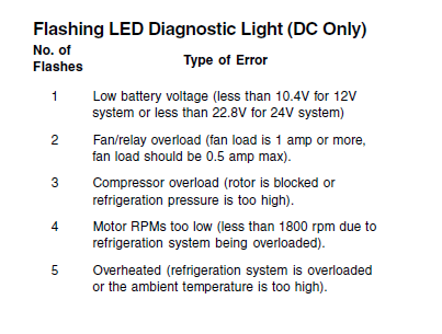

Did you by some strange chance find the manual?
Does your Hunter 380 have a Polarmate (Grunert/Dometic) system?
If so, did you check the diagnostic lights pattern:
http://www.tropicalmarineairconditioning.com/sheets/L-2058.pdf
See page 12 - 13
Also look at checklist of what starts before the "breaker blows" (as Capta asked above)

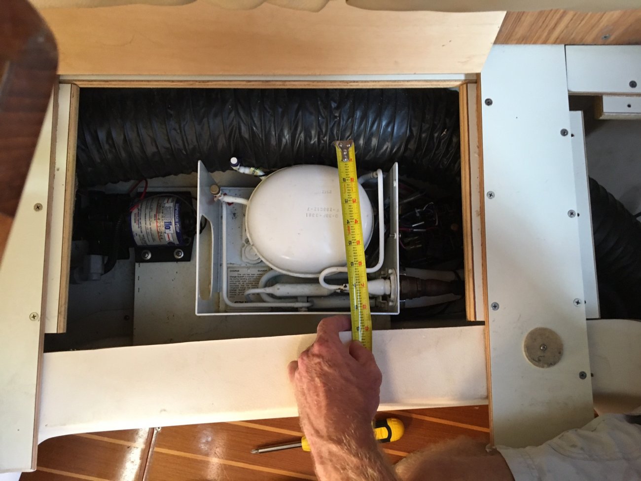

Here is a pic of the compressor and the only info I have on the system
May 17, 2014
136
hunter 380 Plano, TX
From what I can gather this is an Adler- Barbour unit and the icing at the connections is common and fixed with insulation. I'm going to try the "handy helper" (2x4). If it still pops instantly, I think my next step will be to pull the junction box. Maybe something is going on there if ice melt got to it. You can see it next to lines on the right (terrible location for access and I will probably splice some wires and move it to the other side)
If that doesn't do it I guess my only option is to search for somebody here in Dallas that knows these systems and maybe I can mate up a newer high efficiency compressor to the existing evaporator, pull a vacuum and recharge.

OK!! found it! I'll post some pics for later queries. I was finally able to finagle and cut the wires going to the controller easy reconnect. the location was B---H!! I will be extending the wiring to another location which will allow quick access. The controller board is toast, discolored and you can see tackiness on components. Looking now to be able to ohm out the compressor (4 Pin). its a Danfoss controller so no biggy getting replacement.,
