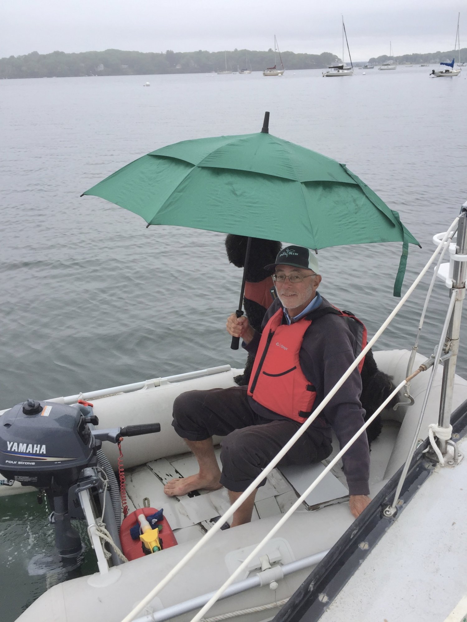

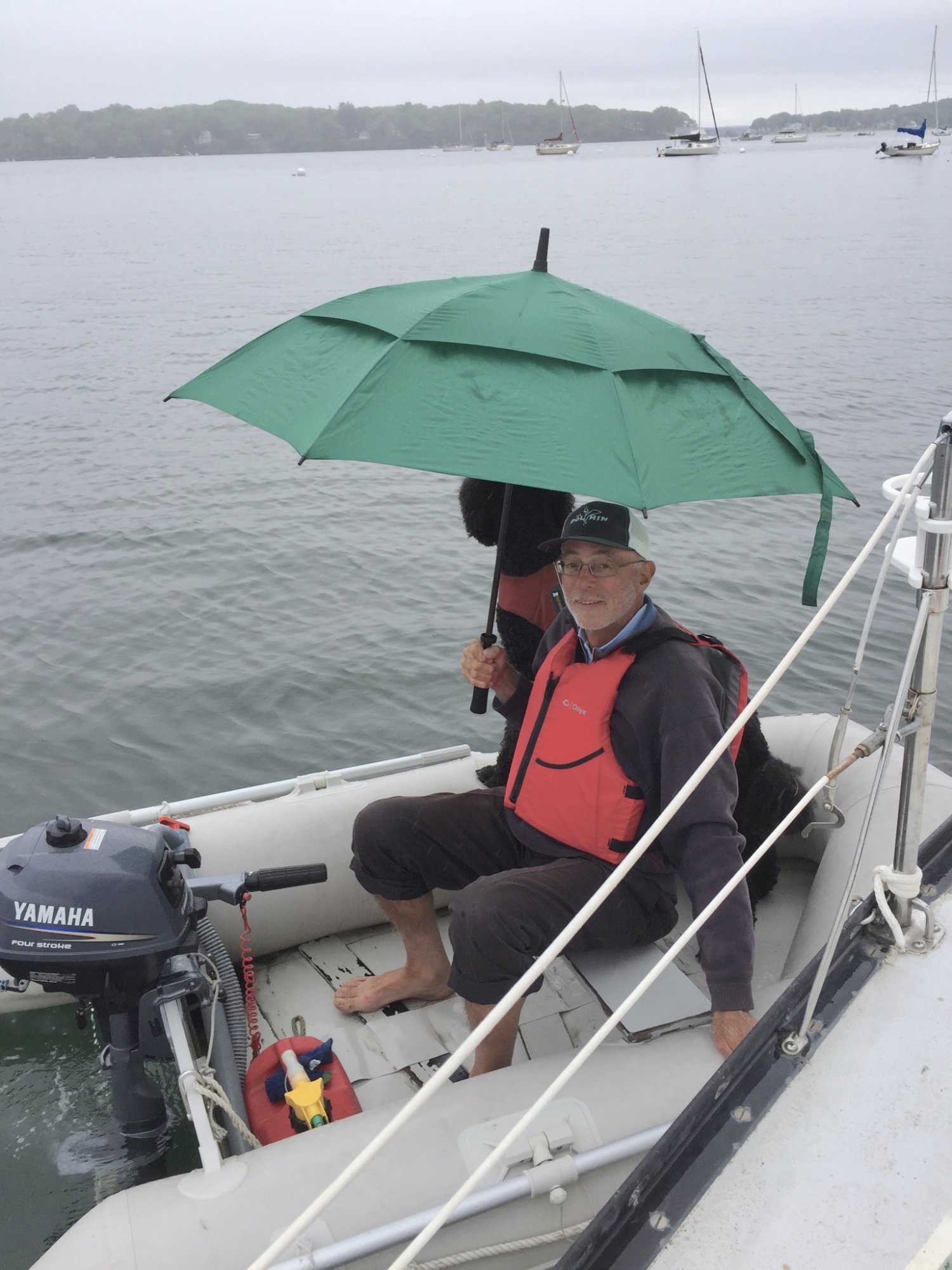

Tom, not World's End; it was Biddeford Pool, Maine. Taking my dog to visit a tree on one of the nearby islands in the rain. That roll up inflatable gets crowded when my wife and the dog and I go ashore, but we manage. I used to haul it up onto the deck with a spare halyard when leaving the boat in our home marina for a week or more but now I just paint the bottom and leave it tucked between the bow and the dock in the water when in a marina. I tow it with the motor tilted up for years now without issues. When coming into a marina, I tie the dinghy to the starboard side stern cleat and pull the tow line up tight so that the bow of the dinghy is about two feet behind my stern. I nearly always tie up on the port side and I can reverse if I have to with dinghy so tied. It just flops around and I ignore it. If it is really a tight fit at a marina I tie it to the starboard mid ship cleat before attempting to dock. You must never tow the dinghy to your stern with a long lead and attempt to back up because you will end up with the dinghy tow line wrapped around your prop. A longer inflatable would not be as manageable when towed and docking but would be more comfortable to use. I have never had the 2.5 HP outboard at full throttle so that is adequate for us.
