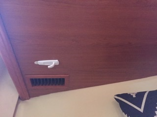

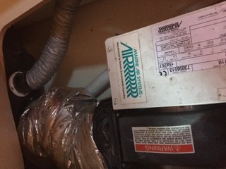

in the aft cabin the unit is located under the berth towards the port side. Just to port of the fuel tank. The air return in just under the bed. The ducts for air go port and starboard and come out in the side of the hanging lockers facing aft. The backs of the hanging lockers come out by screws and there is space behind the panel for the ducts. My aft unit also has a small duct that comes out in the head under the sink.
The forward unit is located under the forward part of the settee by the table. The air return is In the front of the seat. The air ducting goes in a number of directions. The first goes forward to the forward cabin. It comes out above the hanging locker on the starboard side. The back of that locker is easily removed too.
For the main cabin there are two runs. One port and one starboard in the ceiling. There are several openings on each side so you can distribute and direct air throughout the cabin. Starboard side goes back to the galley. Port side back to the nav table.
one more thing. There is one water pump that supples both systems. The pump is located under the floor in the main cabin about mid cabin. It’s mounted high in the bilge. The intake through hull is located in the compartment with all the through hulls at the bottom of the steps. The output of pump is split with one going to the forward unit and discharging through a through hull located on the starboard side above the water line. The other goes aft to the rear unit. It discharges on the starboard side far aft via a through hull located in the stern locker.

Thanks so much for the detailed reply I have found the wiring for the a/c in the saloon the aft cabin is not wired but I’m not to concerned about that .i have everything figured out except the ducting . Any chance you Have any photos of where the ductiong goes after the unit and a picture of where the vent is in the ceiling to blow air

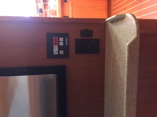

oh something else. The controller / thermostat in the main cabin is mounted next to the hull facing forward just in front to the nav table.
the one in the aft cabin is just above the little counter that is part of the rear engine cover. I would not put it there. The heat of the engine block really messes up its reading. It can take hours of running until the block cools down and let’s the thermostat show lower temperature. I’d mount it somewhere not so close the the engine.

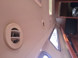

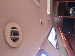

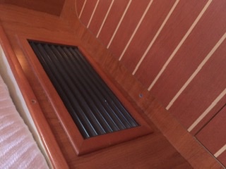

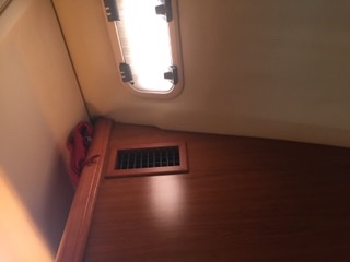

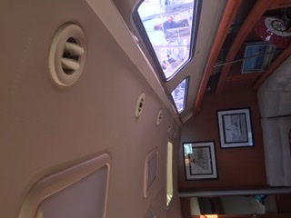

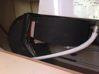

Apr 11, 2010
995
Hunter 38 Whitehall MI
What do you know. I got them to upload. The first 5 are in the aft cabin. The rest are in the main cabin
Not the most descriptive but I hope they help

Thanks so much for the pictures they are a great help . I found the ducting is indeed in my boat also. Just need to figure out how to get the vents in the main cabin now
