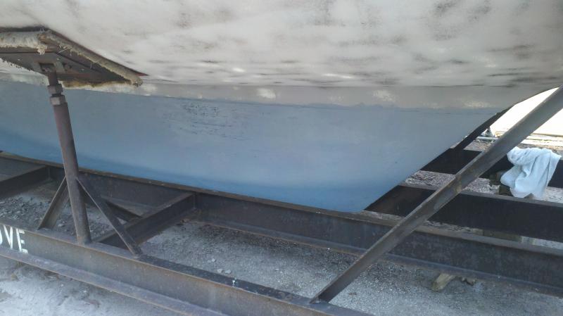

I have always felt that the rudder and stock with bearing is the weakest point of the boat. The upper bearing is supported by a weak plywood. My boat uses a 2x4 to support the lower shelf and is the rudder stop. Later boats used angle iron. In the picture you can see where a friend has tried to strengthen the upper shelf, the threaded rod. He also put the bearing surface under the shelf because his rudder floats. If it floats then it will rub on the hull. Ideally there would be a bearing top and bottom on that shelf. In another picture you can see spider cracks due to rudder grounding. That's on my boat. So before I worried about a tiller I would strengthen that entire area.
