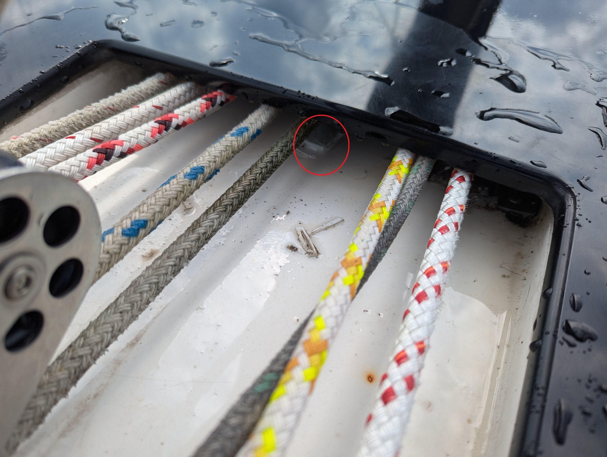

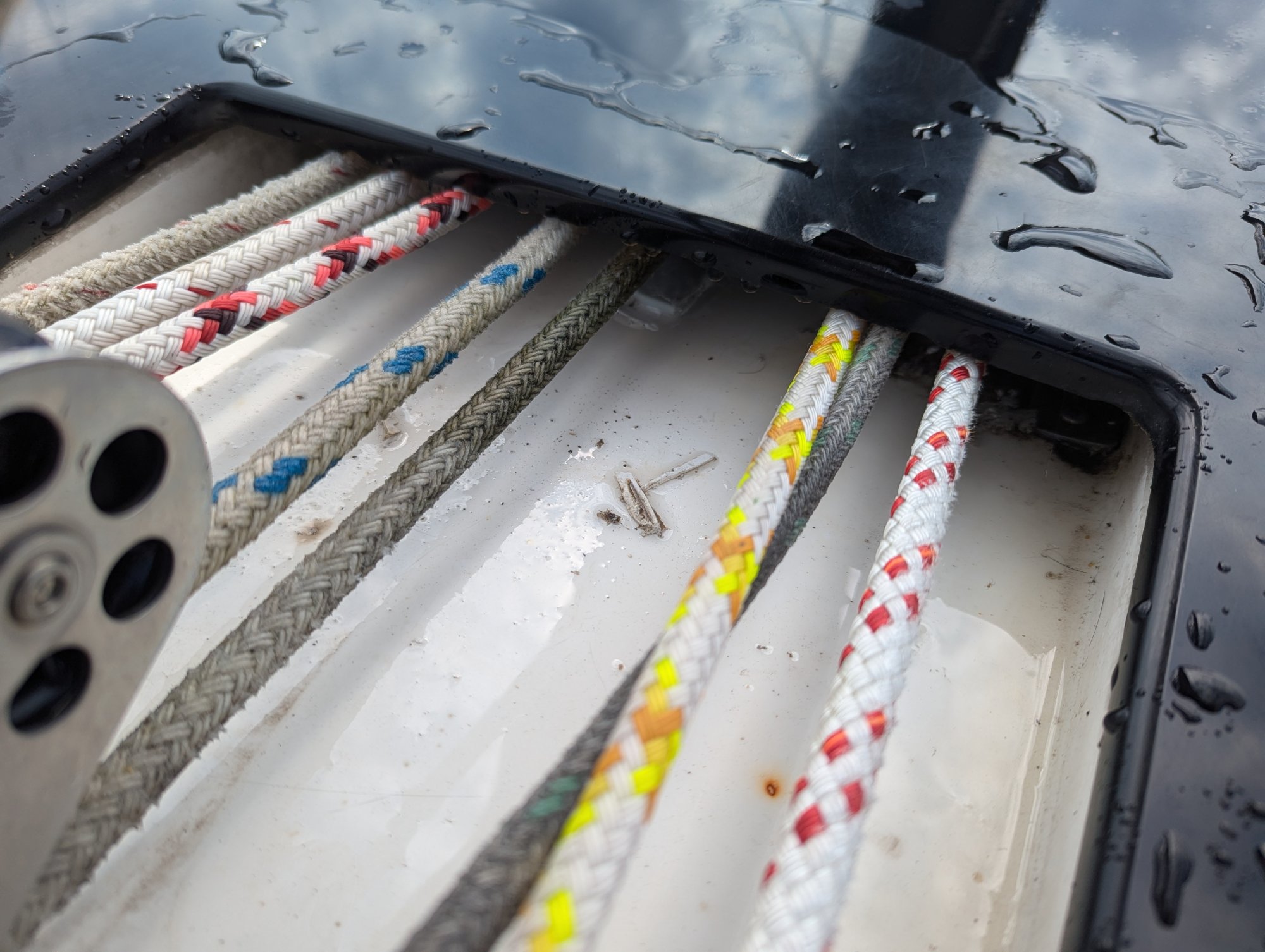

It appears that Hunter added three metal brackets, presumably to support the windshield section in the area where the lines run through. Each bracket appears to be held in place by two screws. On my boat I found that two of the three brackets were missing. Three out of the four screws that would have held those brackets in place were missing, just leaving holes in the fiberglass (I'm assuming that at some point in the boats 28 year history a line or lines got snagged or caught on the brackets and ripped them out).
The brackets are 1-3 inches back from the lip of the glass. The area is tight and hard to reach with my fingers, and would have been hard to get any type of sealant or epoxy into the space. The space is tight enough that the picture here is the best I can get. I removed the one remaining screw (it was loose) and cut a thin plastic scraper into strips that were long enough to cover both holes for each section. I then slathered the bottom of the scraper pieces with 3M 4000 and slid them into place.
You can see the edge of one of the scraper pieces under one of the lines (red circle).

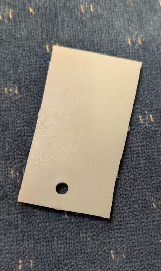

Here's the final piece of scraper after cutting it (for reference):
