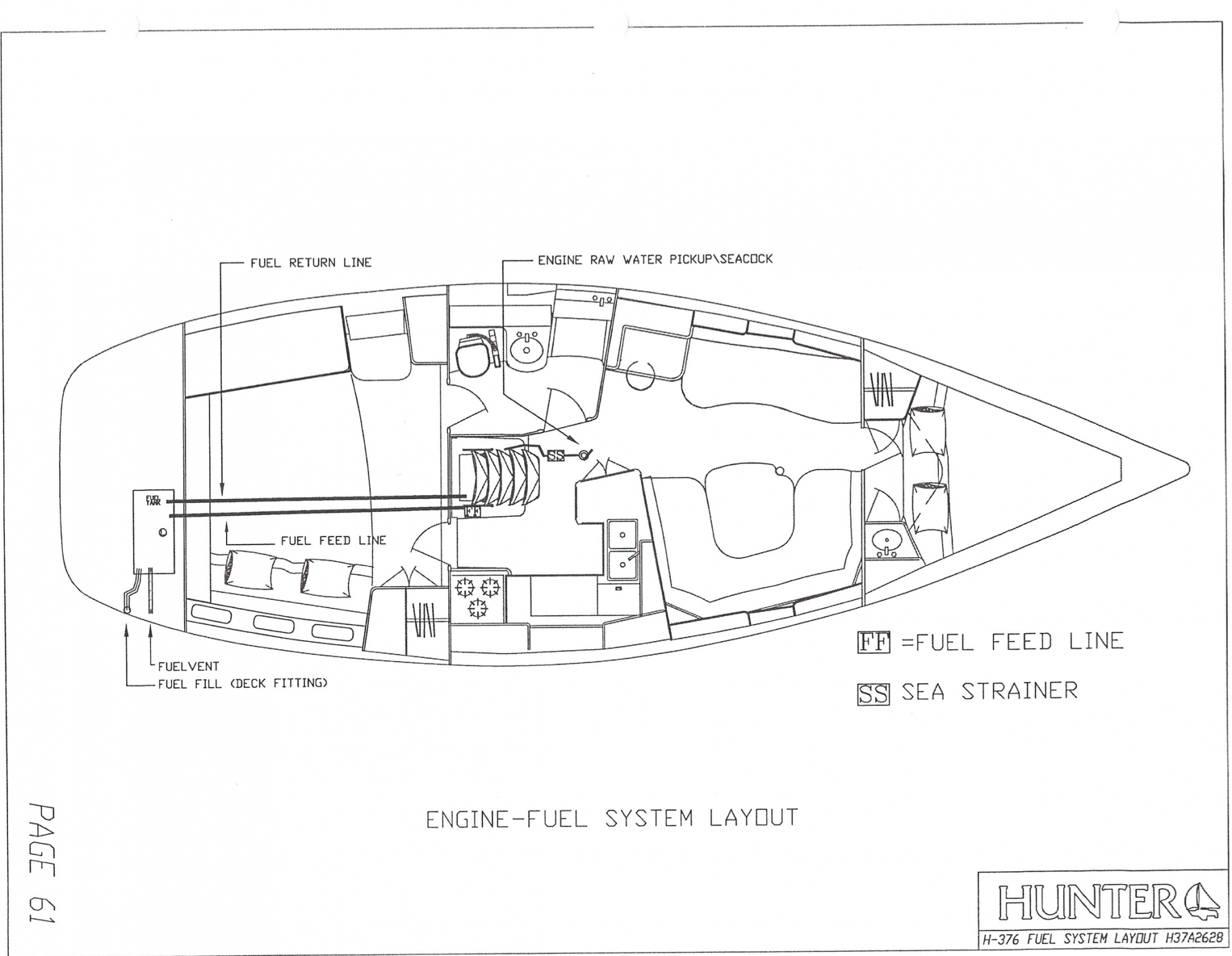

ok here is what I found.

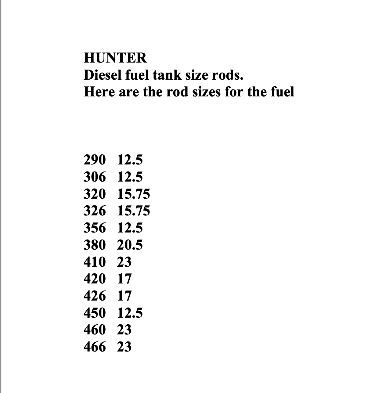

and this too.
Jim...
PS: Check the return line for best sizing
