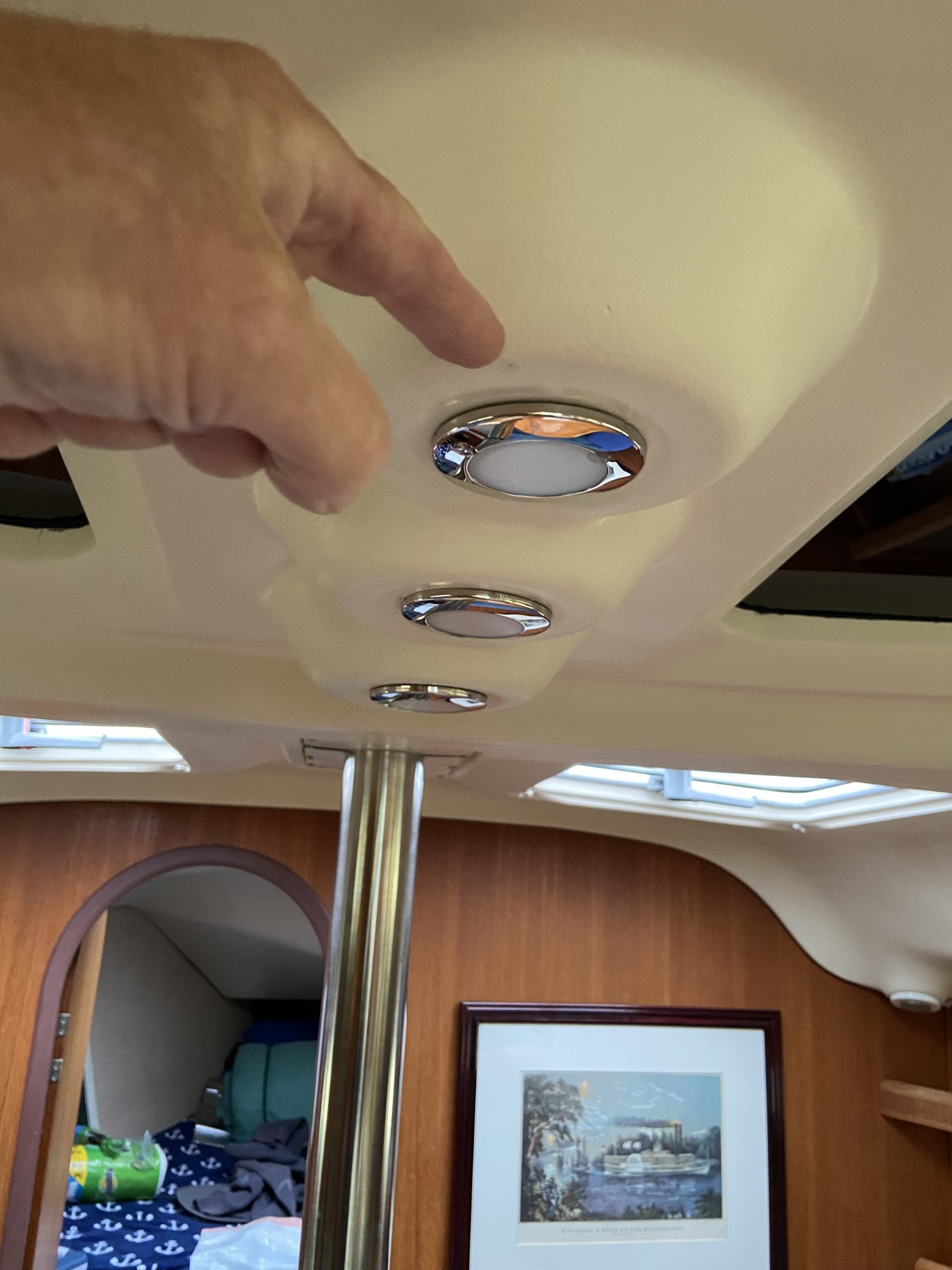

Hello Hunter friends,
I have had my 376 for 3 sessions now. I have made several improvements and we love the boat. I do have a nemesis however. When ever it rains out my 3 lights in the salon leak. I have spent several hours bedding hardware and even watching the direction the water comes from. (Which is from the aft sides.) It is not wet around the mast. I have also pulled the windshield and re-bed the halyard roller bar. Any ideas or solutions would be greatly appreciated!

Those lights remind me of a blender with a removable blade on the bottom. The well will fill with water and come out the bottom. On a boat I was on the window wiper washing tube had become disconnected from the tube on the blade. We awoke to a big bulge in the headliner centered at the light. Removal of the light promptly put gallons of water on the salon sole. I know that story doesn't answer your problem but it keeps the thread from slipping away.
Assuming water doesn't run uphill, water's leaking in that well from somewhere higher. How about those skylights? The seal with the liner may be in tact but the one of the deck may not.
Search threads for a technique to find leaks. The short version is to seal the cabin with plastic, pressurize it, and paint soapy water around suspicious areas.

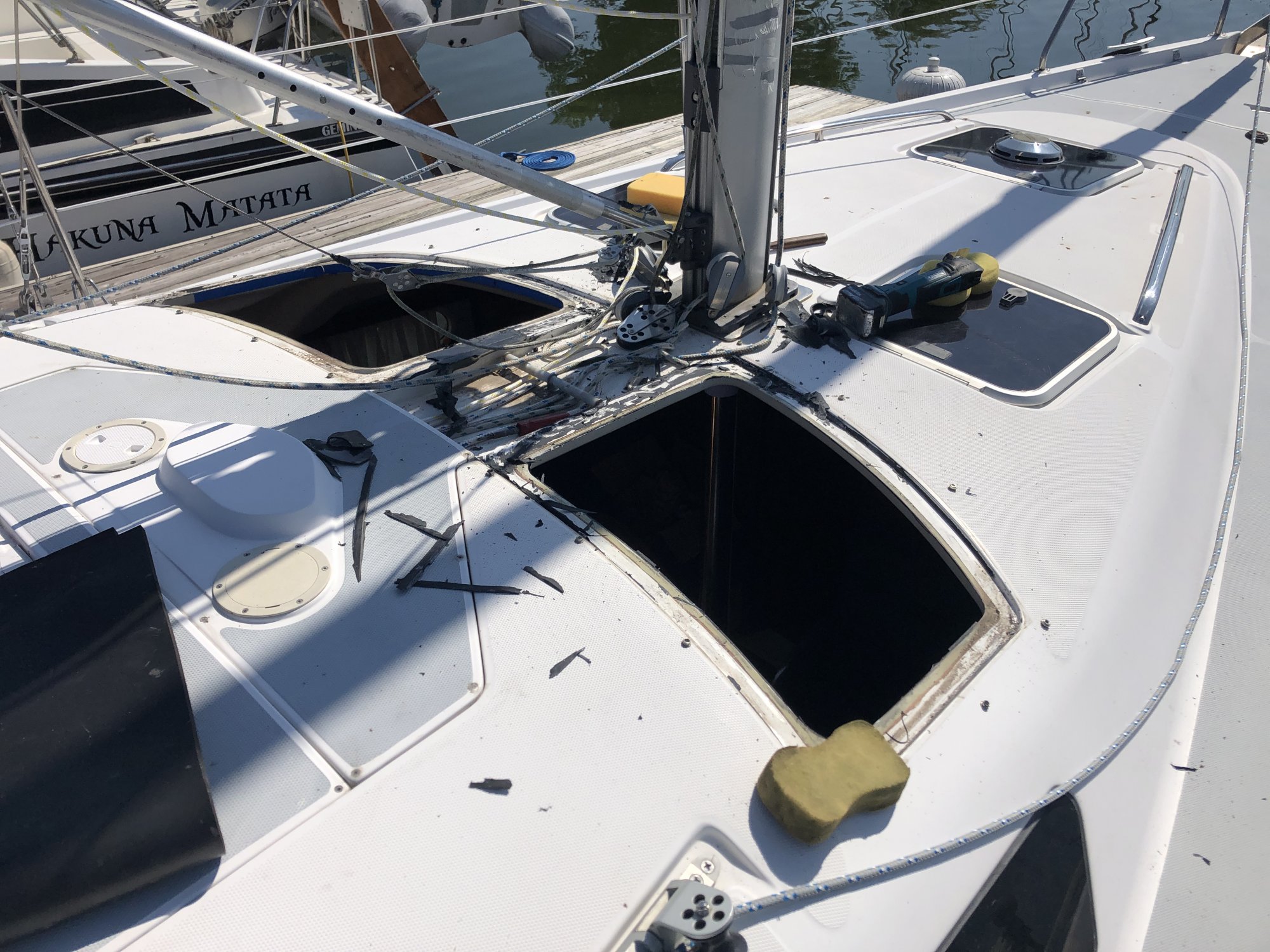

I am not sure what you mean about a cover over the halyard roller bar? My bar was cover by the windshield. I re bed the roller bar bracket screws when i removed the windshield. I would love to reseal those screws but it does not seem they are accessible without removing the windshield. And I am never doing that again!!! please look at attached picture and let me know what you think. Do you have a picture of the cover you sealed by chance?

Actually, I should have been more specific. It is the two panels aft of the windscreen. Take the panels off, dab the screw holes with caulk then replace the panels. The caulk will seal the screw holes as they are replaced. Fixed my leak problem.
Thanks and good luck.
