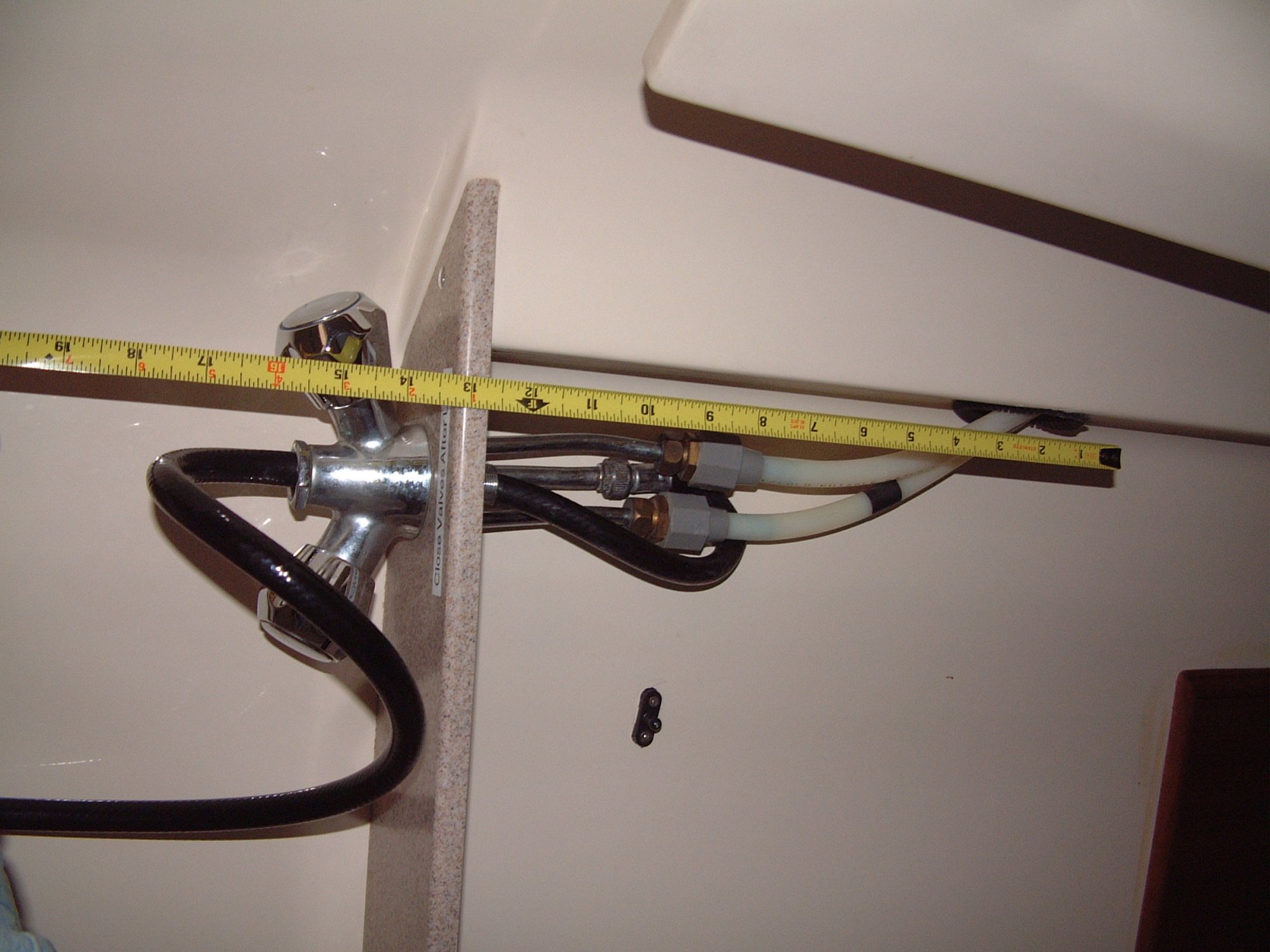

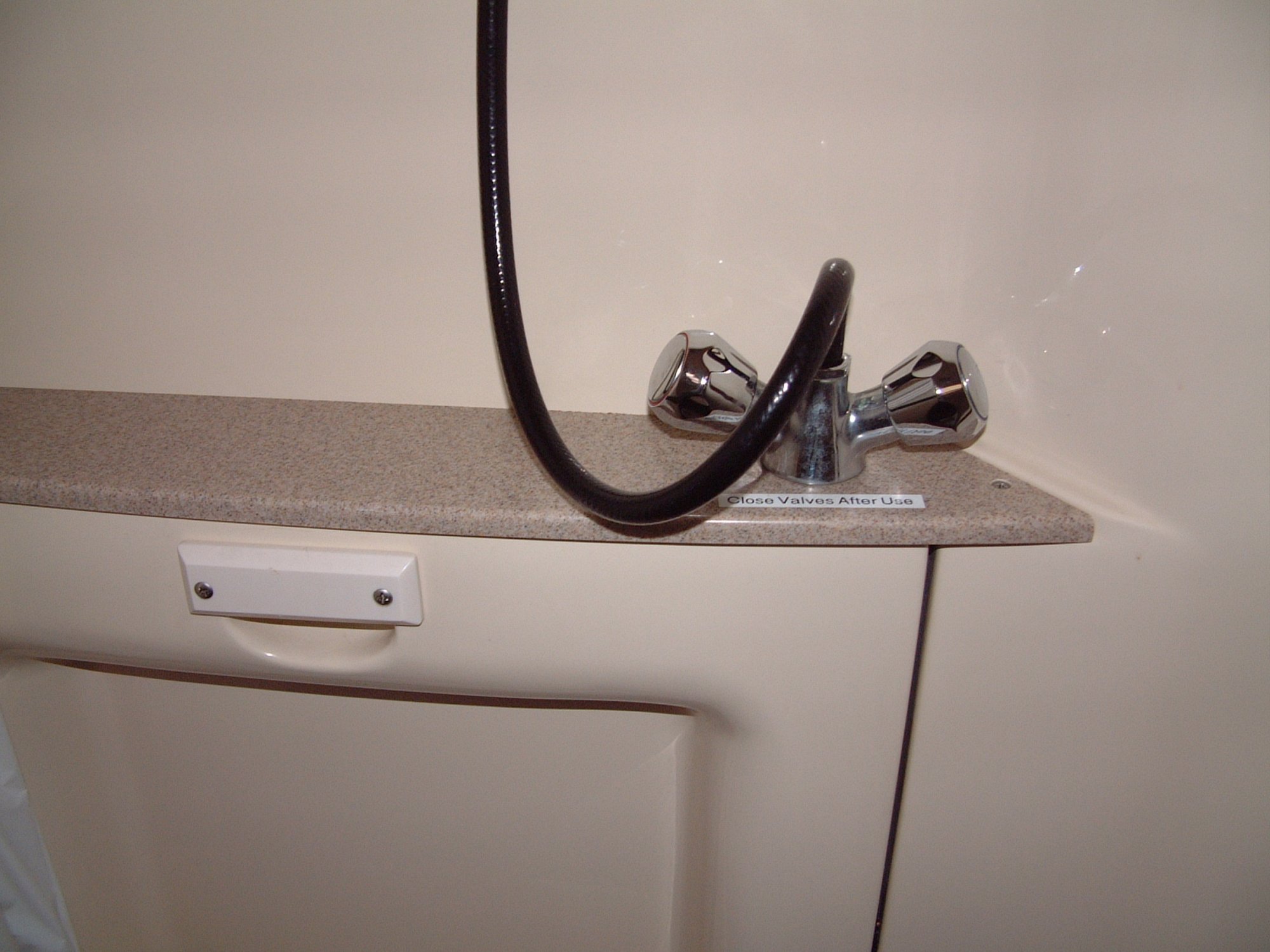

I have a1997 h40.5 which has a similar construction (I think). Attached are two pictures. Pulling straight out on the hand grip at the top of the fiberglass panel just under the faucet shelf will remove that panel. The access panel to the engine compartment can be seen easily. The edge of the panel appears in the second picture in the lower right corner (sideways pix).
