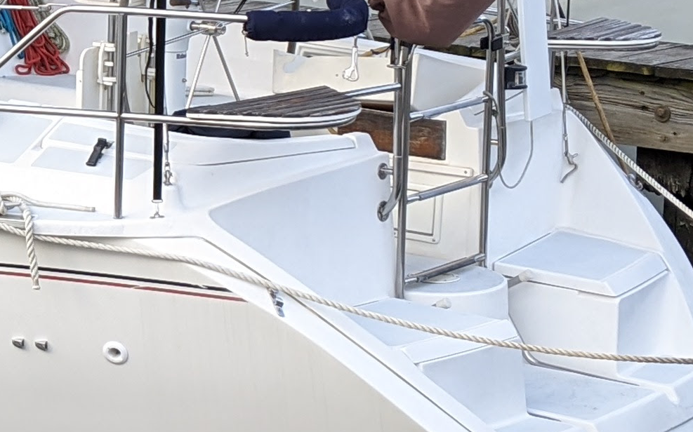

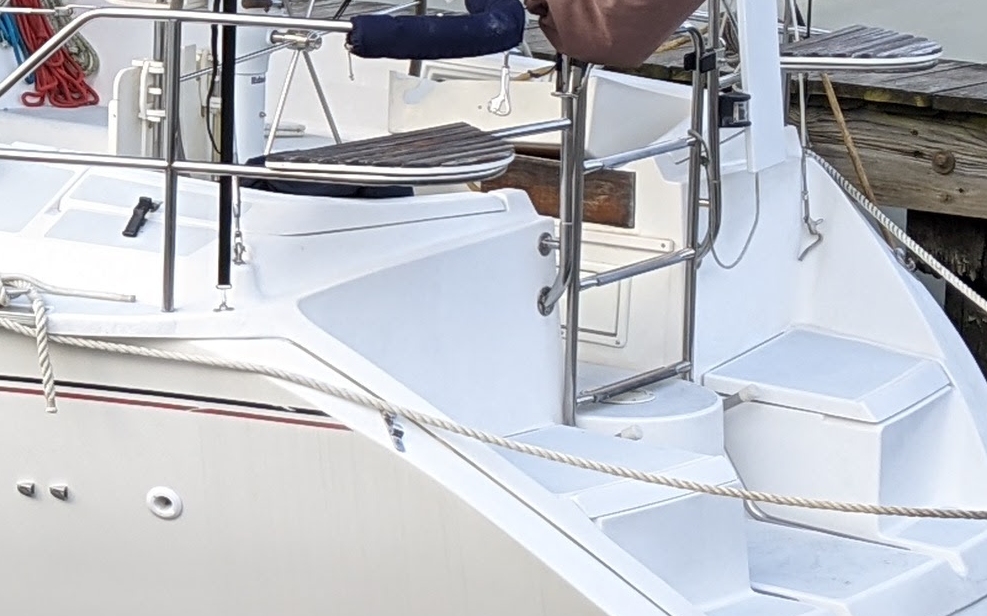

Searched extensively trying to find pictures of Scanstrut (or any other pole mount with self leveling top) installed on the stern of Hunter 37.5, but came up with nothing. If anyone has installed a pole on this specific model and can share a picture, that would be awesome!
(picture of the stern of my H37.5)

Appreciate your advise, I went over all of the self-leveling vs. non-self-leveling discussions, and I'm still open to both. My question here is not so much about what's at the top of the pole, but about the bottom... where exactly is it attached to the stern and what hardware is used if it's a DIY version.

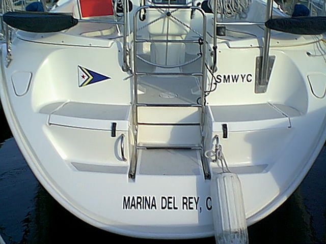

Installed 2 1/2 inch stern pole on my 37.5 on the lowest step of the starboard outboard swim platform. Works just fine.

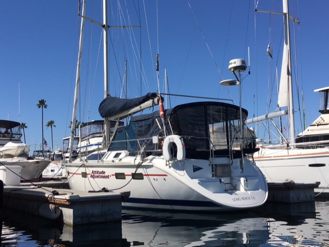

On my Vision 32, I mounted it about a foot up from the starboard hatch, using a 90 degree S/S mount backed by a S/S backing plate held in place for assembly by 5200. S/S fabrication from a machine shop and the pole was Garhauer. The pole on my 40.5 was there when I got it 21 years ago and I was told it was custom from Garhauer. It is backed by marine ply. It is S/S and in a nice piece although anodized aluminum might be better from a weight standpoint. Unfortunately, I have no digital photo of the Vision install.
