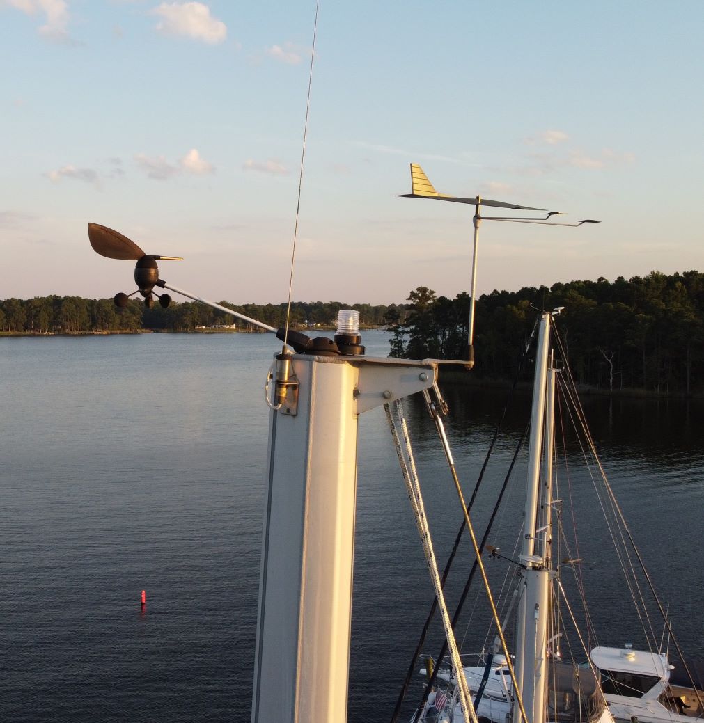

If your mast has a standard Isomat NG2 mast head Rig Rite has the dimensions for the mast head sheaves. NG2 Masthead Assembly
If your mast head looks like the one in the picture below, presumably a Hunter fabricated mast head, you're better off taking the mast down or finding a place that has a tall enough bucket lift to go up and remove the sheaves and measure what you have.
