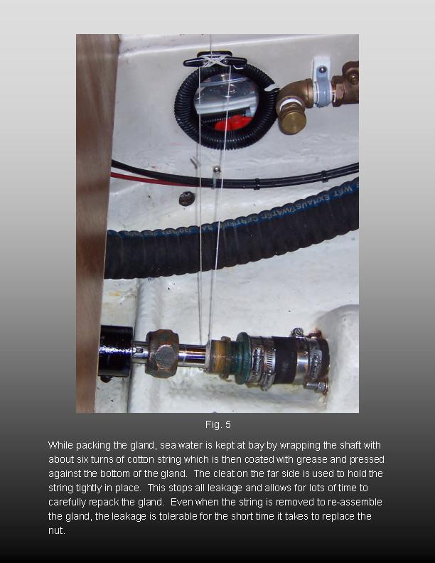

Hey,
Can anyone let me know if this shaft dripping rate (after running motor extensively) is OK?
More infromation: the next day (without running motor) there was no dripping at all.
Thank you and sorry if this question has already been asked, I could not find it on the forum.
