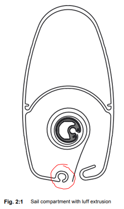

So I'll throw out an idea that isn't fully formed, and see whether it has any merit based on the experience of others. My previous H36, a newer sister to the H356 line, had the same Selden in-mast furling system. But interestingly it also had a mast slot to port of the large slot where the in-mast sail furled. I never paid much attention to it, but I vaguely recall reading somewhere that the slot was meant to take a mainsail with traditional slugs. Here's a cross section from overhead from the Selden manual with the track circled in red:
If that is indeed the purpose of the red circled area, could one remove the furling main used for cruising, and replace with a standard slugged main when you want to race? The more accessories you want to add (e.g. stack pack, etc.) will make such a conversion a lot more effort, but if you only race occasionally and want a slugged main perhaps you forego those other mods to make the temporary conversion quick and easy?
Page 45 in the Selden Sailmaker's Guide (595-542-E.pdf (seldenmast.com)) suggests that a Bainbridge slide (AO31? AO32? AO33?) could possibly be used in the luff groove, depending on the particular mast section.
Since the groove is supported on one side, I'm not certain how it would hold up to the stress produced with a full main sail. Is it possible the original intent of the groove was for a storm trysail? Contacting Selden might yield better insight.

My understanding was that that groove was for a storm trysail - so you could quickly set the storm sail without disrupting the IMF. The storm sail was designed with ties to go around the mast for extra support (and bright orange!)
