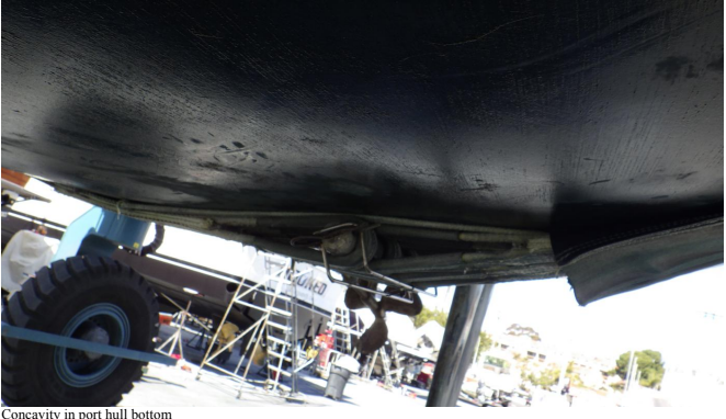

Hunter 356 hull deforms on travel lift

I don't know about the H356 but I do know about Hunters from 1980 to 2008 and have assisted in haulouts numerous times on H27, H36, H31, H37, H41's. Hunter hulls are NOT any thinner than typical production hulls IMO for any given year and at certain locations on a hull. I have witnessed straps being 2' from proper locations without any noticeable deformations. I know of NO Hunters that have balsa below the waterline unlike several supposedly premium production boats. It sounds like some 356's may have a issue and I would be surprised if A Hunter builder does not chime in here and say something. Maybe our Olson 34 owner has specific knowledge of the process Warren Luhrs used to build these boats.
