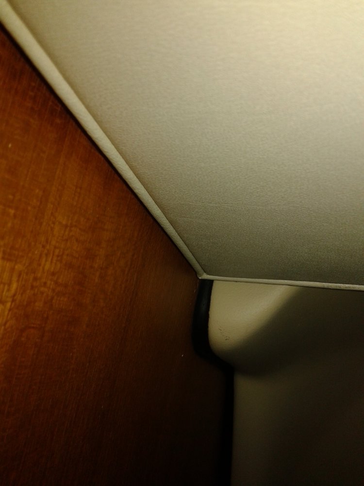

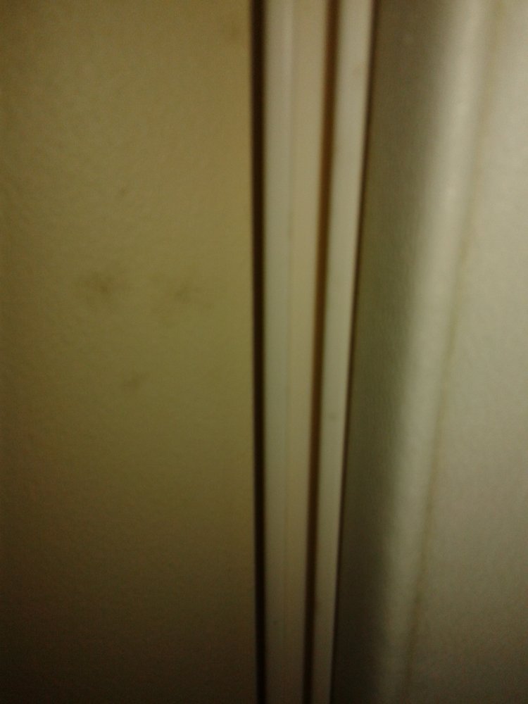

Has anyone successfully removed and reinstalled the vinyl headliner on a 2003 or 2004 Hunter 356? I need to replace the VHF cable that is above the headliner and would like to accomplish this without damaging the headliner. I have looked at the various threads on the Forum that explain a method using a putty knife to pry the vinyl loose from a groove, but the headliner on my boat does not have same configuration at the edges as is shown in the most detailed thread.

Aha. Thank you. It sounds like there are two steps -- opening up the moulding and then pulling the vinyl out. Is the putty knife with rounded edges used only for opening the moulding? In the earlier thread on this, it appeared the knife was used to open a c-shaped channel to release the vinyl. For opening the moulding, do you insert the knife along the outboard or inboard edge of the moulding?
Mar 20, 2004
1,753
insert the knife towards the outer edge to spread the channel, then pull the headliner carefully out. use the knife to push the headliner back in when you're done
Jun 21, 2016
27
Hunter 356 Annapolis, MD
the instructions in the original thread say to start at a corner. I cannot find a way to get knife under the edge of the headliner in these corners, where the channel holding the headliner is either not there or not visible.
Mar 20, 2004
1,753
yes - I sometimes use a small pair of needlenose pliers to start the headliner out
