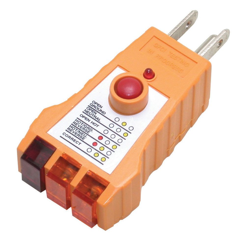

Get an outlet tester and test the outlet that you are connecting to. If that is good, then test the end of the extension cord before the pigtail that connected to your shore power connector. There may not be a reversed connection, but there could be an open or high resistance connection somewhere.
If you are the only one with this problem, then it is likely that the fault is with your extension cord or pigtail. Or you have picked the only bad outlet in the yard. Or you have a black cloud over your head.
