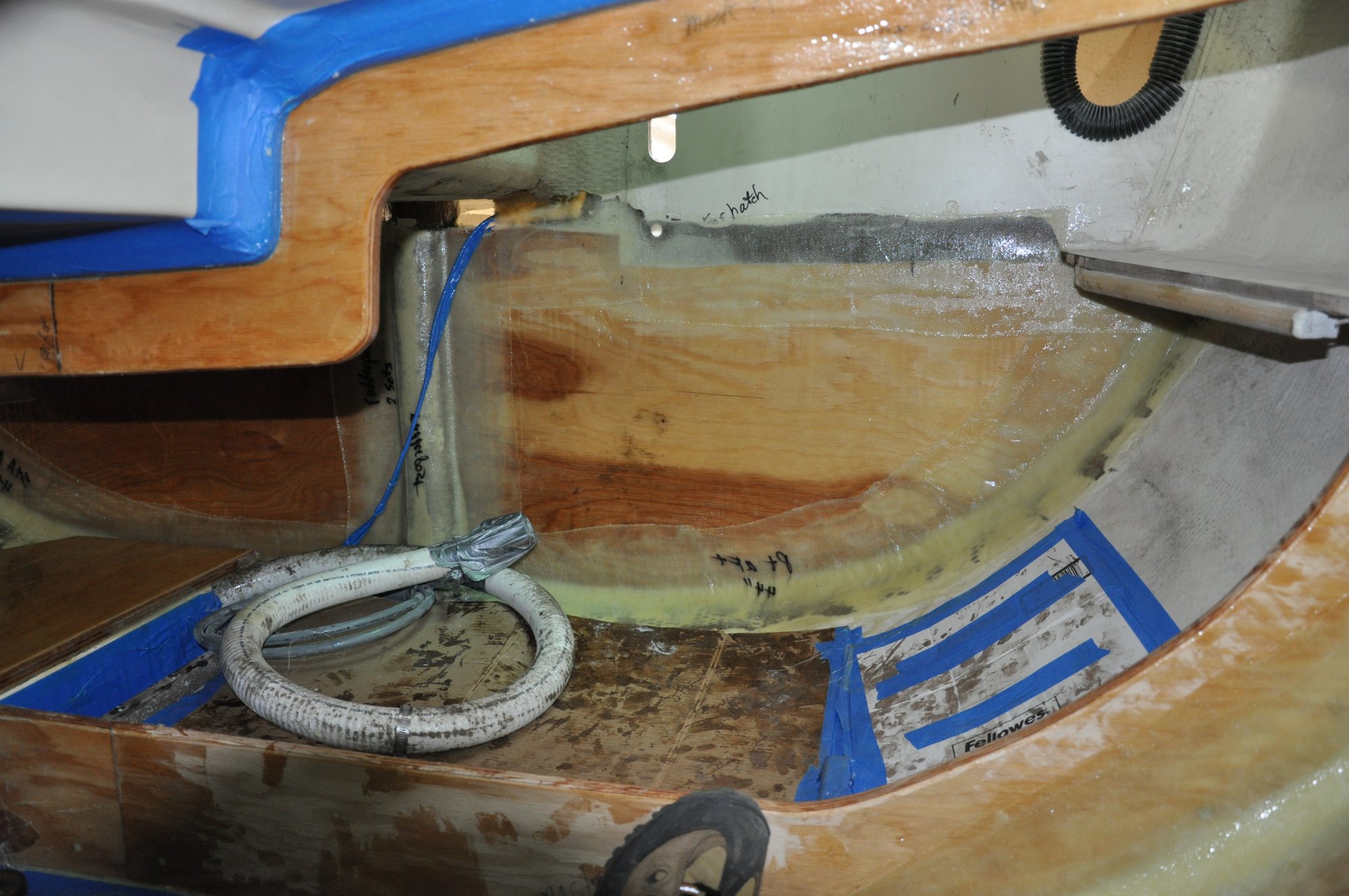

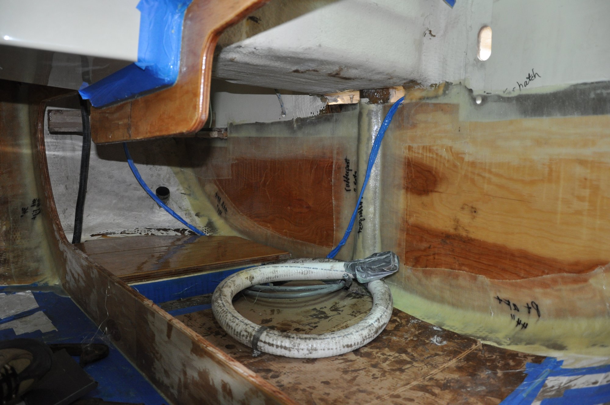

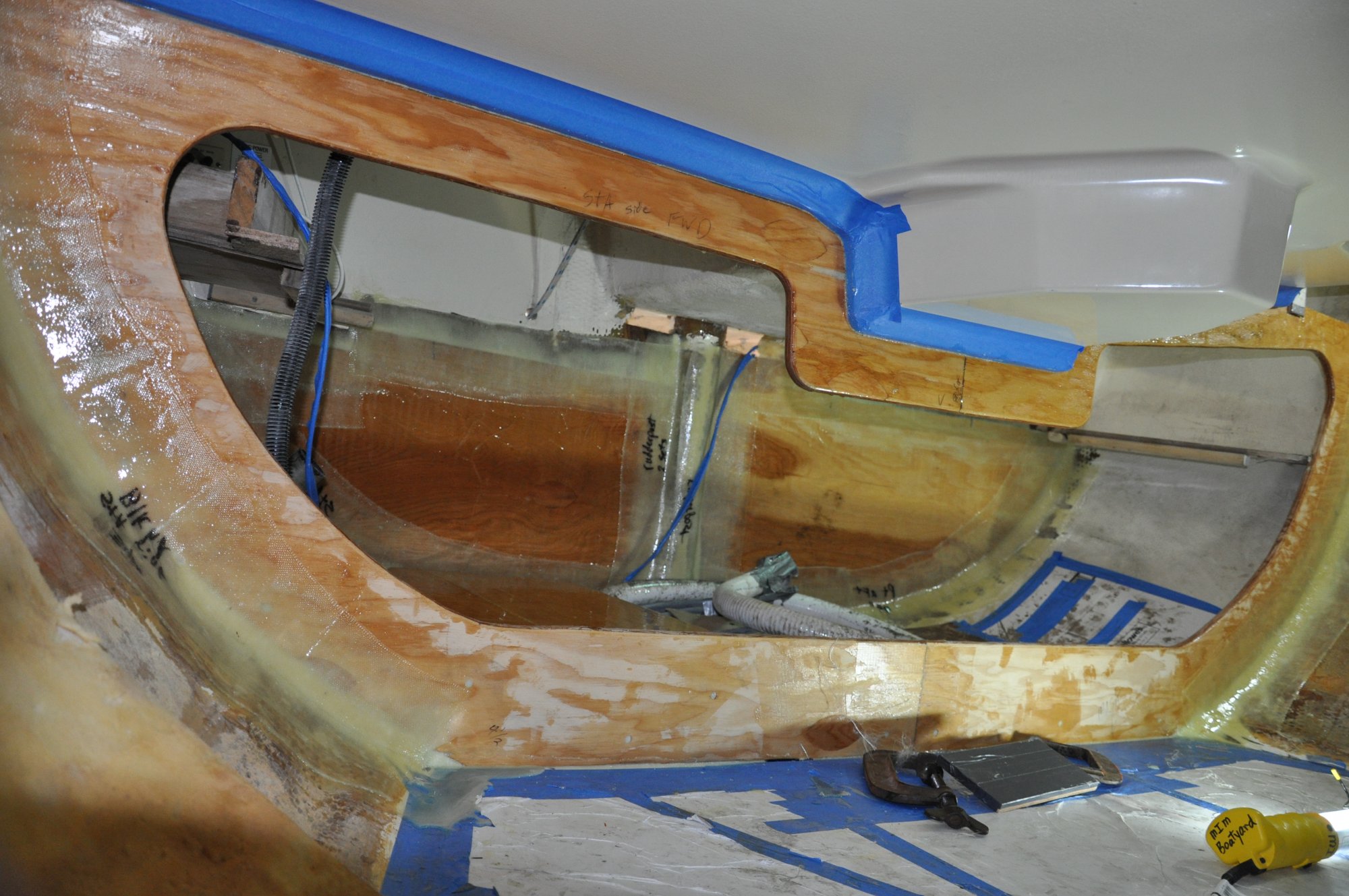

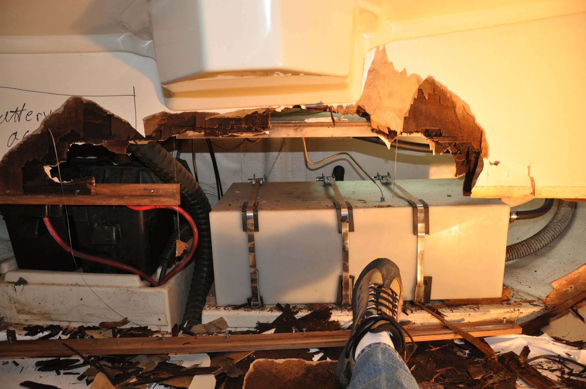

Hope these are of some assistance, they're from a rebuild of the aft cabin bulkhead on our 1992 - 35.5, both the stern lazerette and aft cabin bulkheads had to be replaced. I have more photos of the rebuild method I used as well.
Those are great if you have the finishing photos I would really appreciate seeing them

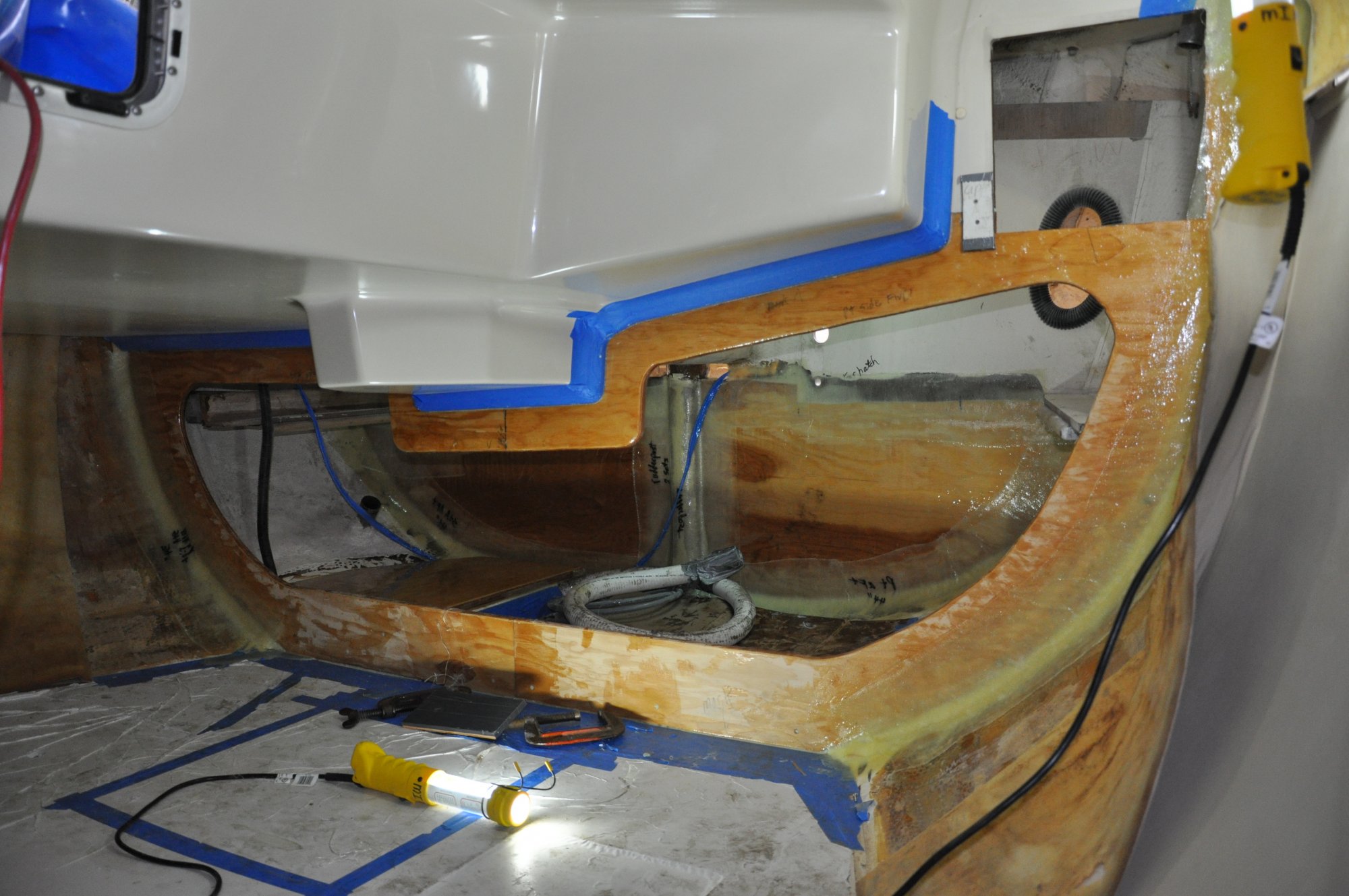

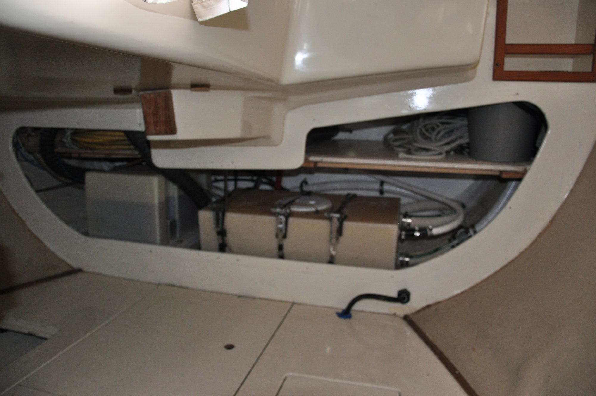

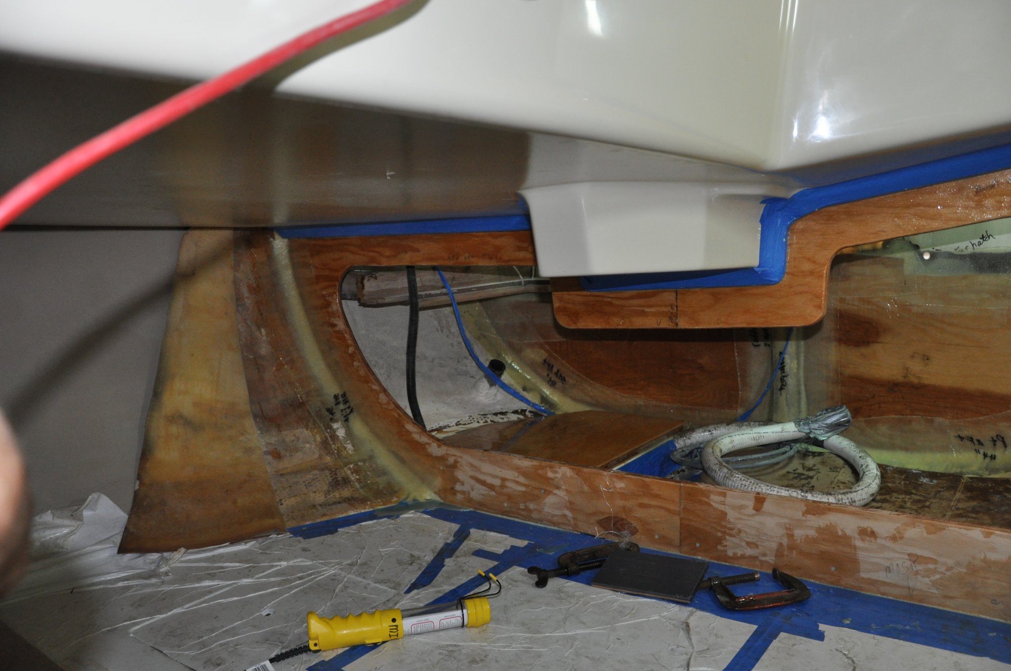

These are the pictures that I can find right at the moment, I'll look for the others. The actual bulkhead was made of 1/2" marine grade plywood, epoxied on all edges and glassed. It was fully removalable, attached to the flange you see with stainless machine screws that screwed into embedded rivet nuts. A rubber gasket sealed the bulkhead to the flange. I then had complete access to the tank etc. As to the holding tank it was removed, completely cleaned out and a whole cut in the top where a Beckson port was installed and sealed with 5200 for future complete cleanouts. Hoses were removed as well and replaced with non permeating variety.

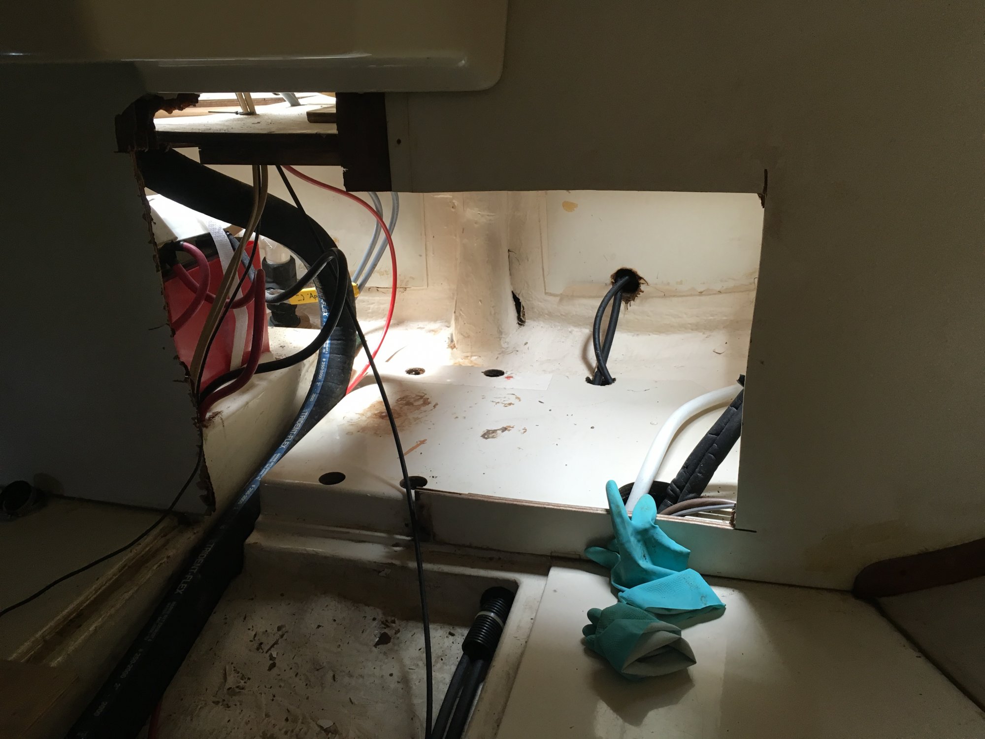

Here is a picture of the repairs cleaned up, including the Beckson Port cleanout in the blackwater holding tank but less the bulkhead. You can see where the bulkhead attaches to the new flange via the embedded rivet nuts.

BOSSailor, from the Hunter factory the bulkhead was certainly not an structural element but when I finished with it certainly was. Between the marine ply, epoxy, glass cloth and the tabbing it stiffened the stern of the boat and with the gasket and drains it will not rot out the stern again, it also allowed for better access to tankage, batteries, etc.

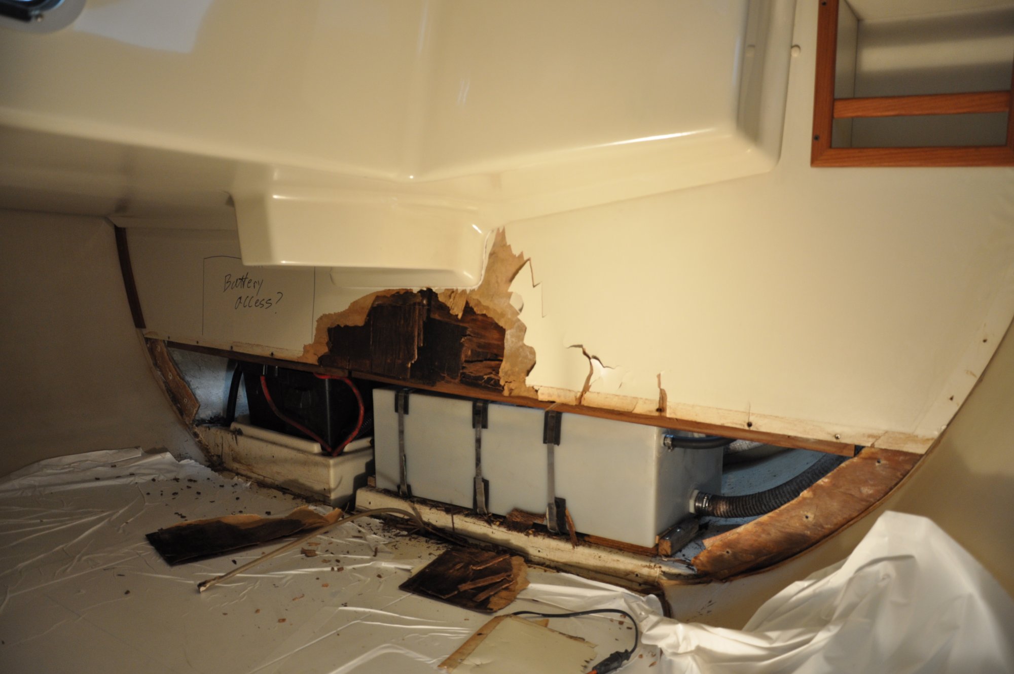

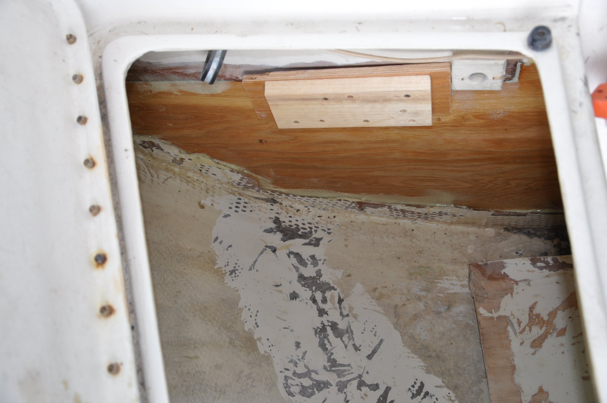

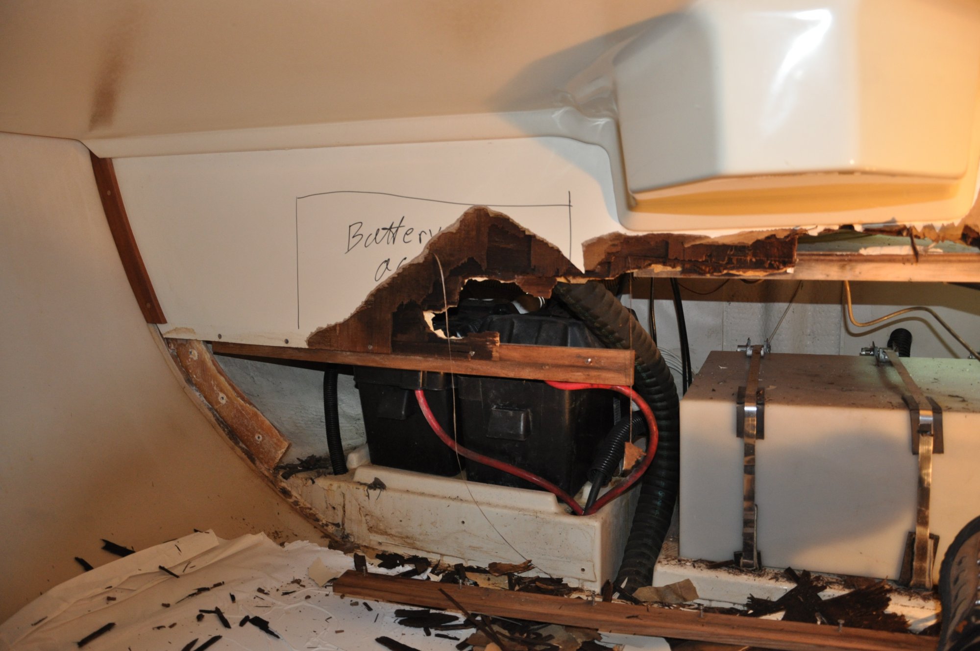

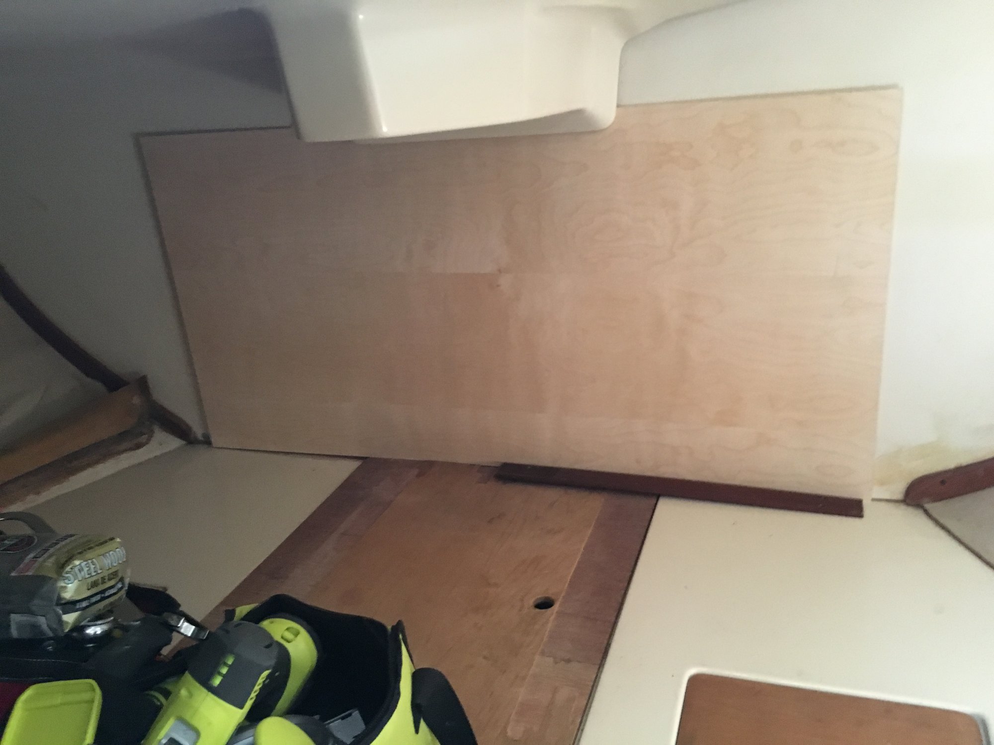

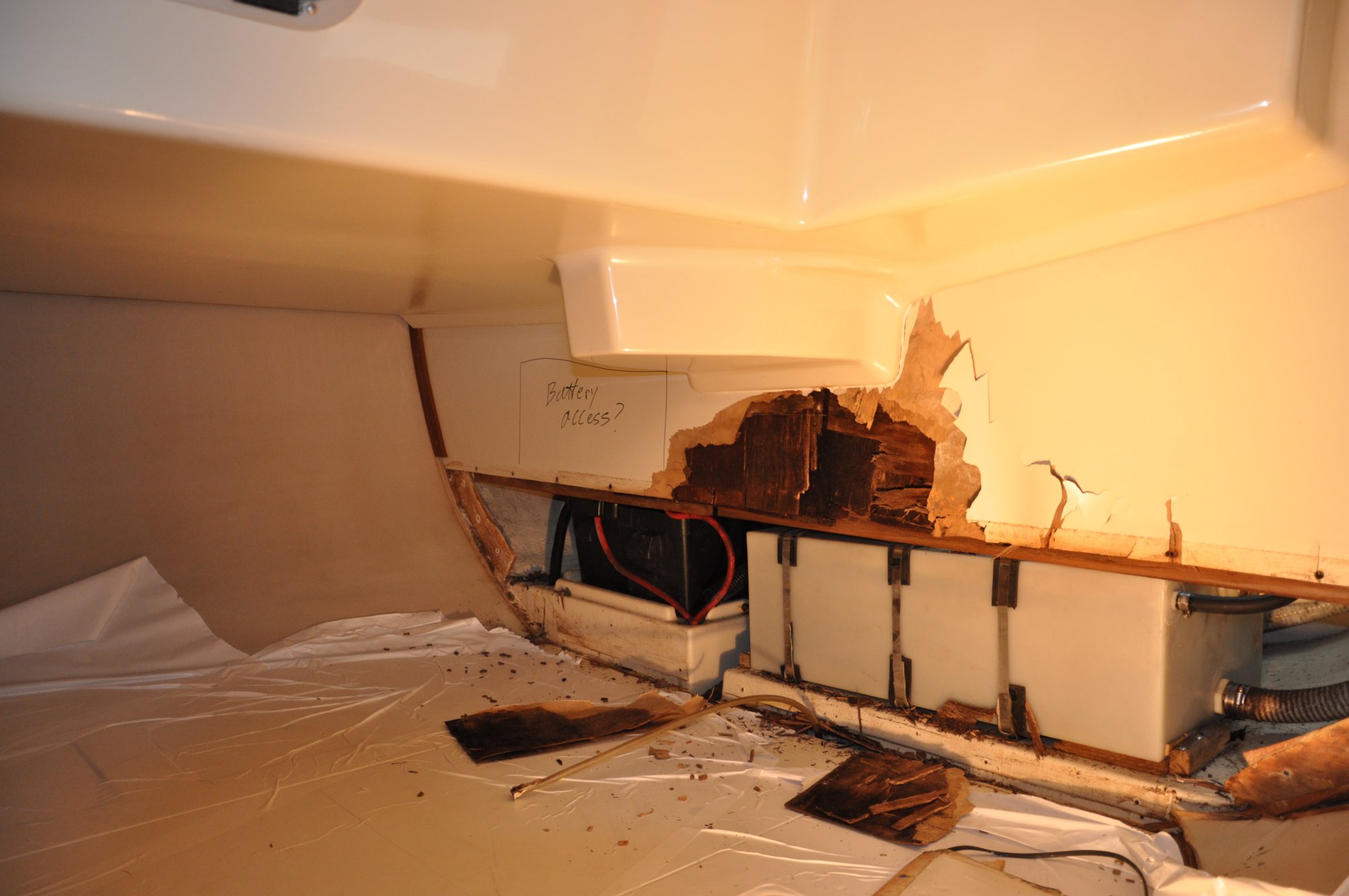

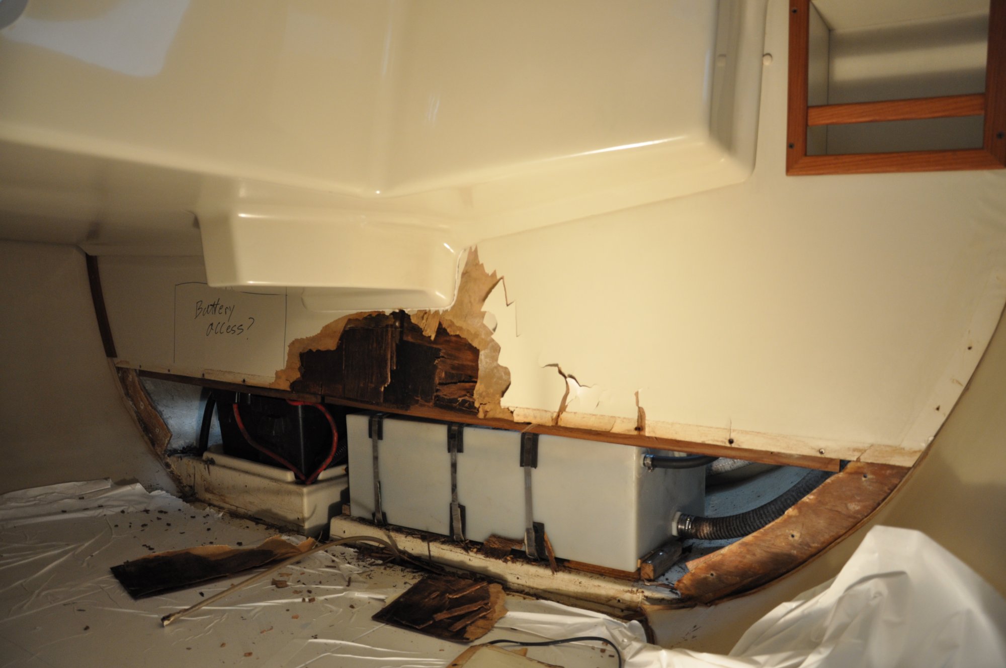

I also cut a hole around my waste tank but for a different reason. I wanted access to the starboard inner deck above my batteries. The deck was very rotted. Years ago I saw what Jim Rushing did, so I decided to cut around the tank and gain access to the battery area. My vertical wall was only a little rotted so I was able to cut out enough to end up with a sturdy rectangular hole. By removing the floor panel over the drive shaft you get some idea where the bottom of the panel sets on the fiberglass shelve. just go up about 6" and about 4" from the starboard edge to the port side of the floor panel and cut a 5" square out. From there you get a reference point. I recommend you use an oscillating saw with a half moon cutting bit. It is easier to control. After you get your opening to the desired size. You can make a cover panel from 3/4" teak plywood. I over sized the hole 3/4" on the top and sides and cut a rabbet 1/2" deep and about 1" around the upper and side edges. I then just attached the panel with four wood screws. One at each corner. The panel looks like it always belonged there.
