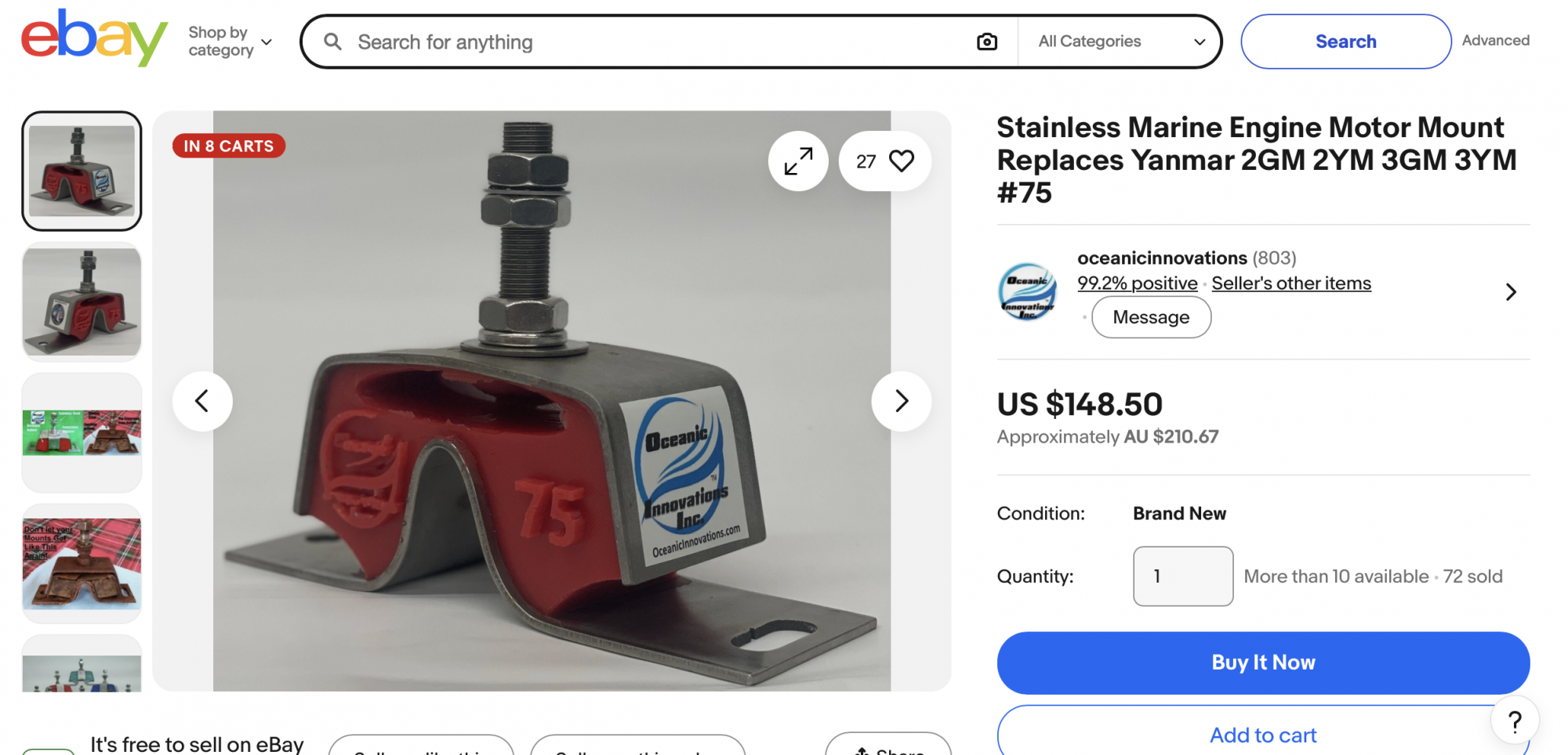

Hi Folks,
Need to replace all four engine mounts on my 3GM Yanmar as they've gone soft and engine rattly and vibrating lots.
OUCH!!! ... was shocked and amazed at price of these for a little lo-tech block of rubber and metal.
Around $2000 AUS here down under. And that doesn't include labour for fitting and shaft alignment.
So I started snooping around the Net... as you do, and found these US based options which look pretty good. And sub 1K (AUS$) for a full set. They're stainless and urethane which makes sense.
Does anyone have any experience with these (pic attached) or.... any other suggestions of recommendations?
Many thanks in advance - Mark Mac QLD AUSTRAYA

I have no experience with those mounts, but they look fine, with what looks like good damping. What you don't want are extremely rigid type after market mounts that transmit a ton of vibration to the boat.

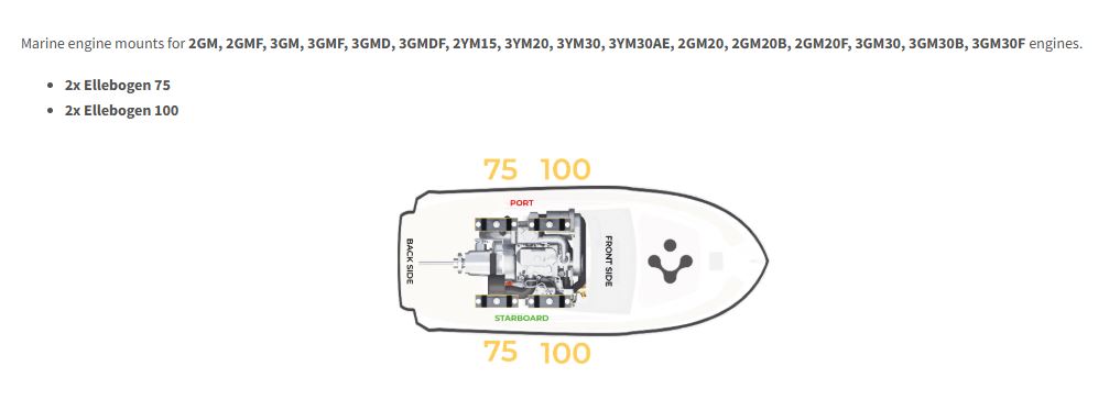

Original Yanmar mounts are definitely NOT stainless steel.
Also note the hardness rating stamped into the side of the rubber component of your existing mounts. You will want to duplicate that spec on the mounts that you order. I believe that the mounts on my 3YM30 were rated at 75 on the forward mounts & 100 on the rear mounts.

Original Yanmar mounts are definitely NOT stainless steel. Also note the hardness rating stamped into the side of the rubber component of your existing mounts. You will want to duplicate that spec on the mounts that you order. I believe that the mounts on my 3YM30 were rated at 75 on the forward mounts & 100 on the rear mounts.
You are correct regarding the material used on the OEM isolators. The Ellebogen ones also appear to use a thicker gauge as well. The hardness rating is called the durometer, which also refers to the measurement device. Regarding the orientation, please attached image from the Ellebogen website as well as from the GM installation manual.
