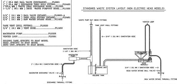

Might post a photo of the sea cocks and make a drawing of the hose and where they are attached. From page your manual Hunter_340_68030594.pdf (sailboatowners.com). I see 1 thru hull for waste discharge, for use when legal to discharge, and a second one for raw water to the toilet. There should be another for vanity sink drain.

One of the biggest problems we face on this site is the posting of complex questions without pictures and I'm afraid your problem falls right into the middle of that category.
@Ed Caldwell has described his own '99 H340 which sounds quite different from your 2000 H340. They should be very similar but it seems they're not. This is the reason we ask for pictures. The H340 drawing from @sail sfbay is identical to my '99 H310 but your description is again different from those. @jssailem 's remarks also emphasize the need for photos of YOUR piping system on YOUR boat.
