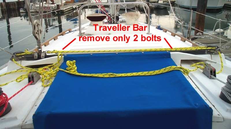

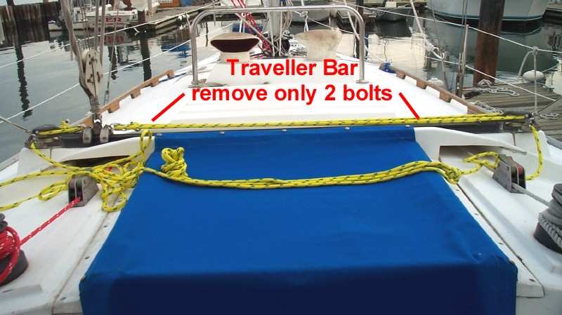

Of course I can't find a picture, but my wife made a cover out of the waterproof Sunbrella that extends from the traveller all the way down to the cockpit floor. We put snaps at strategic locations to hold it in place when we are away from the boat. Since it tended to fill with water because its a flat surface, we place a piece of rigid foam underneath (on top of the hatch cover. That gives it a tent shape so it sheds the water. No more leaks into the boat.
Jul 4, 2015
436
Hunter 34 Menominee, MI; Sturgeon Bay WI
I believe this is a picture of what you are referring to (I found this posted ):
