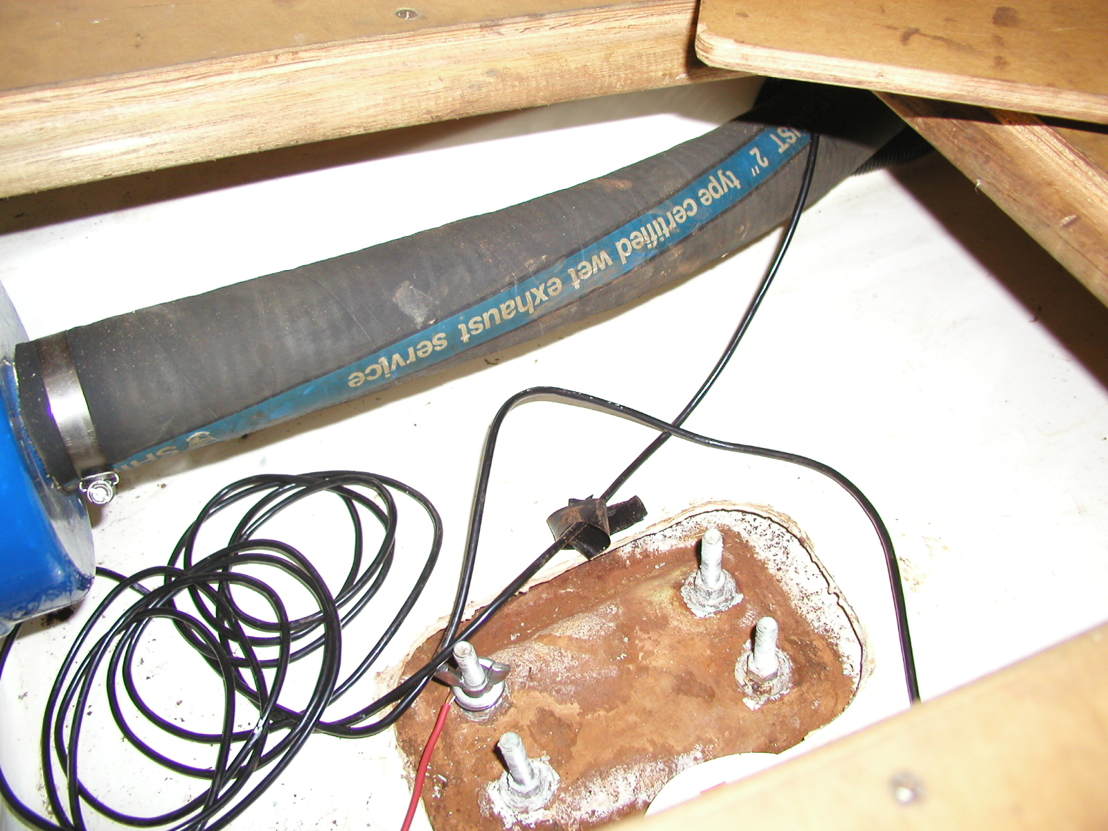

The engine can be lifted with a frame to get it high enough to remove the shaft.. I have heard of folks doing that with a 4 X 4 post laid across the companionway.. The engine has to be lifted about 6 inches and some reported that in their boats, there was enough slack in wiring and hoses (ex sea water intake ) to get that done.. The concern is that if the engine were to fall, it may not stop at the engine mounts! The other way is to get the shaft strut loose from its bedding.. usually 4 bolts (but sometimes 2) under the aft berth access.. once the strut is off, the shaft and Cutless can be removed.. This one comes with a caution.. re-aligning the strut is a tough, precise job.. Sometimes removing the rudder is a good answer.. If you are replacing the Cutless only, there is a tool that can remove/replace the bearing with the shaft in place. I have heard that once the Cutless is out and the prop is off, the shaft may be able to be pulled out .. it would be rubbing on the rudder.. I don't know if that is possible on all of the 34's..
picture is of my 4 bolt strut attachment..

Yes, what Kloudie1 said. We had to replace the coupling, stern tube, shaft, strut and cutless in September. At least the prop and nuts were still good. Also replaced the cotter pin LOL. Once the coupling is pressed off and the strut is dropped the shaft will easily come past the rudder. My wife and I did it all ourselves including alignment of a new strut.
Hats off to the SBO store for the new strut including cutless and a really quick turn on a new stern tube exact replacement..
Things have been busy here so I didn't get to write it up but I have lots of pictures.
RoyS

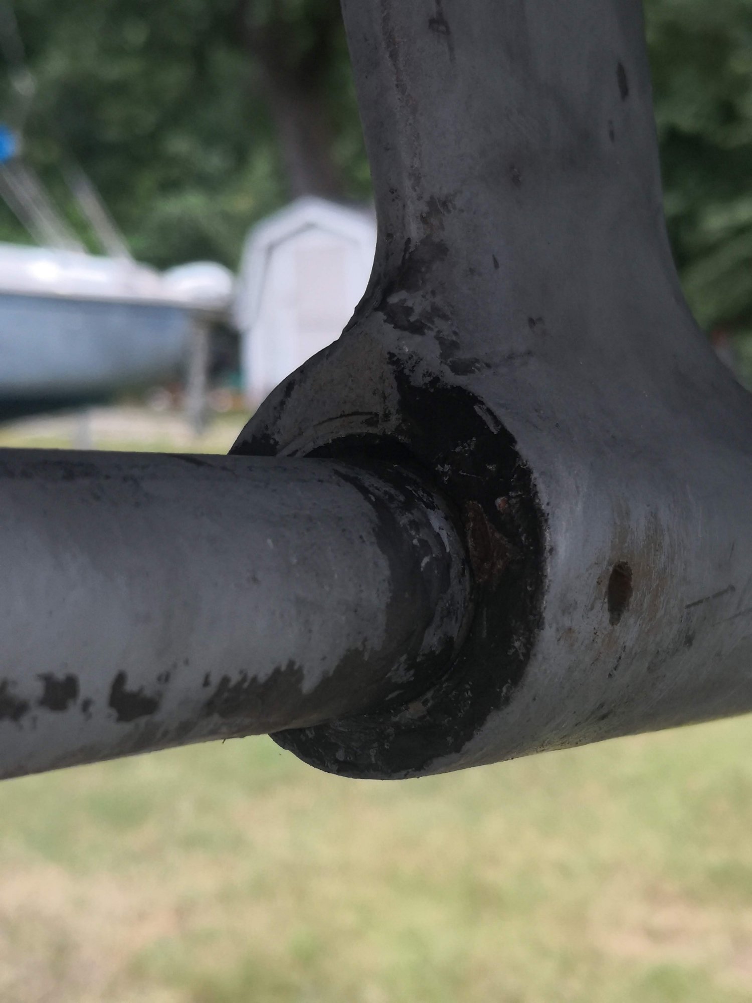

Allan, would you mind detailing your process for realigning everything? I have a pretty bad alignment, and I can't even get a traditional cutlass bearing removal tool in. I don't know if this is a result of the boat changing shape since its on the hard or what, but its a gap of .0051 at the fore top side of the cutlass bearing and similar at the aft bottom side. It almost looks like I need to pull my strut and shift it down/forward. Any advice or additional pictures of your process would be greatly appreciated. I'm probably at least looking at replacing my coupling as well since it is incredibly rusty. That is if I can ever get it separated from the transmission...
