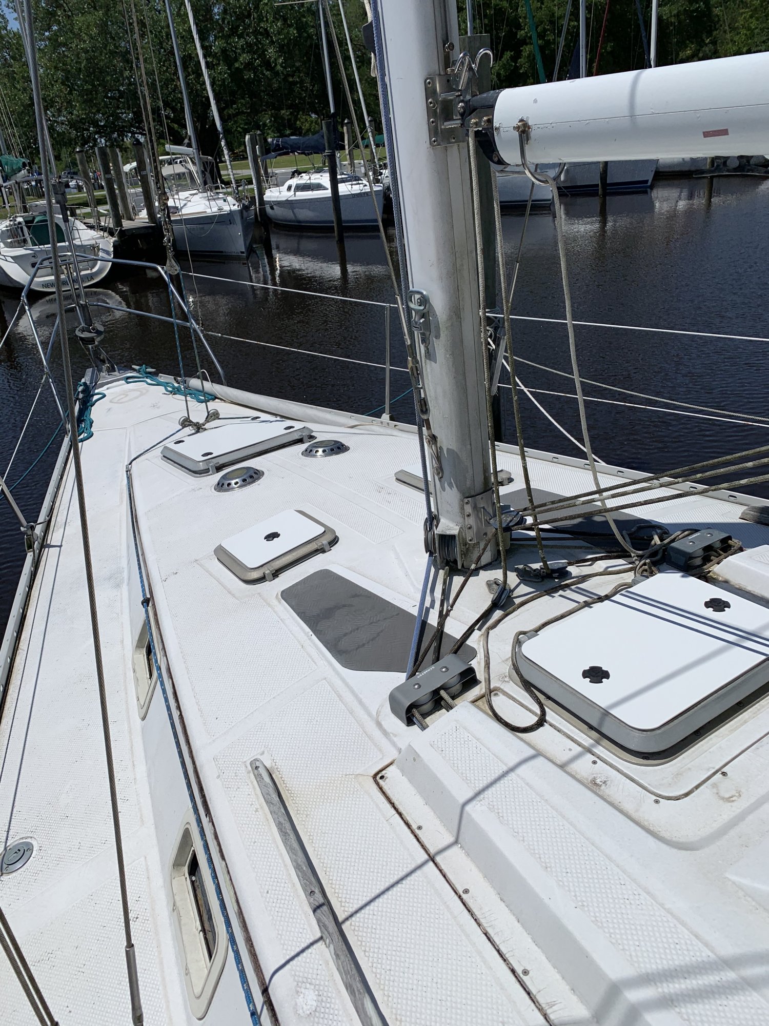

The provision for the lines is from the area just aft of the mast.
There are also four sheaves at the base of the mast; coming from within the mast, but no lines coming through.

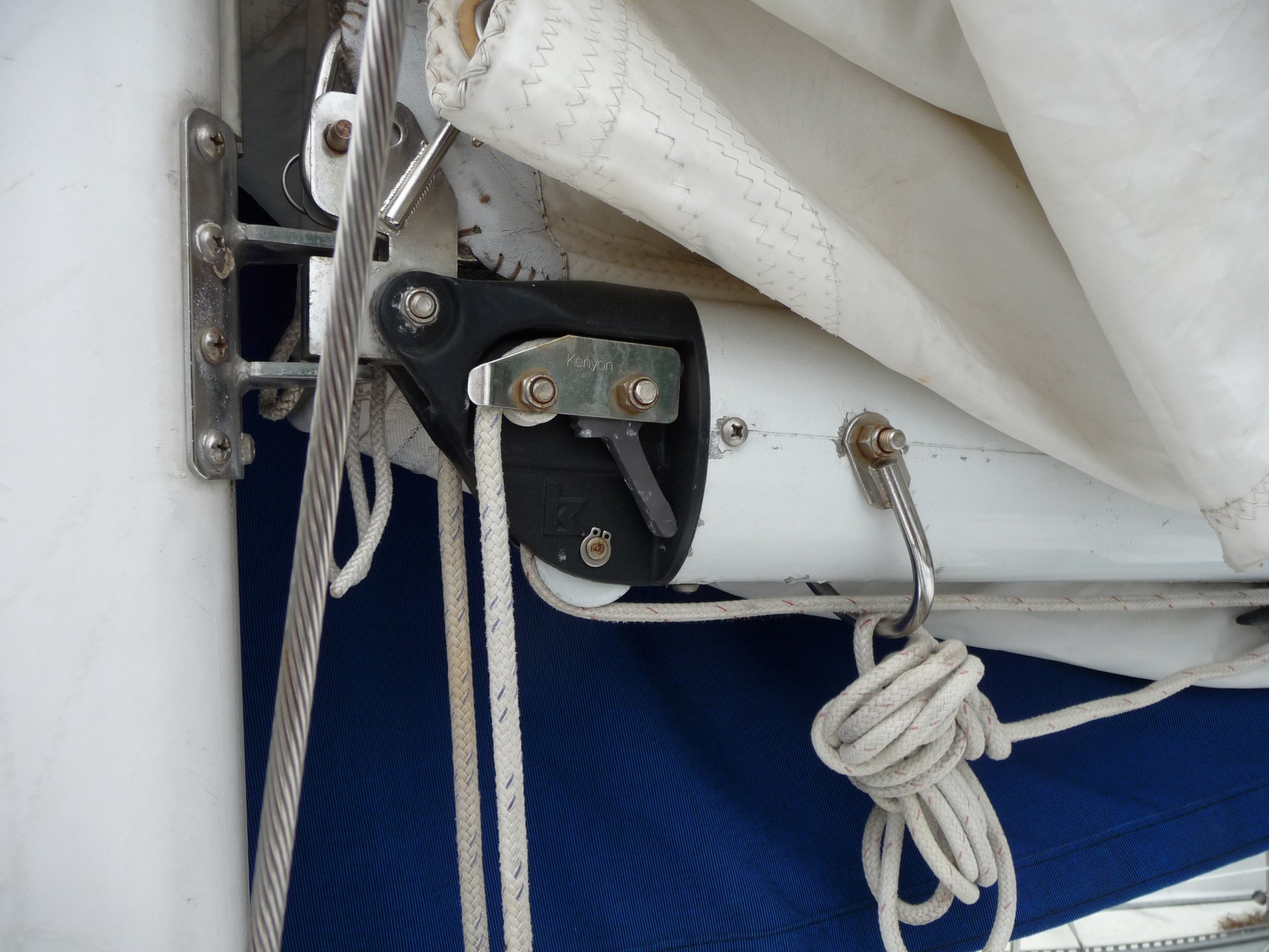

On my boom, The reefing lines go from the cabin roof cleat through the "tunnel" to the deck organizer. From there, to the small blocks on the eye just behind the mast, up to the sheave on the forward end of the boom that directs the line inside the boom to the sheave on the aft end of the boom. From there up to the reef cringle (grommet) on the sail then back down vertically where it is tied around the boom. There are no external sheaves on the boom. I am pretty sure that my boom fittings aren't Harken castings.
This is the forward end of the boom; the small line exiting on top is the reef line. There is a cam cleat at the sheave but I leave that open. The bottom line is the outhaul; it has a 2:1 purchase on the outhaul which exits the aft end of the boom.
10,145
To reef the main, the main halyard is slacked to hook the reef tack onto the reef hook at the front of the boom; someone has to go to the mast to do that. . Next the appropriate reef line is pulled to bring the reef point down to the boom. The reef line is cleated off, then the main halyard is tightened using the cabin top winch. Hope that helps

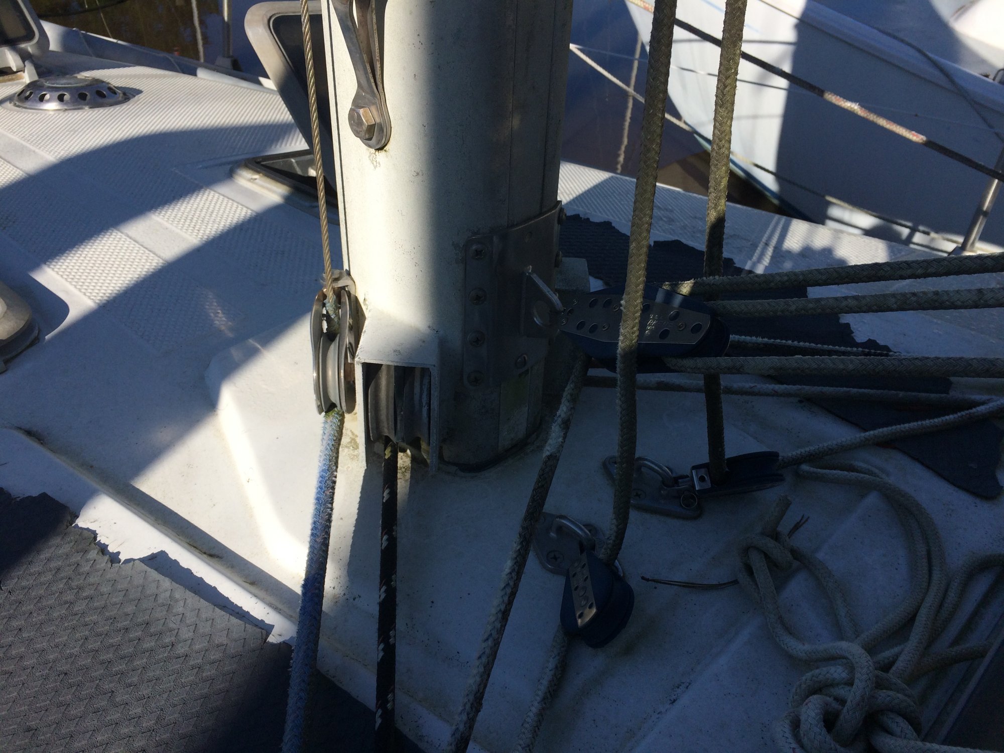

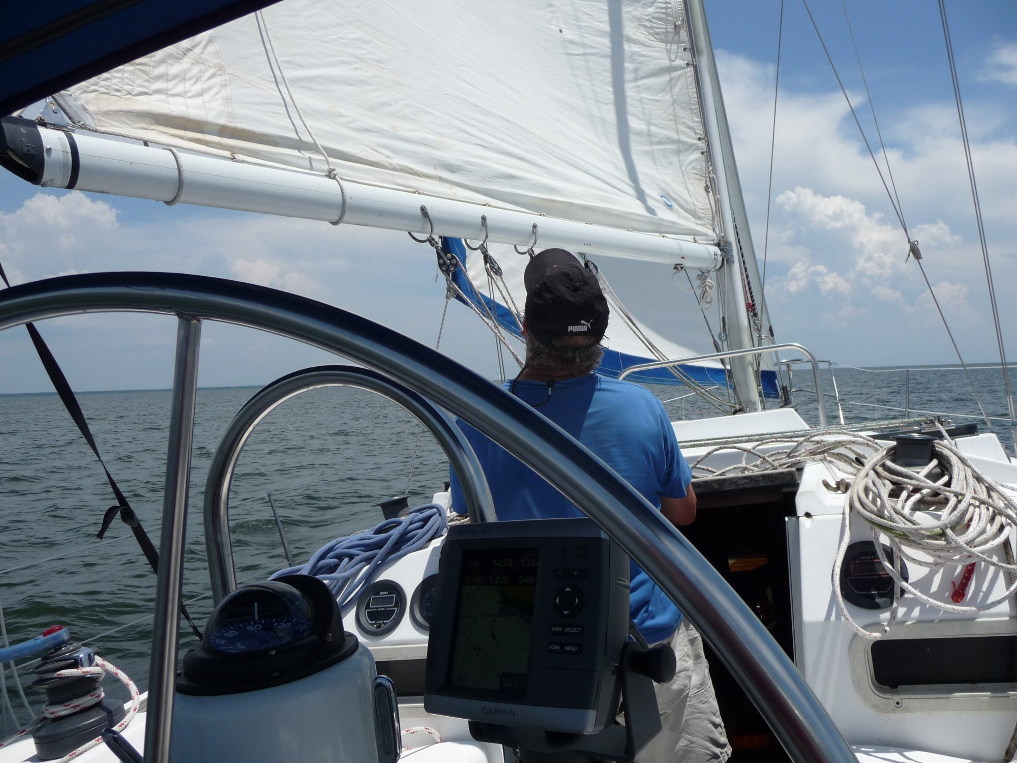

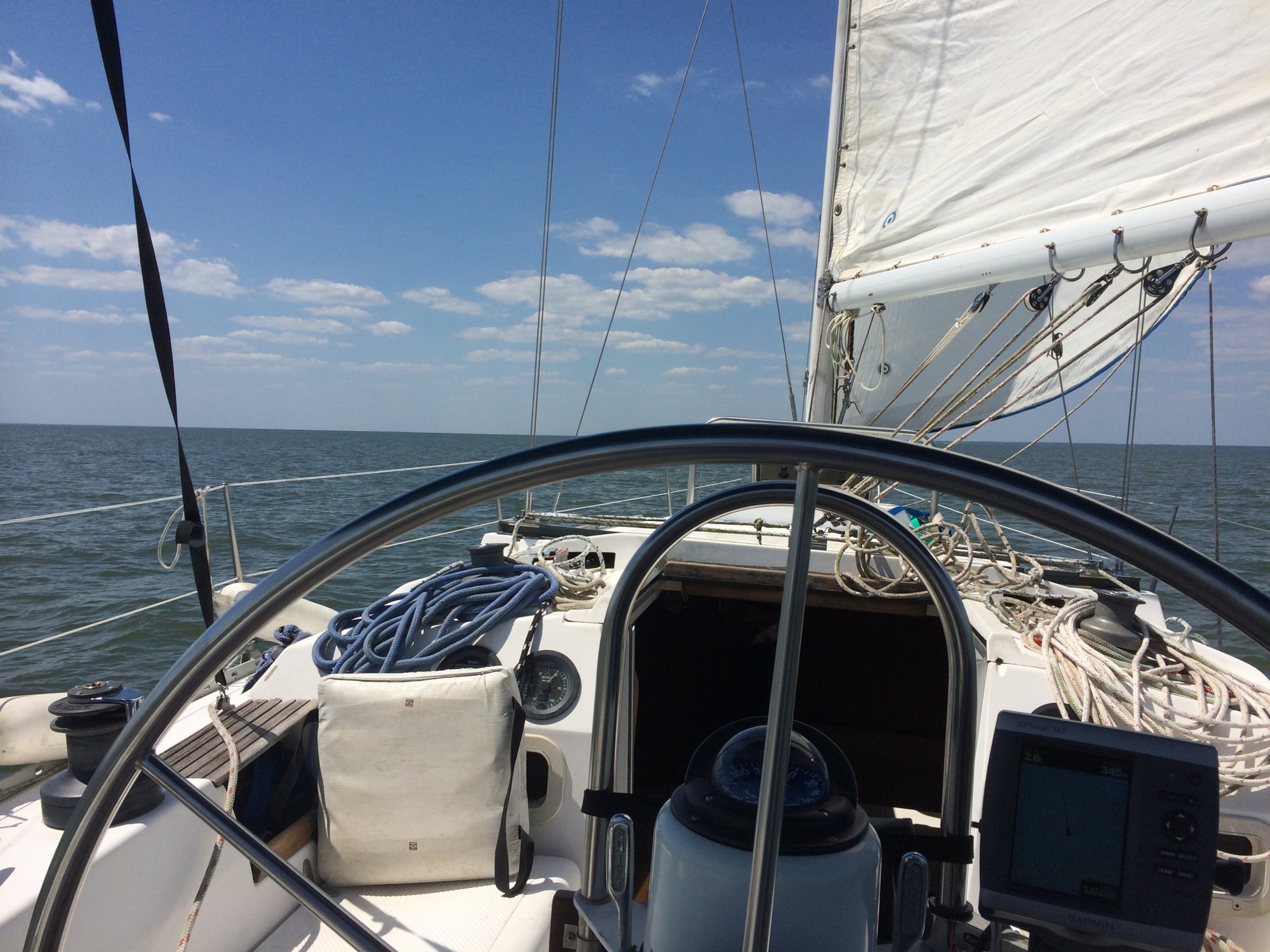

Kloudie, like me, has the original Kenyon boom. If you have it too, you'll see the 3 sheaves for the 2 reefing lines and for the outhaul at both ends. For your info, the attached will show you how I rigged mine. Like Kloudie I have no winch on the mast. I installed sheaves near the bottom of the mast, doubled-up the deck organizers and added cam cleats in front of the winches near the companion way, so that I now have everything except the spinnaker halyard coming to the cockpit. Look at the the pictures. Hope this helps.

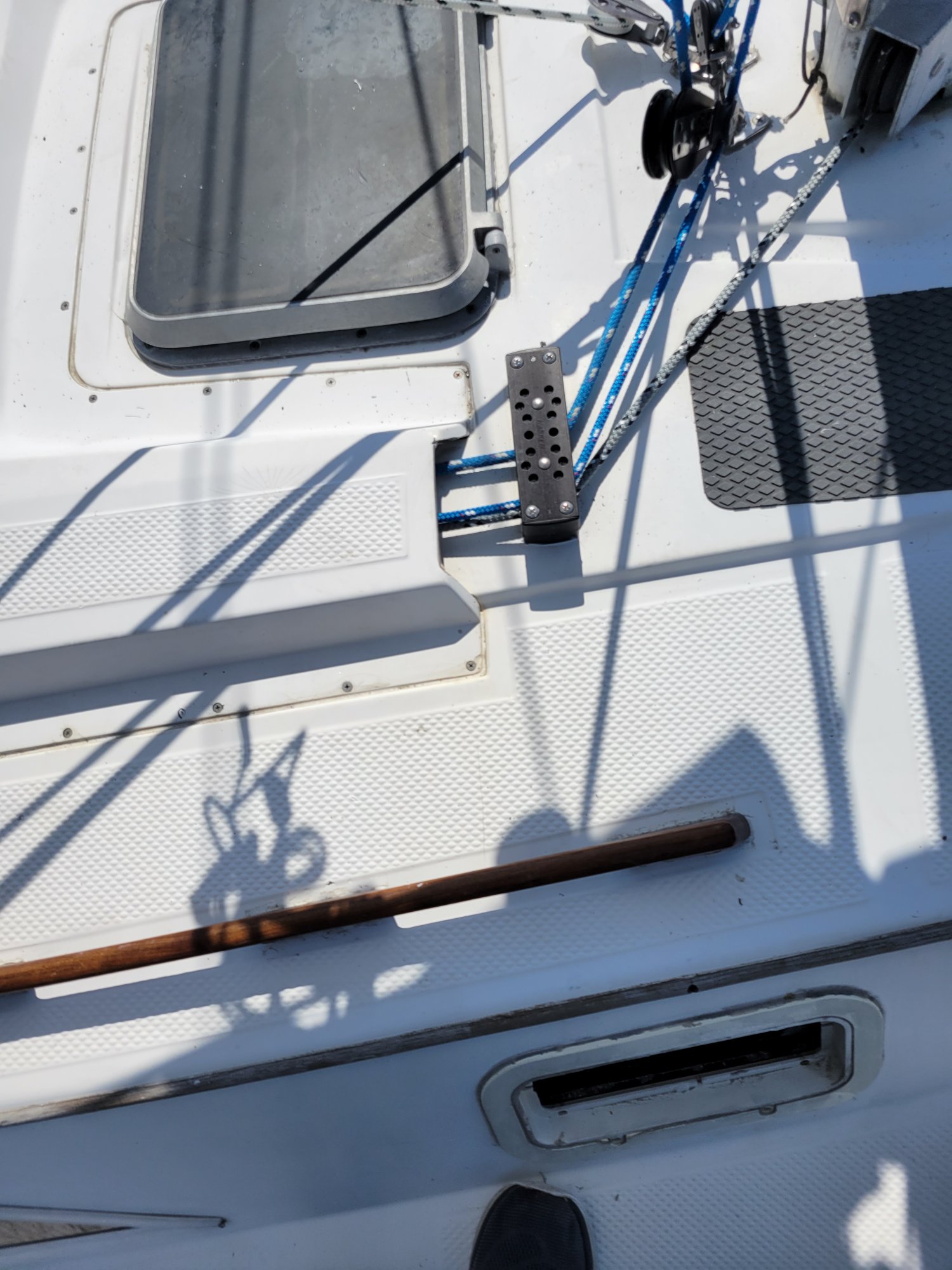

This particular boat has provision for two lines through the tunnel on either side, with two stoppers either side, and a winch either side.
Only one line in use; the boom vang.

I upgraded my H34 also. Had to add a double set of deck organizer sheaves for the lines. My 84 H34 apparently has an aluminum place in the deck that can be drilled and tapped for newer deck organizers. Not a big deal to buy a tap and drill to install a new deck organizer. If it is windy enough to reef the main, reefing from the cockpit is preferable.
