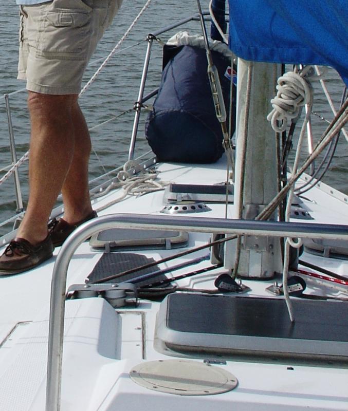

H-34 Reef Lines
Here is a not-too-good view of the reef lines coming down to deck block then to the deck organizer, then aft in the tunnel to a cleat .. originally the blocks were Schaeffer, but after they failed from UV, I replaced the blocks with Harken
