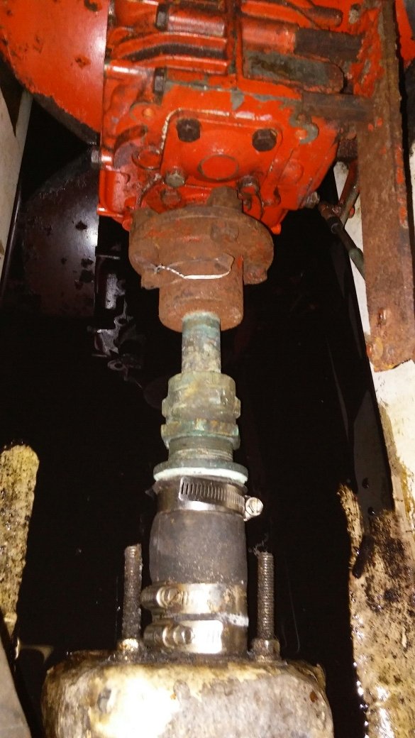

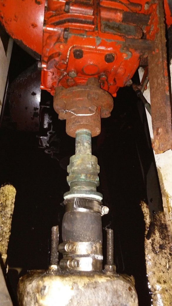

Rather than try and press the coupling off the propeller shaft I am looking at possibly replacing the shaft with a stainless one and getting a new coupling. I currently have a bronze shaft and it is probably the original, and have read horror stories on the forums here about getting the coupling loose from the shaft. I am also worried about damaging the transmission while trying to get it off. Am trying to get an idea of what it would cost to get a new stainless stell shaft. Does anyone know the length of the shaft on a Hunter 34? 1983 model Westerbeke 21 with HBW Transmission. I obviously can get the exact length after I cut it out if I go that route but as I said trying to estimate costs.

for the shaft only plan on $275.00 but if you get one made with the coupling mounted on it from the supplier you may get a better deal for both ...try general propeller in bradenton fl for a quote ....but have all you dimentions ready to tell them when you call....they were very helpful when i had mine made.....

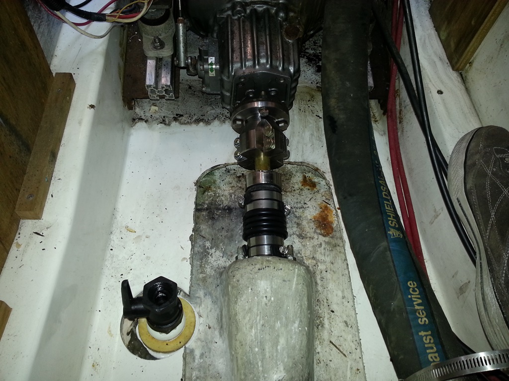

You can still give a shot to removing that coupling without risking the transmission half. If it works, you've saved yourself a lot of effort and expense. You could apply the money you save to a new PSS dripless packing and R&D split coupling.
