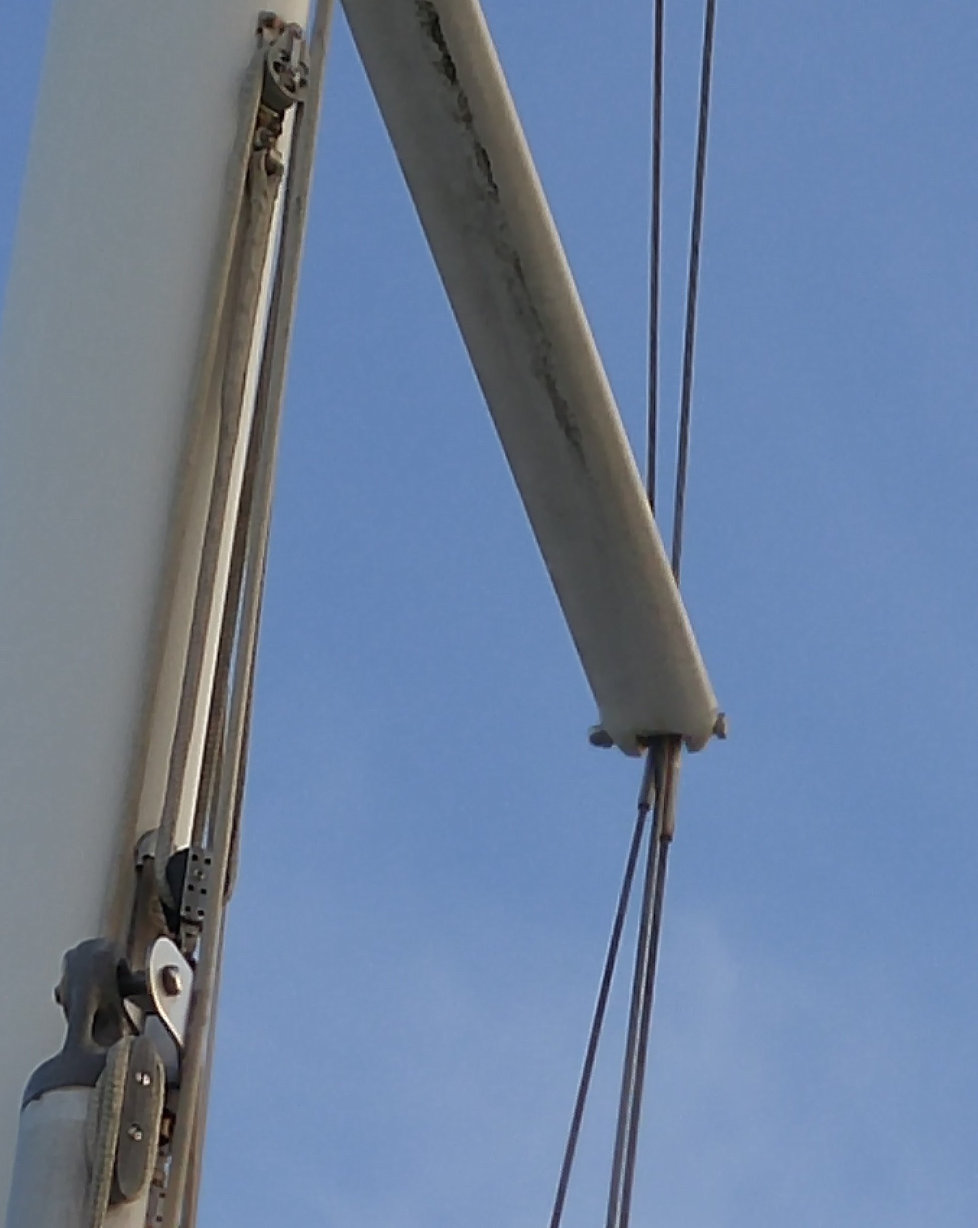

That is interesting, Allan- That must be the lower spreader by what I see on the mast- but only 2 shrouds coming down to the end and only 3 coming down from the end. I have 3 coming down to and 4 coming down from the end. What is missing- it looks like the continuous one from the top spreader to the forward hole on the deck?

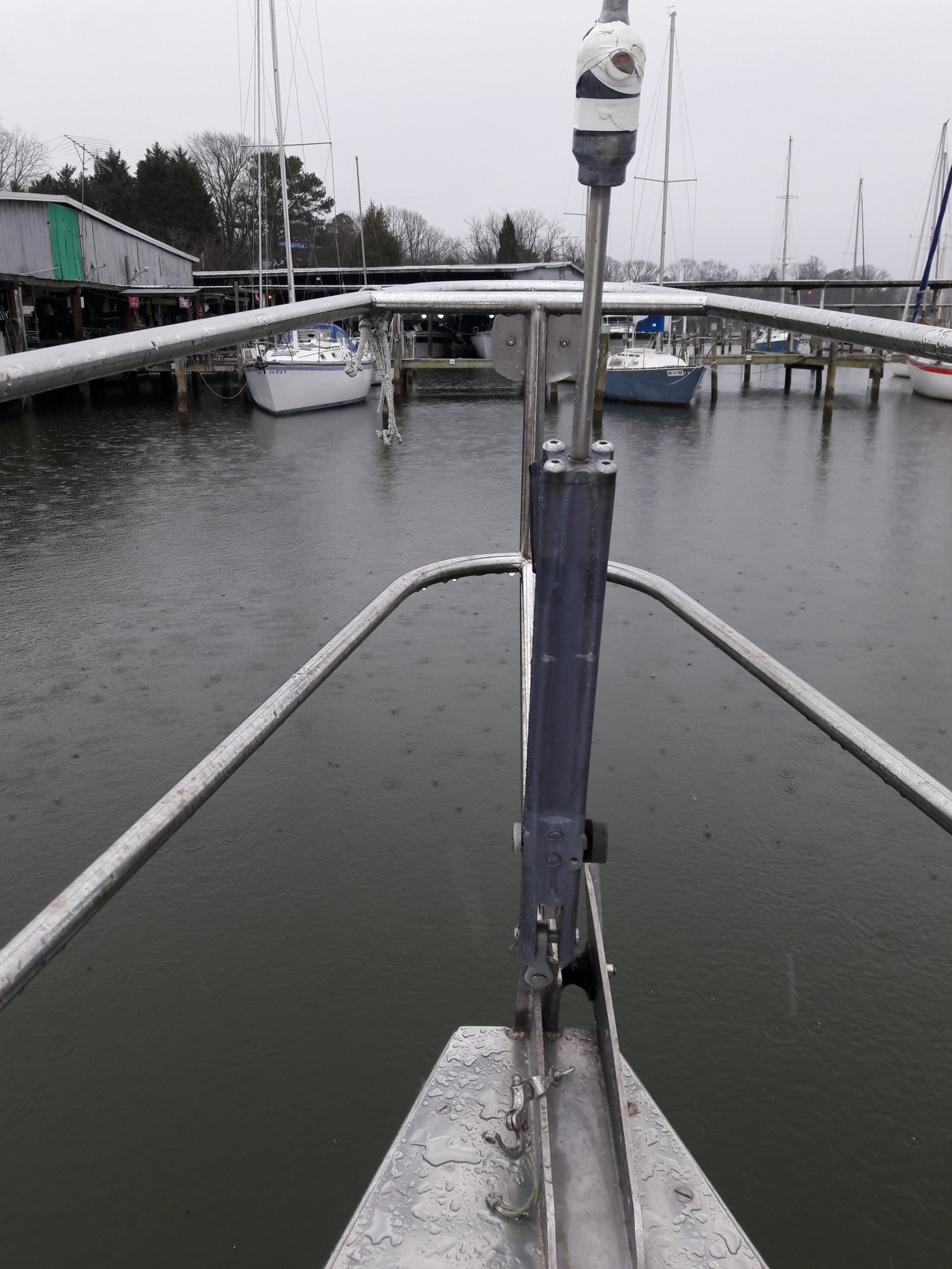

I have a 1983 H34 with a B&R rig, I am in the process of installing a roller furling jib; however, I have run into a snag, on the forestay there is a hydraulic tensioner at the base that rises about 14 inches from the stem plate. Has anyone encountered this problem before and how did you handle it? 22JAN17 Picture dump 070.jpg 22JAN17 Picture dump 070.jpg 22JAN17 Picture dump 070.jpg

I have never seen that set up nor do I know why you would have a hydraulic set up on a forestay. Every boat that I have sailed with hydraulics to produce mast rake is done by the back stay. It looks like for some reason the forestay was modified, cut to short maybe and someone added this set up to make up the length. That's strange, what is the function of that set up?
If it were cut short it would have been more cost effective to replace the stay.
I would just replace the forestay with a new one.

Having never seen a setup like this I can only guess that this works against a B&R rig which is purposely set with too much pre-bend and or purposely set with rake on the mast and the cylinder pulls the excessive pre-bend and or rake out by adding tension to the forestay. Personally I would replace the forestay with the stock setup and then add your roller furling. If you want to add mast rake then do that with a running back stay setup.

Concur with DayDreamer41 to replace the forstay with the hydraulic cylinder for a 34. I sold a few in my time as a dealer. If anyone has reverse cross diagonals that touch or nearly touch, for protection as advised by one fellow with B & R , install a shroud cover as added protection. However, that is not good and you may need to readust the mast.

Thank you for your replies, I have sailed for over 50 years and never saw that type of set up, but I never owned a boat with this type of rig. Today I went down to meet the sail maker and decided its got to go. I have enjoyed the contributions of all here. Getting ready for another year on the Potomac and Chesapeake
