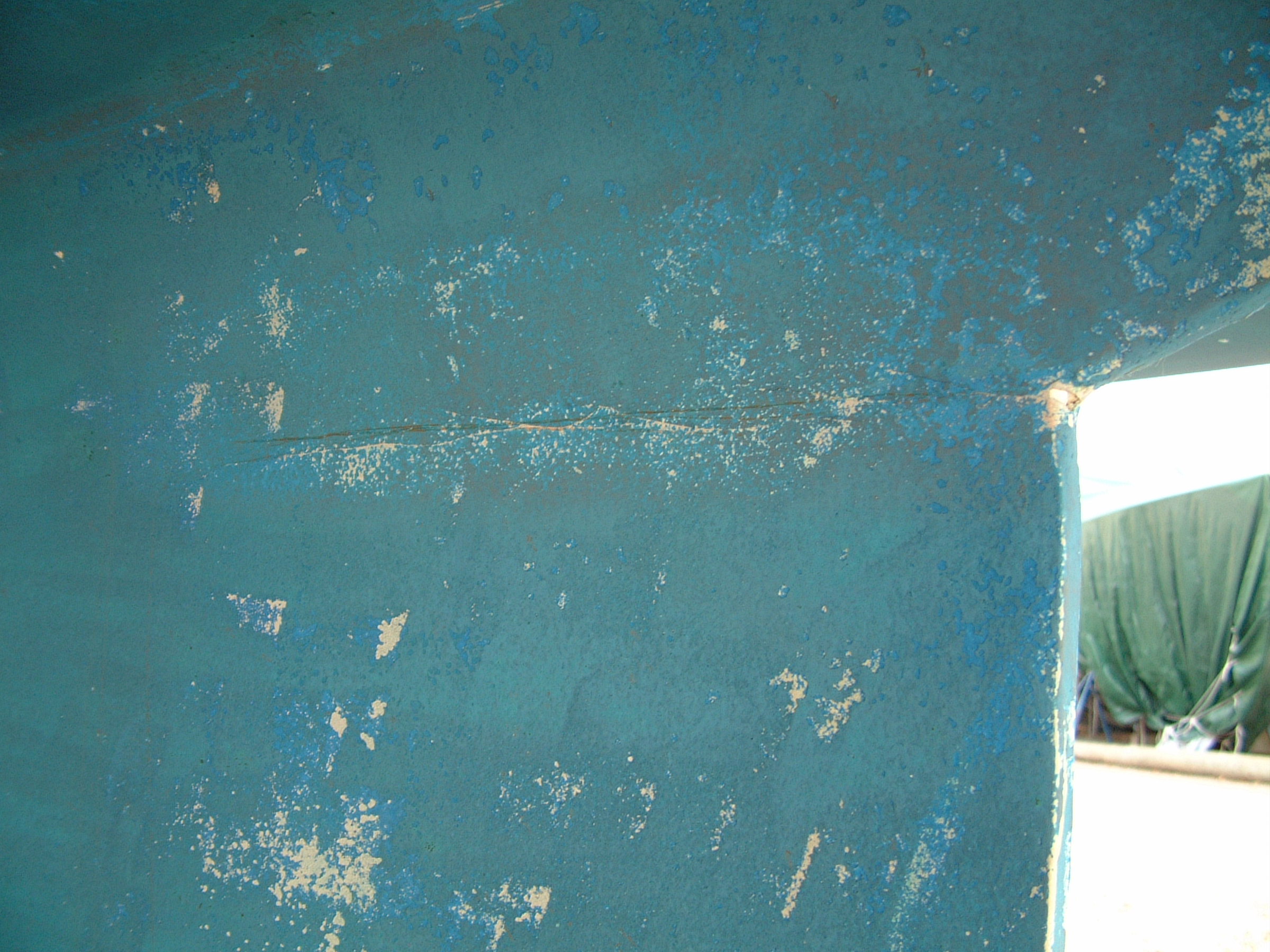

When my 87 Hunter 34 was hauled for Winter storage, I saw a crack at the forward end of the cast iron keel and also at the rear of the keel. Both cracks are where the keel meets the hull, and are about 10 inches long, around each end of the keel. Except for those cracks at each end of the keel, there are no other visible cracks along that seam. FYI, last year, I had the marina grind out and re-lay/fill the entire seam. Then the keel was blasted and sealed with Rust-Lok. They also re-tightened the keel bolts. Finally, I stripped and coated the entire hull and keel with four coats of barrier coating, prior to bottom painting. Late last Summer, some water (not much) started leaking into the bilge from where the rear area of the keel would be. The leak was small but continued until the boat was hauled-out in the Fall.
I have already dug-out the two cracks. How should I fill and fair out, and what would be the best filler material ? 3M- 5200 or something like West System G-Flex epoxy ? Thanks and

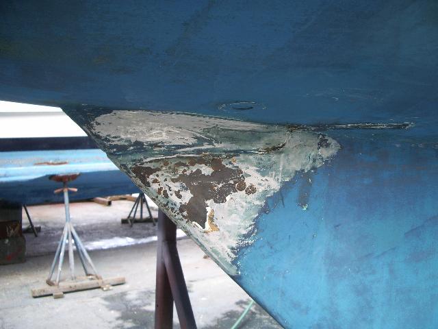

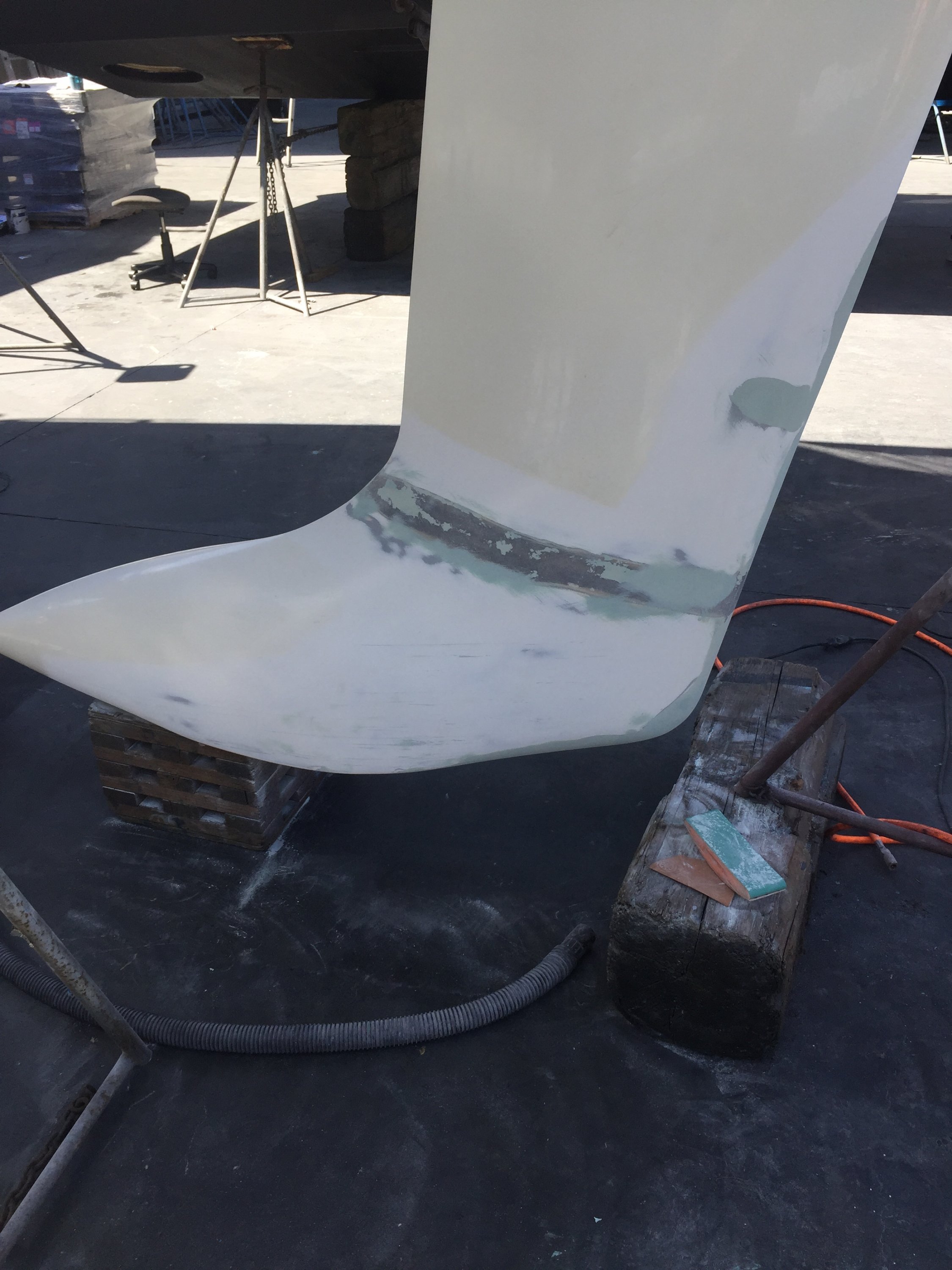

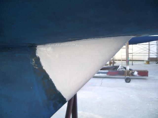

I haven't owned my H34 anywhere as long as Capt Robbie. We bought ours new in 1985. ;):biggrin: However we've addressed the same issue periodically like he has. I used 5200 for a few haulouts as it is flexible and withstands long duration immersion. But it would eventually disappear and the cracks would come back. In 2007 we bit the bullet and stripped all the paint and barrier coatings off right around the crack (not the whole thing). Then we ground some of the exposed keel to bare metal and treated it with Ospho to pickle it. After that it was about 4 layers of glass cloth with West systems epoxy followed by 3 coats of Interlux 3000 barrier coat to join the keel to the hull stub. Last year it finally showed the cracks again (9 year run). It was a matter of sanding into the previous mat to get through the paints and lay it up once more. The question is: will it last 9 more years? Will I last 9 more years? Hope so. The pictures are a bit out of order. There is the 2007 bare, then 2007 primed and ready for bottom paint then the 2011 haul with no crack for the first time.
