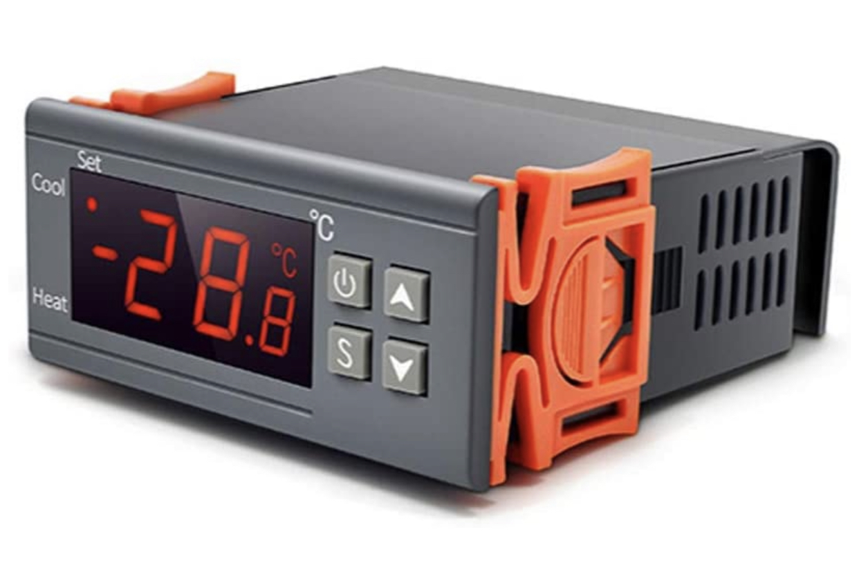

I also installed an Isotherm conversion this summer, into a Legend 37. Found it difficult to set the stock thermostat in a manner that didn’t freeze everything... for $12 I installed on of these digital controllers, works perfect! I can’t take credit, I saw other Isotherm users had suggested this mod... comes from the home-brewing crowd.
