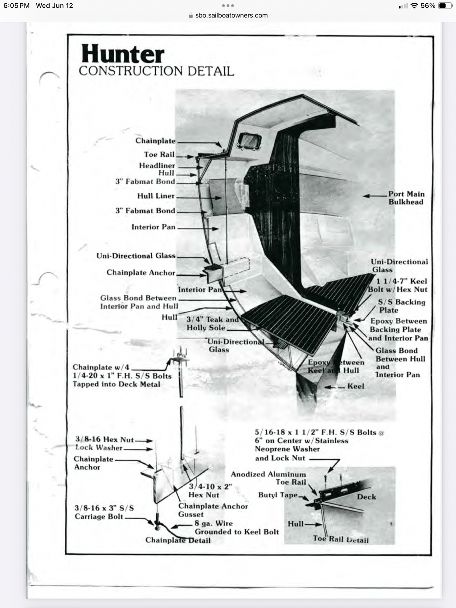

I don’t own one, but I would venture a guess that the deck is cored, but the hull is not.
I found this diagram here on SBO for the H34…
Maybe a H34 owner can confirm my guesses.
Greg
10,134
Greg is correct, hull is solid and the deck, cabin sides and cabin top is cored with plywood. The cabin sides really are not cored in the traditional sense; the cabin liner is not well adhered to the inside of the plywood, so ya have a plywood plate glassed to the outer shell but not completely to the inner liner.
