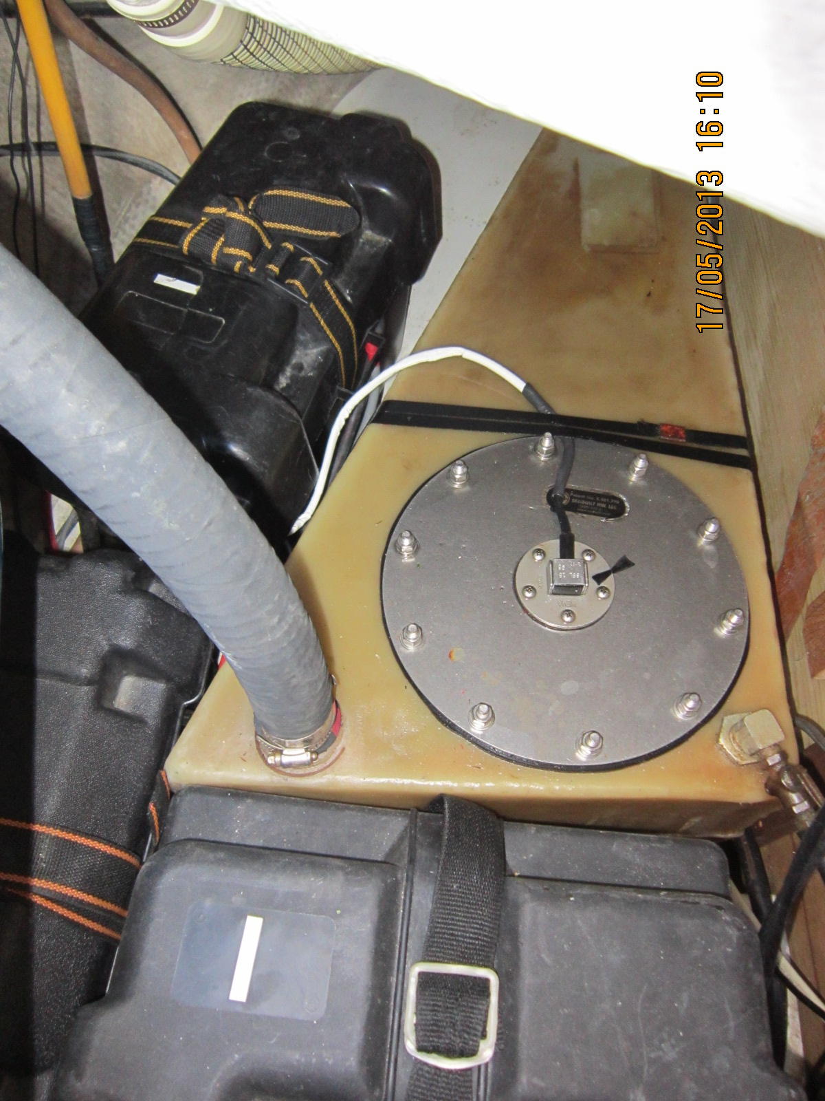

If I recall correctly, there is a slight difference in the depth and you're right that the aft section is shallower. I Installed a Wema gauge with a vertical sender in the deeper forward section (see pics). It has been years but I believe the depth there is 16''. The vertical sender was 15'' and it suited me fine since I figured I would get a reading close enough to avoid running out of fuel. I keep a very detailed log with engine hours and fuel usage, and so far the gauge has been very close to being dead on. IOW when it reads about half full, I can pump in a little over 11 gallons. Considering the posted capacity of 25 gallons and the fact that my sender is 1'' from the bottom, I am happy with the unit. And the vertical senders seem to have less issues than the folding arm ones. Good luck with your decision...and installation if you do go ahead.

Like Claude, mine is 16” deep at front. I have an 15” WEMA, too.

I manually [hand pump] mine out. Then, cut out for the 8" inspection plate. Then [with gloves on] wiped out the debris and remaining diesel. Then, cut out for the WEMA.
I used this to make the circle cut. Very little debris! Circle Cutter

I had cut a 10'' hole to install a Stainless Steel inspection plate. After cutting the hole with a jig saw, I pumped all the fuel out and thoroughly cleaned the tank before installing the plate and its cover. It was a no-brainer to install the Wema fuel gauge sender in the center of the inspection cover.
