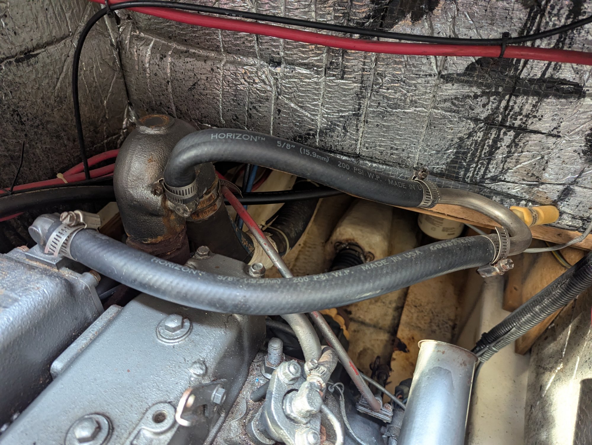

Hello,
My 1986 Hunter 34 Yanmar 3GM30F has a siphon break between the exhaust elbow (that's being replaced), while looking at other hunter 34 i've not seen a break installed.
I suspect a P.O upgrade but interested in the groups take

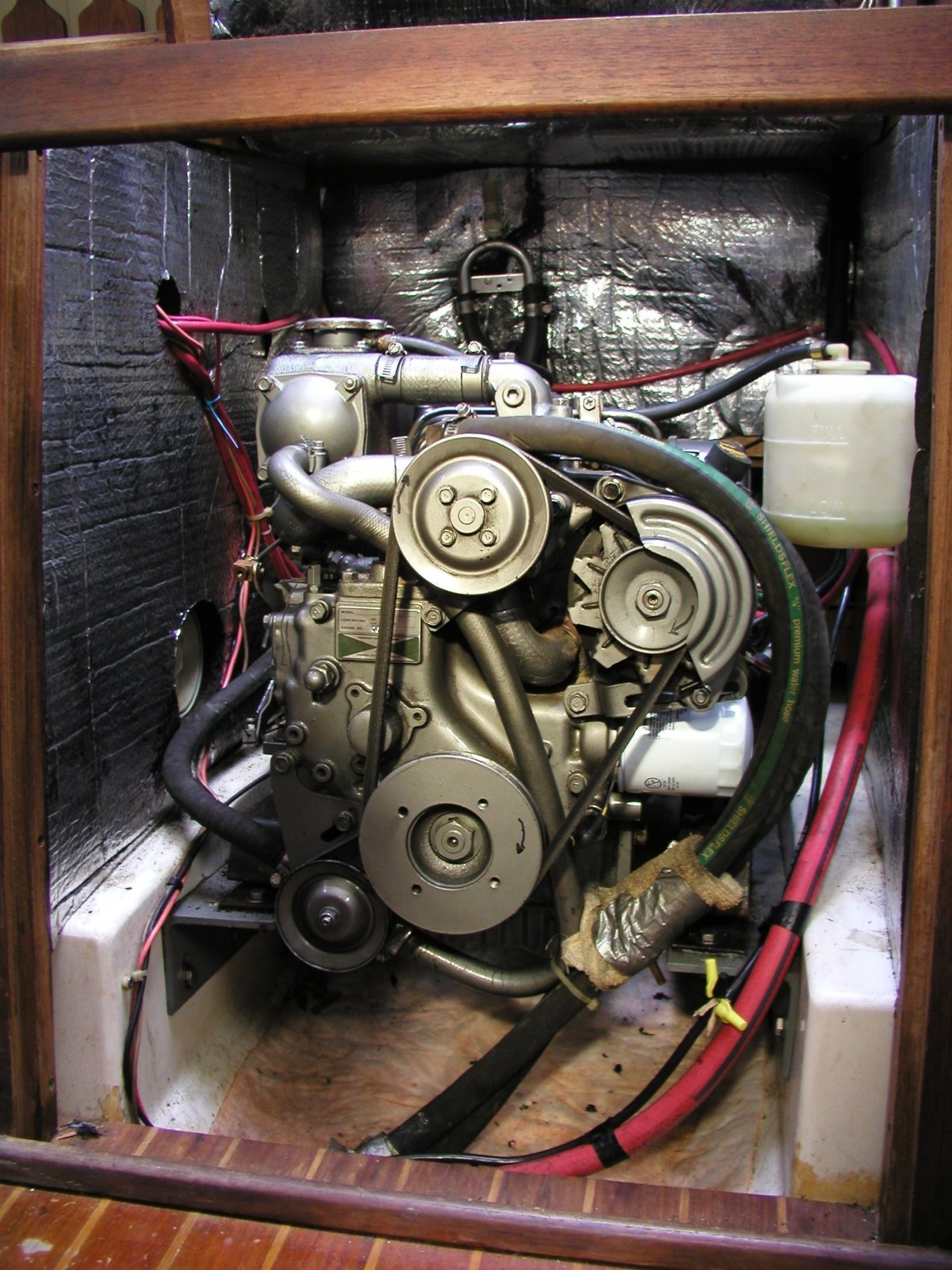

The break was installed by Hunter on my '84 model H-34. Picture attached; you can see it on the back wall. The little check valve on top failed many years ago .. I found an exact replacement and its been fine ever since.

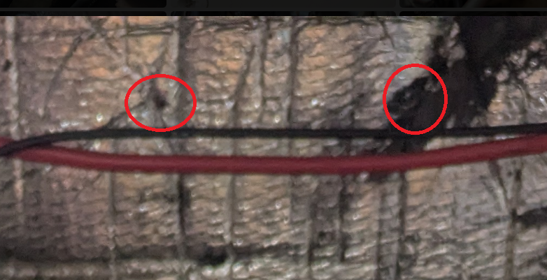

Mine (1985) was exactly the same as Kloudie's. Are there any witness marks on that sound proofing material (compressing or old screw holes)?
Need to validate in person but I do believe so. Very similar to where Kloudie has his mounted.

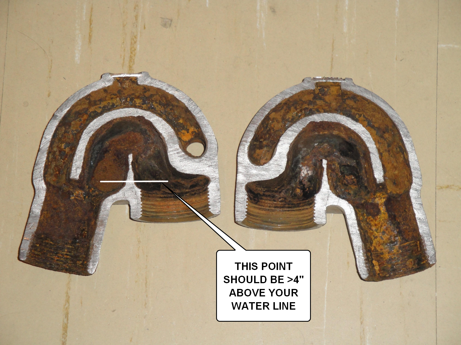

I measured the water level using a clear vinul tube attached to the engine raw water thru hull. The bottom of the mixing elbow was about 4" above the water line. Close enough for me just to avoid another mess and paint job like that again and over the side went Hunter's vacuum breaker assembly. After chucking the mess, I tested the raw water throughput (with the engine off) with about 24" of head on the engine cooling system and found no raw water leakage due to the sealing of the raw water pump :
The 4" measurement is to the bottom of the of the mixing elbow inversion just in case the dam should ever corrode through as this one is getting close to.

The design of a siphon break is not determined by the boat or its builder. It is an independent tool used to prevent the backflow of water when the engine stops. It must be oriented so that he hoses are vertical and the siphon break part is above the two hoses. This is physics, not builder or owner optional.
For your own safety and that of your boat, please repair it. From looking at your image, the Previous Owner did not understand the function. Perhaps the attached hoses were too short. I would get longer hoses so that the siphon break can be oriented like the unit, as shown in @kloudie1's image.
