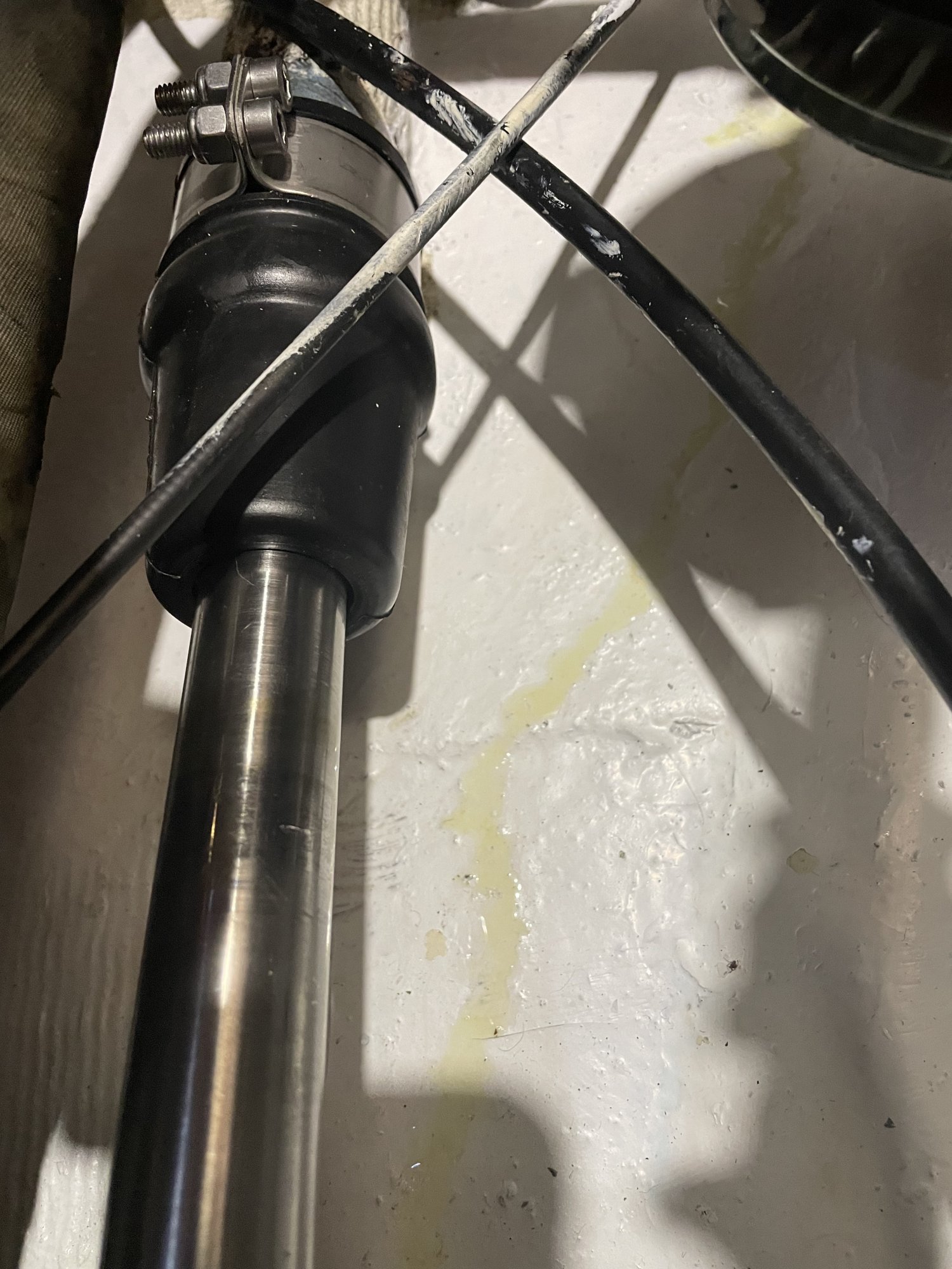

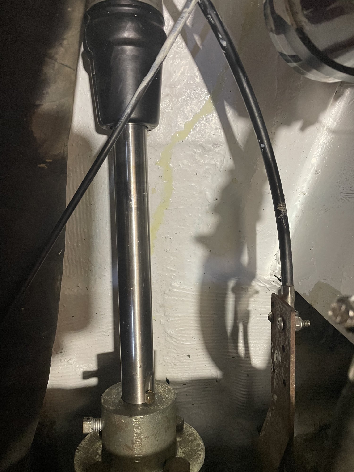

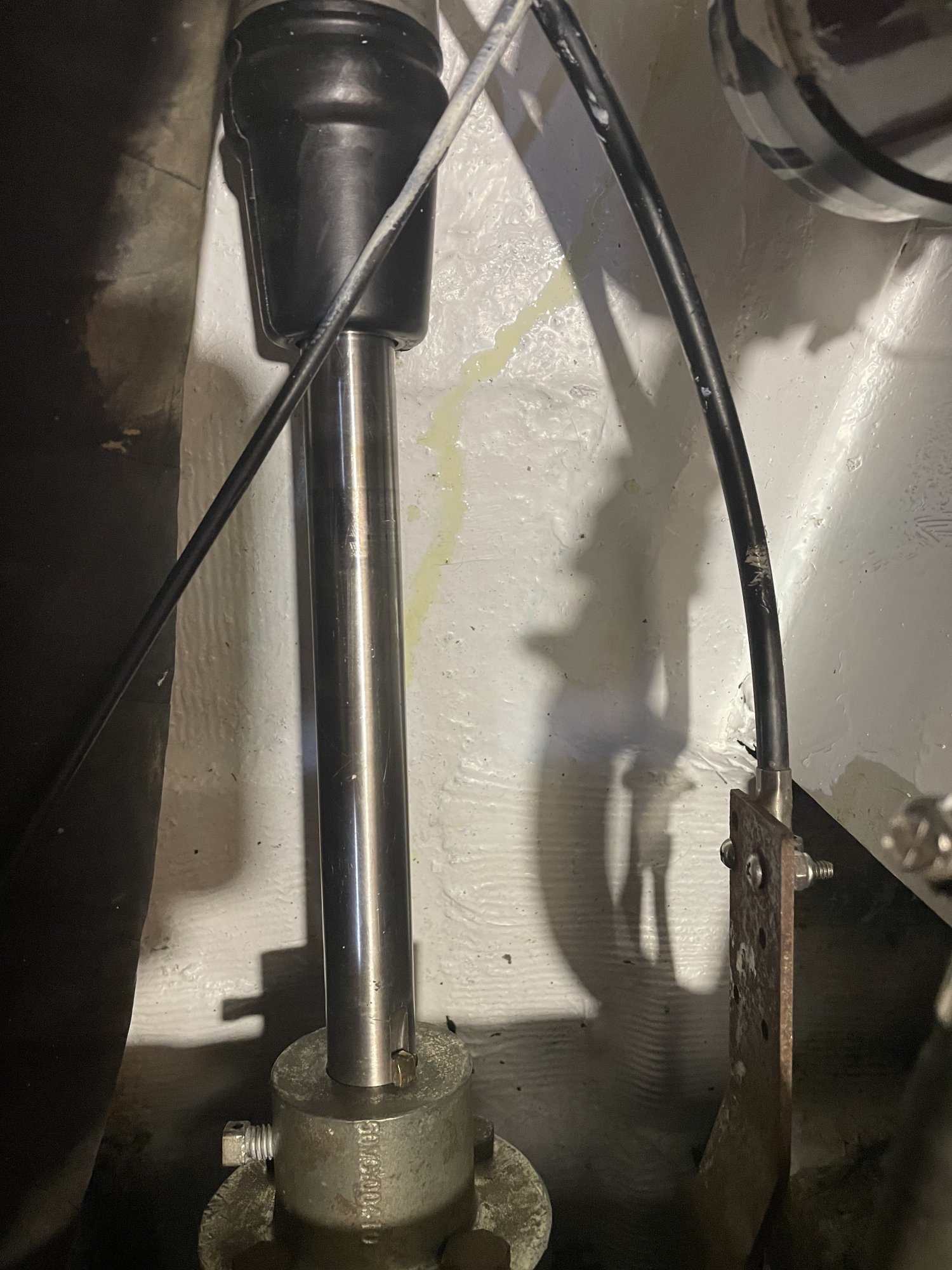

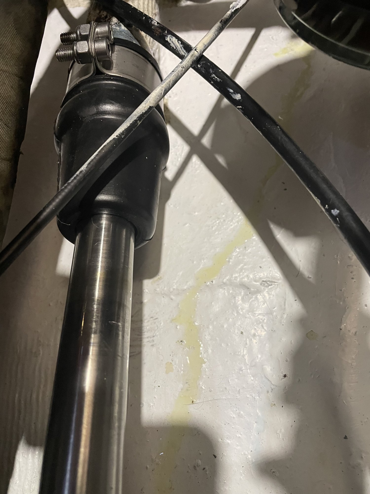

I have successfully changed my prop shaft, stuffing box, coupling and aligned it all so it doesn’t hit the shaft log.
Just put the coupling back on today, and bolted to the transmission.
72AD34FD-2D71-4B2D-BBB6-037A24331E1F.jpeg B3C9CE43-4574-4E21-9D71-27323F71C107.jpeg
