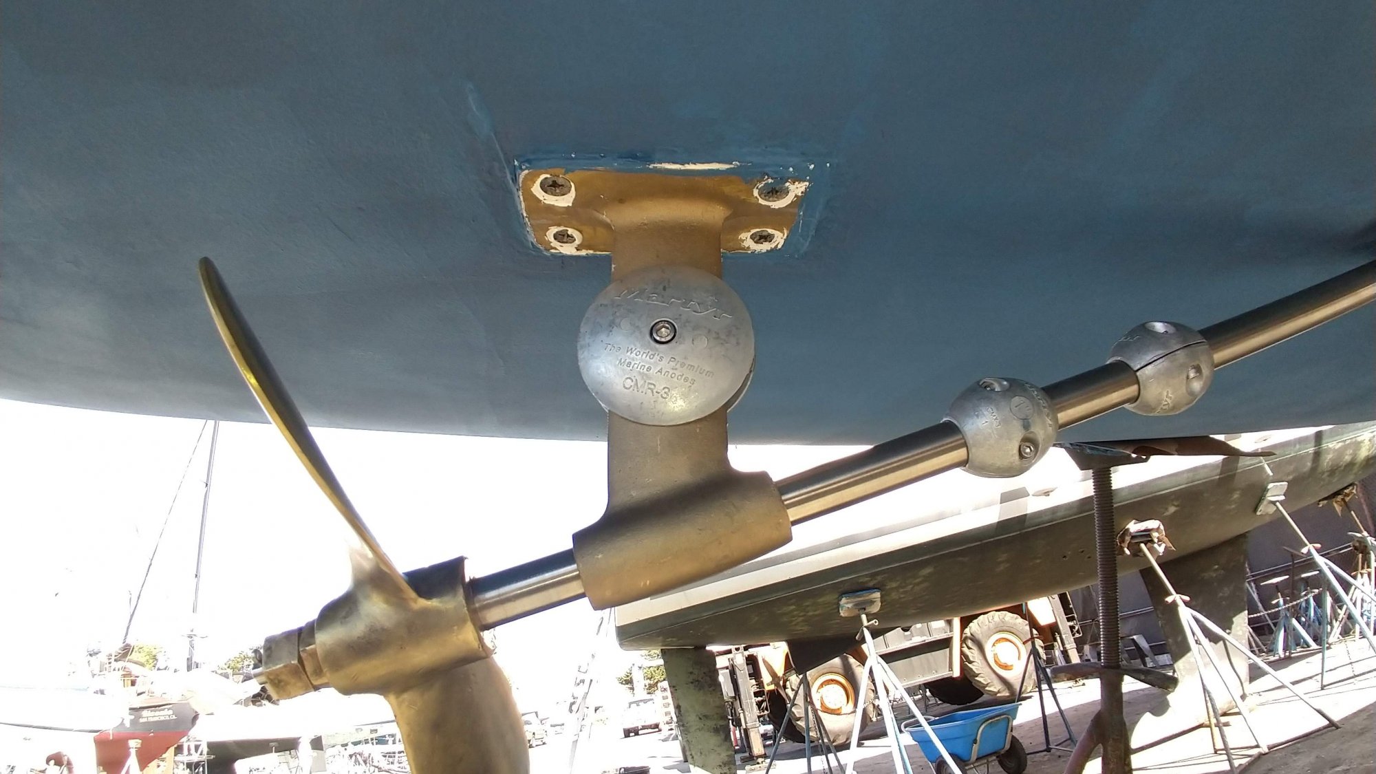

Putting out in another thread as well, but have friend with hunter 34 that just lost shaft, strut and prop
10,197
This site store has the strut.. some are two bolts, some are four bolts, so ya need to know which. The original prop was a Michigan Wheel "Sailor" two blade and was 15X15, right hand.
EDIT: I don't see the strut on the store pages anymore, so you should call the good folks and see if they can get one
The shaft is 1" with a standard prop taper.. A new shaft coupling will be needed too
EDIT 2: four bolt Strut, Southeastern Foundries Corp, 2706 Oakland Ave, Greensborough, NC. 27403, Strut #1503, 31-34-37’ (1X1.25) HM 316700. Phone 336-299-7211

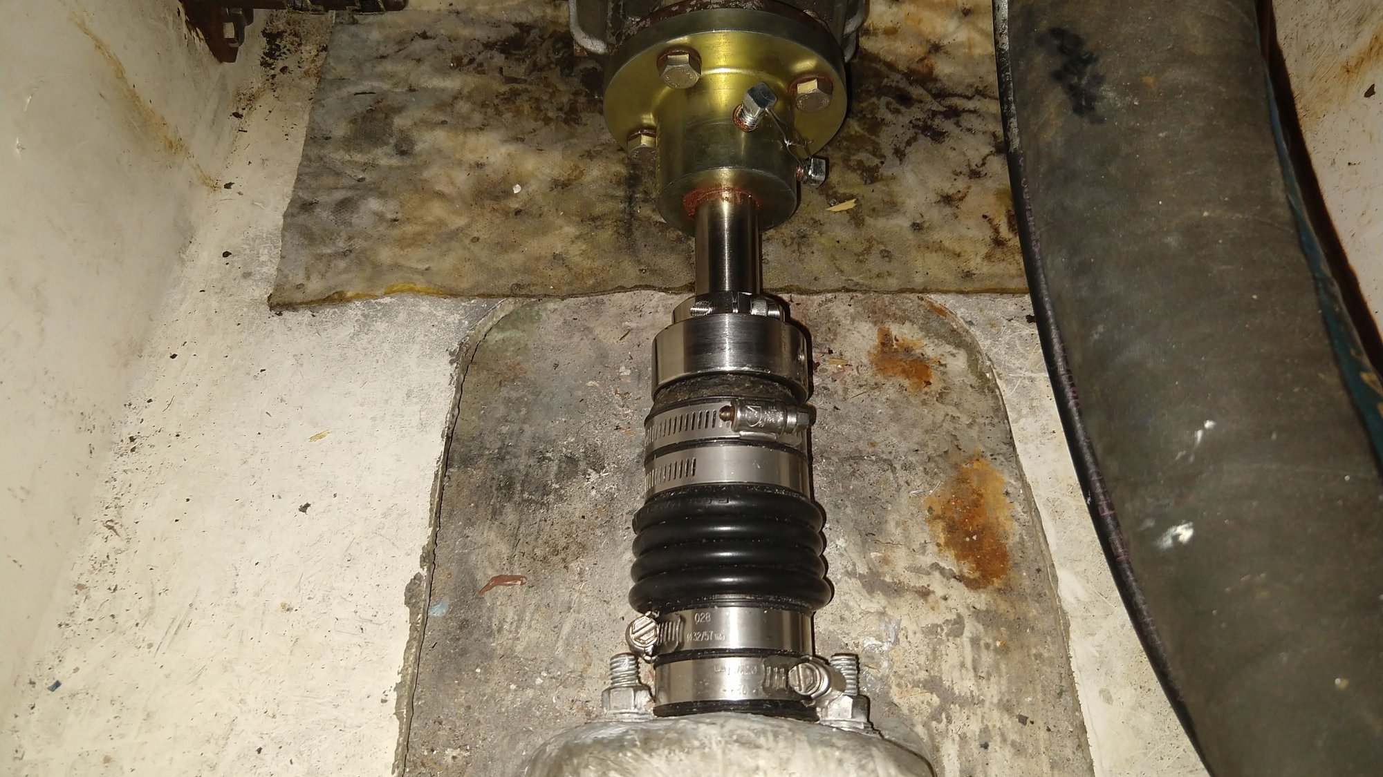

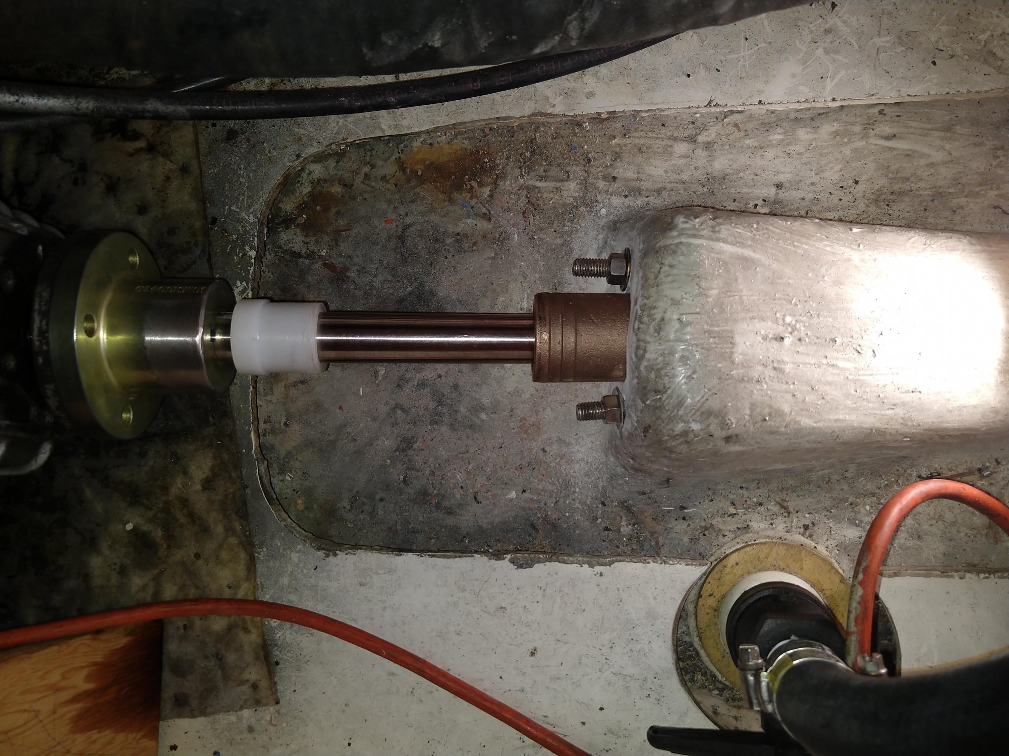

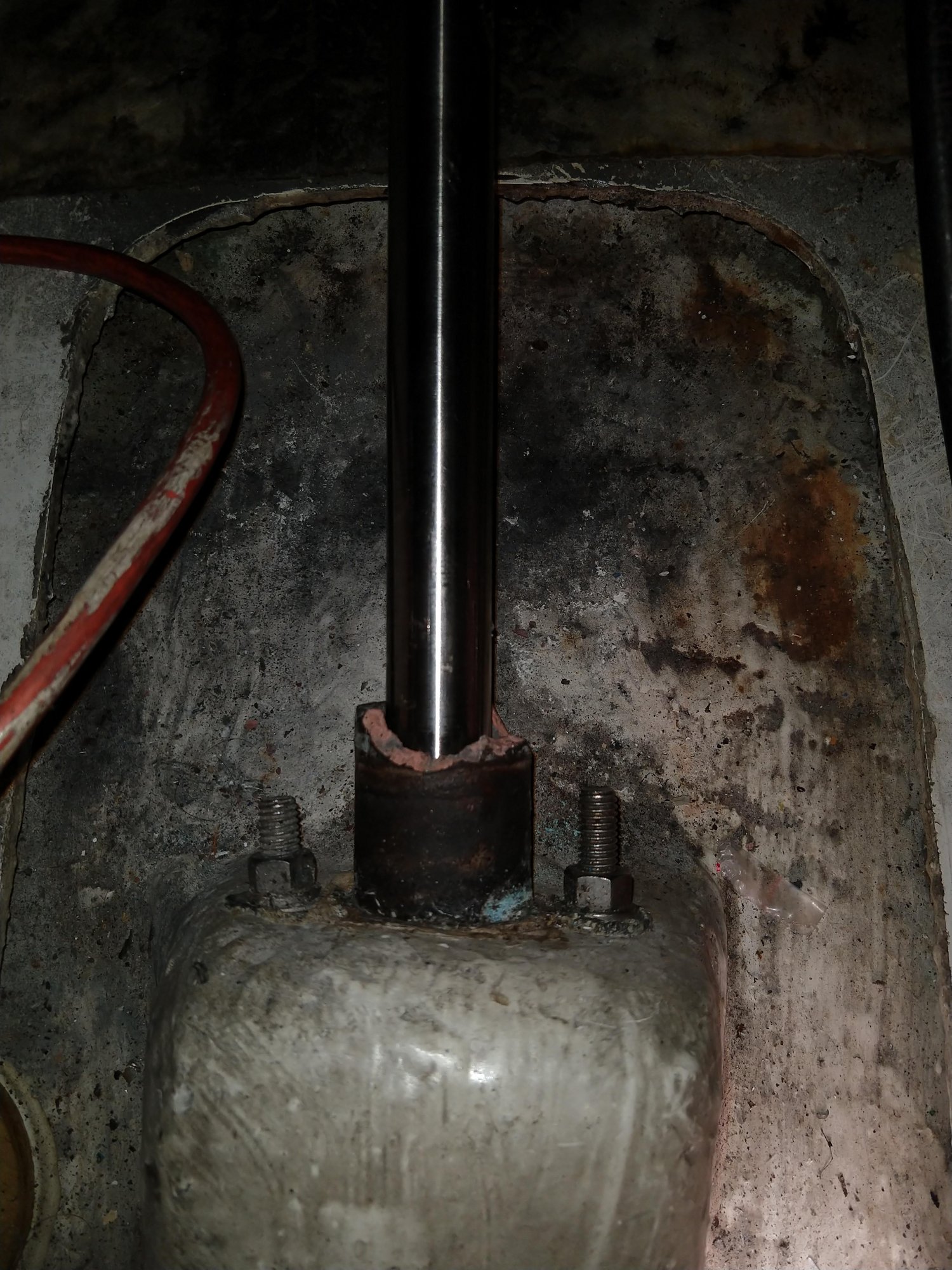

I went through this in September 2019 as well. An unexpected discovery was the stern tube that had deteriorated as well. It couldn't be seen until I removed the rubber hose from the shaft seal. Luckily, I could buy the correct one right here on the HOW site along with a new strut. I got the new shaft locally including a fit and faced coupling.
