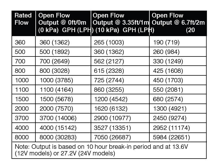

Uh oh, time to get technical here.
The way to get a rough idea as to what the pump is doing is to first attach a piece of clear tubing to the discharge of the pump. Doesn't matter how small the diameter is. Make it reasonably water tight using duct tape.
Run the tubing overhead, at least 10 feet in elevation and then see how high the pump will push the water. This will show you the static (non flowing) pressure of the pump. The height of water should be well over the level of the thru-hull.
The attached chart will give you an idea of what kind of flow rate you can expect depending on the pressure (created by the friction of your hose plus the height of the thru-hull above the pump) delivered by the pump.
