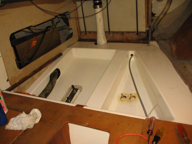

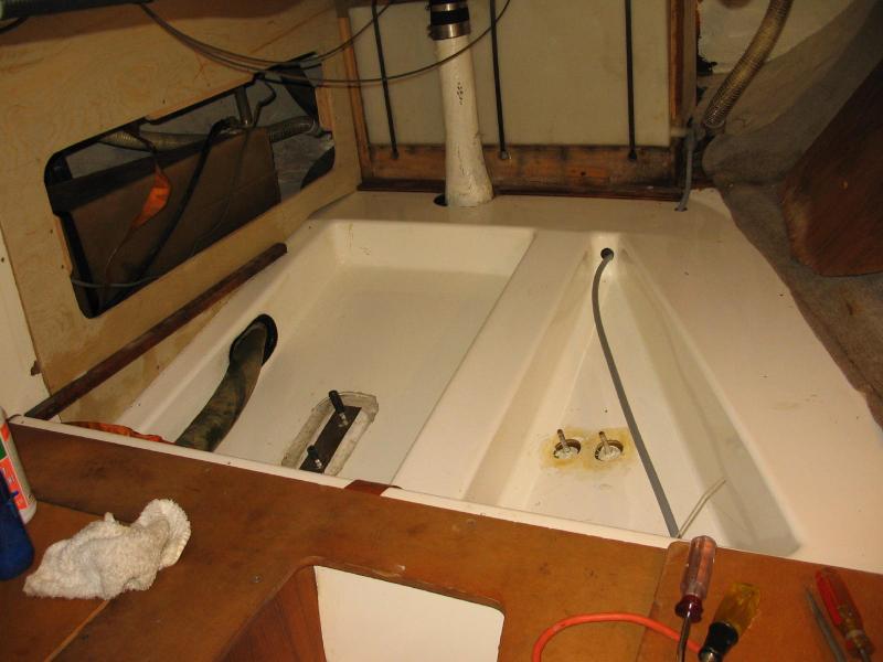

Yeah. . . That’s one of the issues with the H34. I moved mine to under the port settee in the salon. Better access and better weight distribution. Others have cut an access hatch in the plywood wall between the aft berth and the “dungeon” This also give access to the fuel tank.

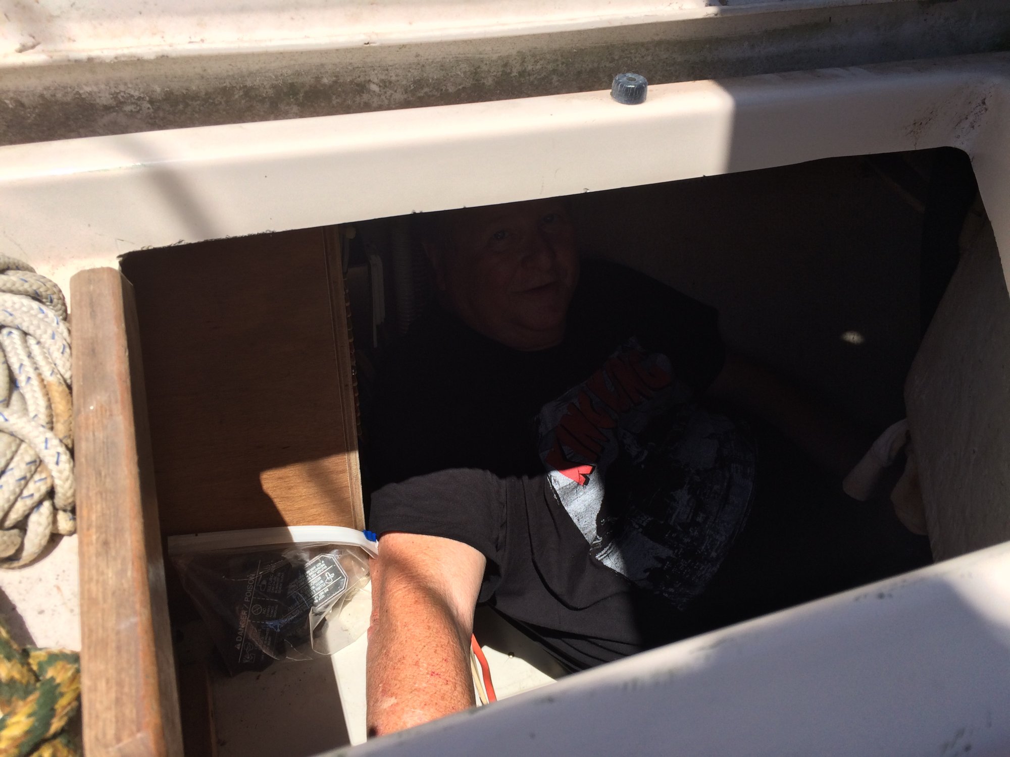

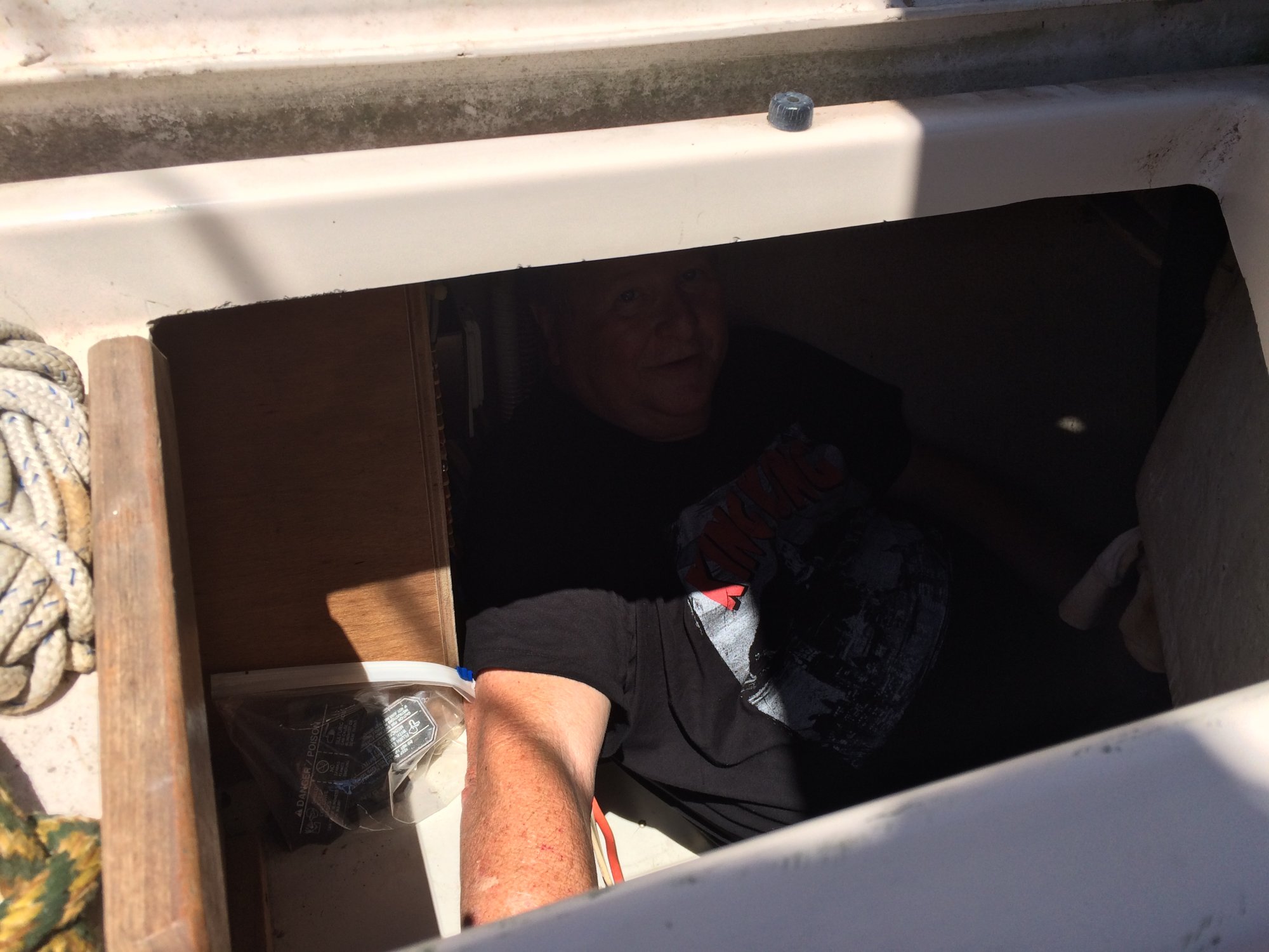

Couple of options.. I put in a remote watering system so I could water them .. Some folks have cut an access door which also allows much better access to the fuel tank. Attached photo is the one Claude Auger put in his 34. Or you can climb in I am 6' and 250 pounds and I can wiggle in and out slowly.. If ya go in, tie the seat up so ya don't get locked in.. and it helps to have a piece of line from the boom . The line acts as a handhold and exit helper!
