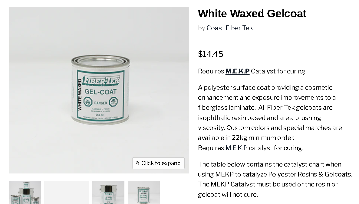

Jan 4, 2006
7,759
Fiber TeK is just a small company in Vancouver which has this Gel Coat packaged for them. I think it's just as white as white can be. Nothing special in the world of gel coats. They'd likely be the same in your area and a small price to pay for the experimentation.
I think all later models of Hunters are pure white and somehow don't yellow with the UV. Mind you, I also believe in this :
............... as the elixir of life :p.
May 10, 2026
3
Hunter 336 Southport
Unfortunately it appears the Fiber Tek folks won't ship to the us currently. I'm going to try the Totalboat product. I'll update and let you know how it works.
