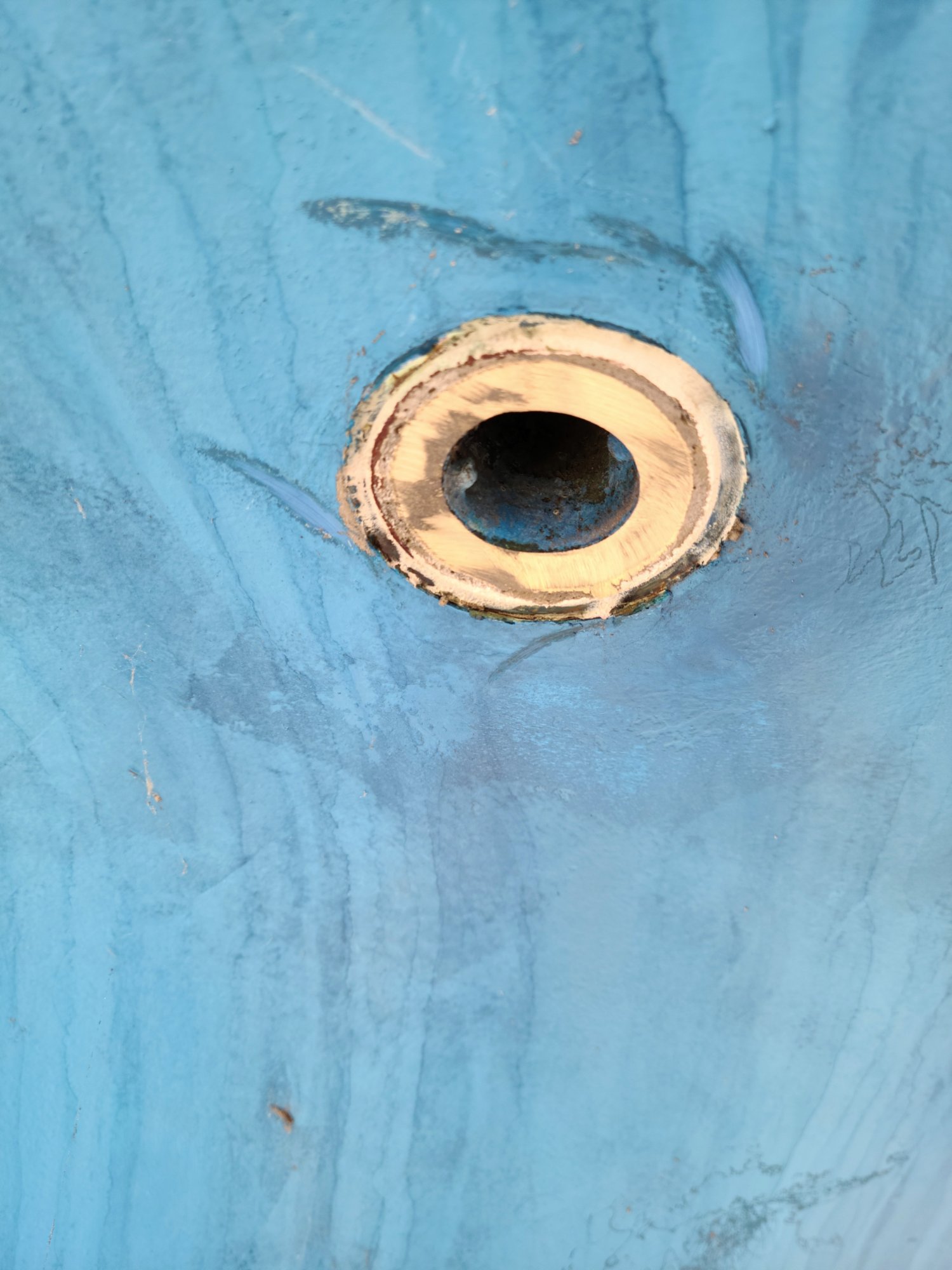

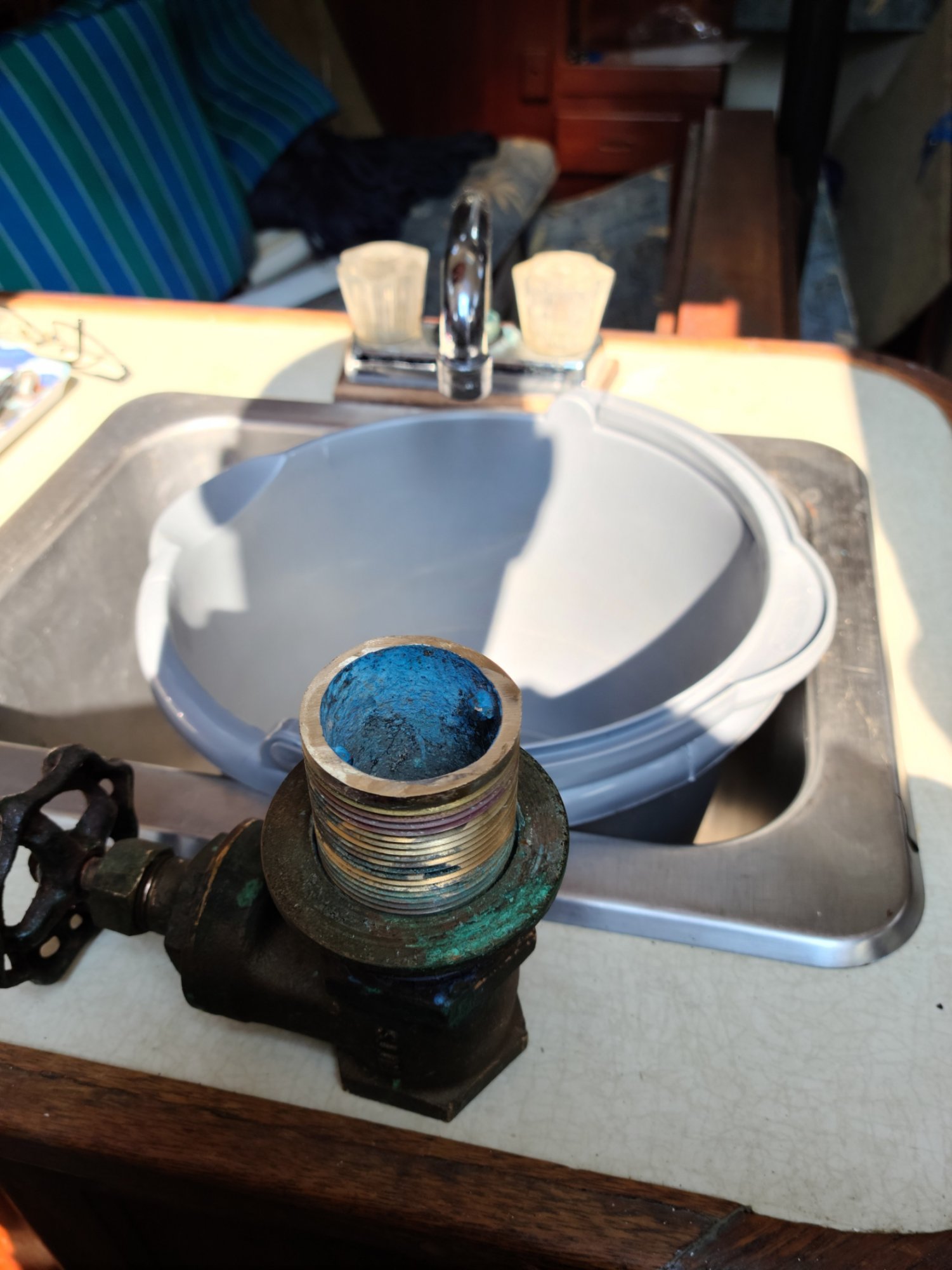

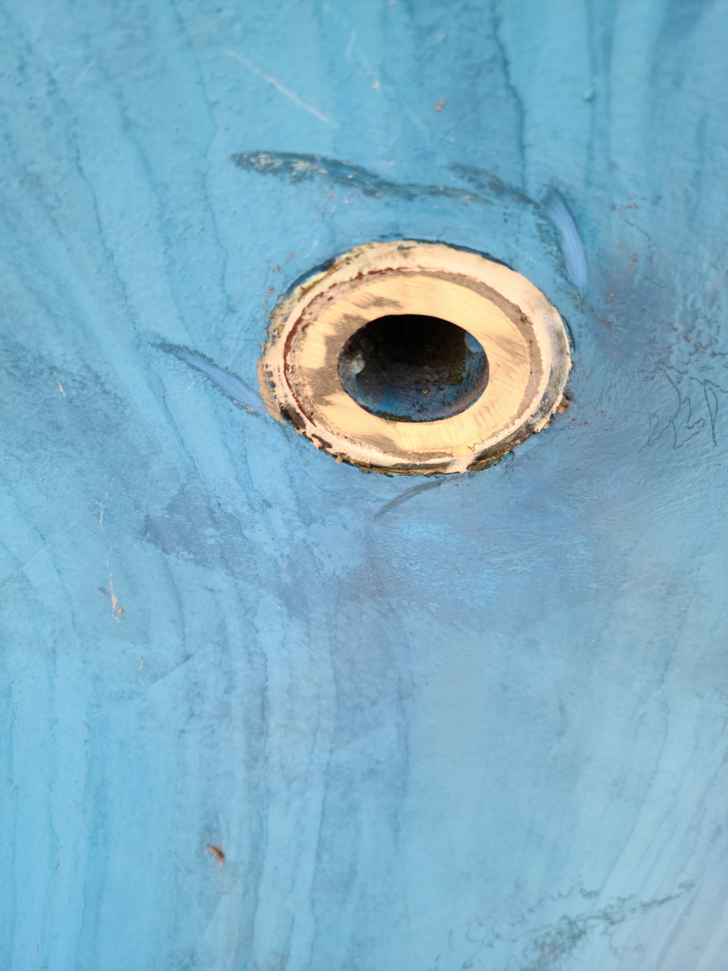

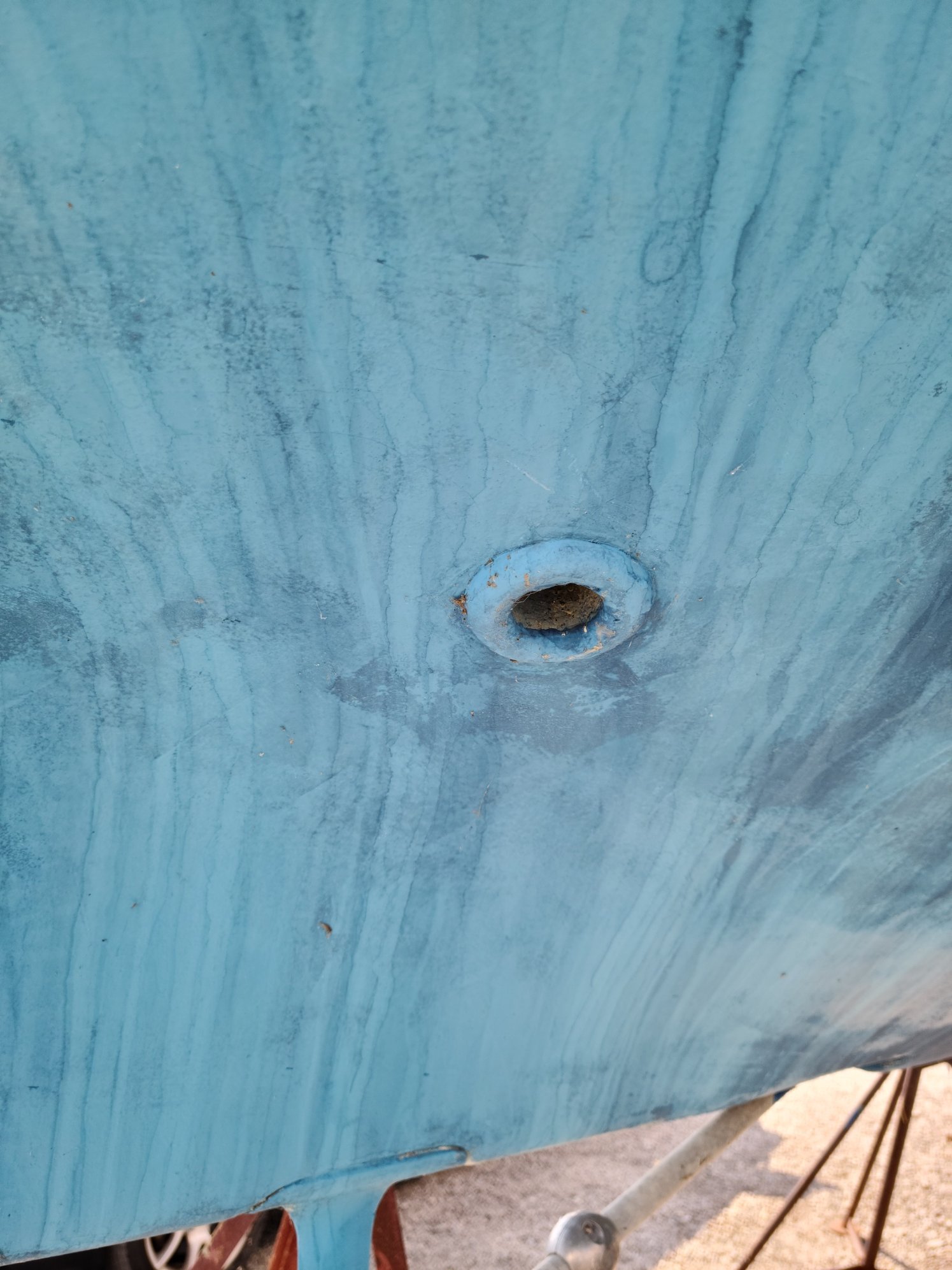

Man is it a good thing I decided to replace the gate valves and through hulls. As I was working on the waste TH, so much rust just fell out I figure the gate itself disintegrated sometime in the past.
So I got it ground off and I can work it back and forth in rotation. I couldn't get the hose off, though. Any tips on getting the original waste discharge hose off? I couldn't even "rotate" the hose around the nipple.

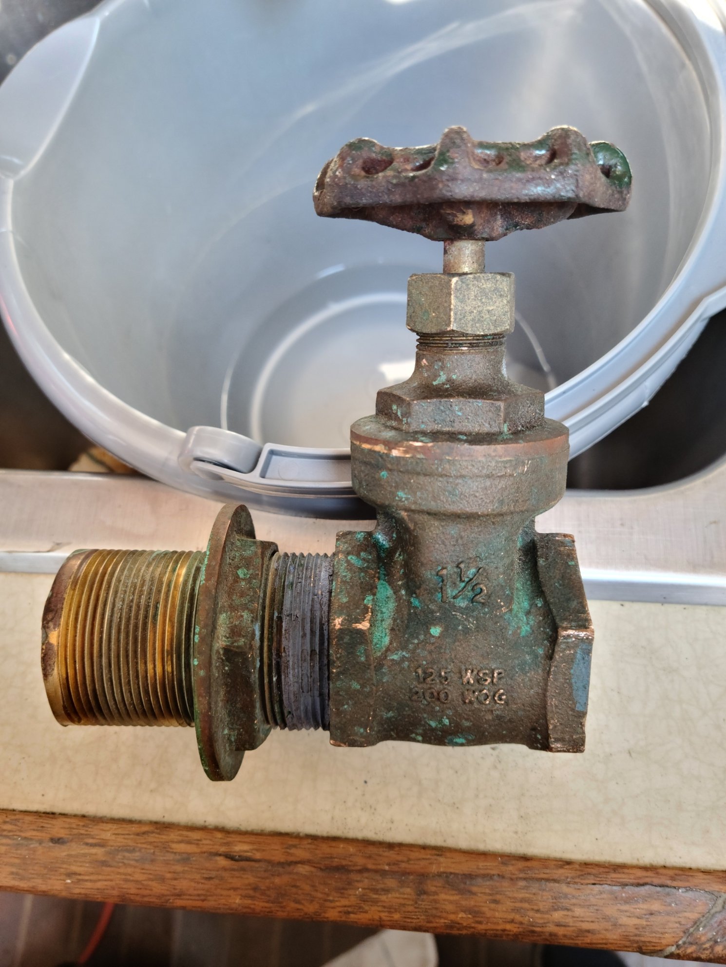

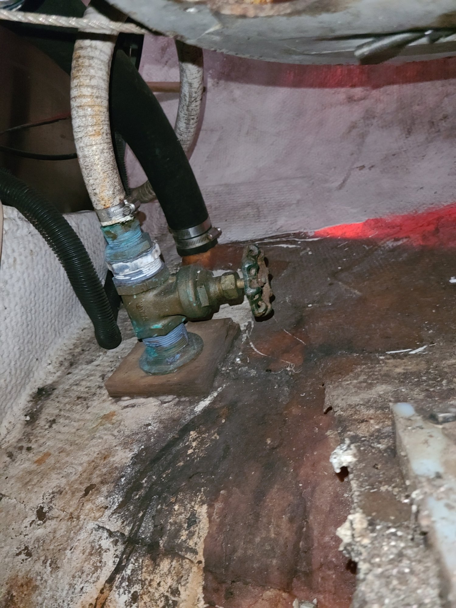

They are gate valves. The sanitation discharge is a 1 1/2" gate valve with some sort of plastic reduction fitting. At least I think so..
Looking at the GROCO site, I can't find a 1 1/2" thread to 3/4"
I am thinking about replacing the hose to the valve.

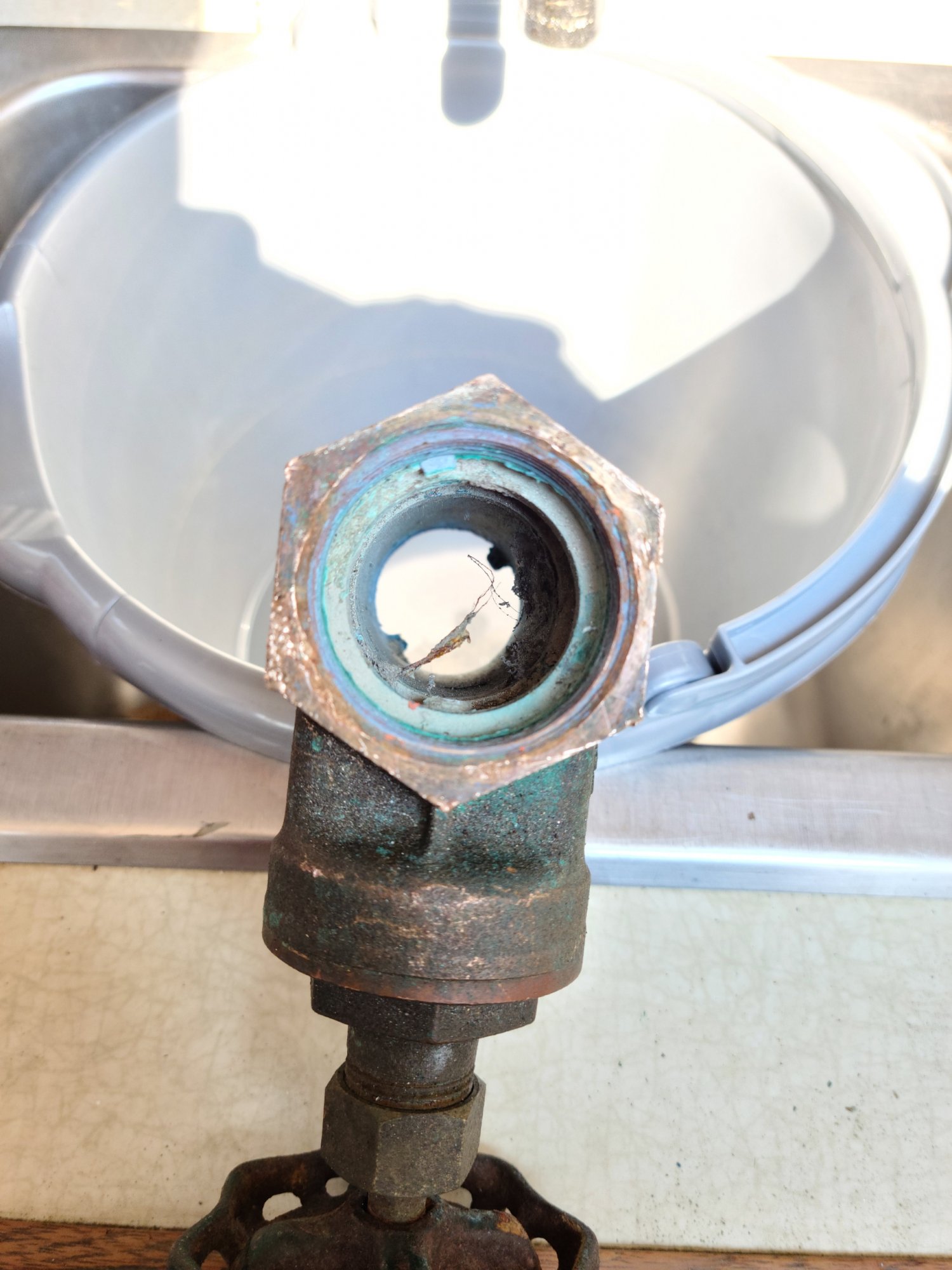

See the reducers in this photo? It looks like 2 to me.
The manual says this hose is supposed to be 1 1/2" but I think it's something smaller.

I like the manner in which you grinded the thru hull fitting to remove it. That is my preferred method also; quick and no busted knuckles trying to wrench the valves from the thru hull.
Yeah it was pretty easy. It took me less than an hour and less than 3 batteries for my craftsman grinder.
/QUOTE]
As all those who know me on here know, I would recommend nothing else but Forespar Marelon for replacing your seacocks. For reasons far too numerous to list here and far too convincing to be overstated, these have become industry-standard on all quality sailboats (for some reason motorboaters won't be swayed). These are very easily installed with 5200 (use nothing else) and the best news is that, since I did mine, Forespar now offers the round-base 'OEM model' to the general public. (I got my OEM ones by virtue of being in the trade. The triangle-base 'field retrofit' ones are a little more hassle to install.)
I would not waste my time or effort installing any bronze seacocks in this day and age, especially when so much metal comes from southeast Asia and so much of it has been proven to be simply terrible in quality on so many other products. Half of the 'affordable' ones are half brass and will last half as long as you'll have your boat. Marelon is good for 40-50 years (judging by the boats I know of that vintage with RC Marine seacocks on them). Accept no substitutes.
If you order them direct from Forespar, tell Randy I sent you :)
I understand some people want to use 5200 on things that will never be removed, but yet here we are, talking about removing things that would never be removed. I am quite against 5200 in that regard. I believe things should be easily maintained. Including removing a seacock that needs removed.
Thanks for the tip! I'll check Forspar out.
Try heating it with a hair dryer (or a heat gun if you are careful). The heat causes the wire wound hose to "relax" ever so slightly and sometimes just enough to release it. When you re-install the old hose or preferably new sanitation hose over barb fittings, apply NON petroleum grease (Superlube) and heat (if required). The non petroleum grease will not affect the hose material. Someone once mentioned avoiding lubricant as it will cause the hose to fall off. Put all your strength into trying to pull apart a hose clamped, barbed fitting and good luck.
If the hose is going to be removed and replaced, and you can't get it off by rotating or pulling on it, have you considered slitting the hose the length of the barb it is sitting on? So you have a broken hose end of a hose that's gonna go in the trash, right?
I haven't decided to replace the old hose. There's no smell, no cracking and the only reason now to replace it is because I'm "in the neighborhood".
I mean, I may replace it. But right now they find after replacing the valves and thru hulls, repairing the core in spots and replacing my strut bolts.
