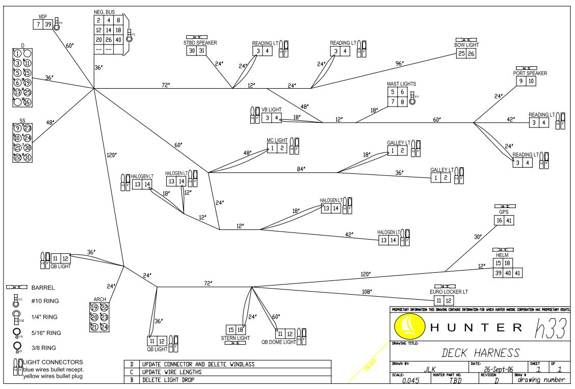

Hi I need some advice, my H33 does not have any wires / power leading to the steel arch and I want to add 12v overhead, so I am thinking to use a drill to make a hole in portside locker in the middle of tube and then rod a cable up to another new hole in the same tube at the top somewhere. My question is has anyone else ever added power or routed a cable using this method or do they know if one of the tubes has a designated hole already in place to add a cable? I mean to add a light overhead or a speaker.

.........just need to know if one of these arch plates is already prepped with hole and which one it might be.......
Great question.........is your arch an original Hunter factory installation without wiring or an after market?

Thank you for the replies I am now going to look at the starboard side in aft cabin, as far as I know this very much a factory job, made in UK but identical to the USA boat in everyway. Many Thanks I will be looking tomorrow Saturday and see what I find, I cannot see any holes in the arch under the traveller track but if there is a hole in the starboard side forward leg then that is great :)

Well update I have a panel in aft cabin and on inspection the bottom of that forward arch foot plate is not drilled there appears to be part of the loom with a connector and 6 wires. So I guess I am going to have to drill up through the boat grp and into the tube. Thanks for replies and help. J

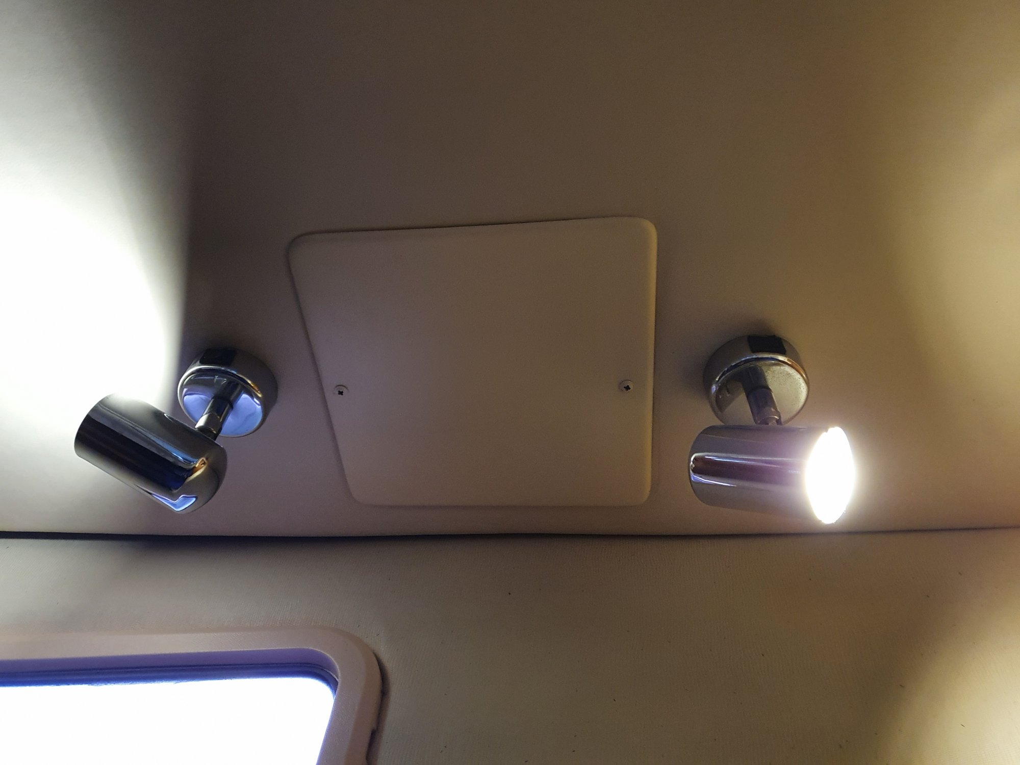

Hi no backing plate ohter than the one outside on bottom of the leg, inside the cabin I remove the cover plate in picture to see the gel and the bolts coming through from the arch. Sorry if I have misunderstood something. J

Hi all, II did manage to drill up in the centre of the front starboard arch leg, it was hard going, but is done and I have 12v up there, the loom was also present just below the leg, I just joined up my 2 core to the 12v supply on that light circuit. Thanks to all :)

Sorry I missed this thread earlier, could have saved you some time. You must not have the arch panel with light and 2 speakers? I used that race way to run the wires from the solar panel to the electrical panel above the chart table. If you're running wires, there are 1 1/2" PVC tubes that run to the chart table and from there to the v-berth. Also another under the galley floor.
Feel free to either private message me or tag me ( @Scott B ) in your post with any questions on the H33. We've had our 2005 for 14 years.
