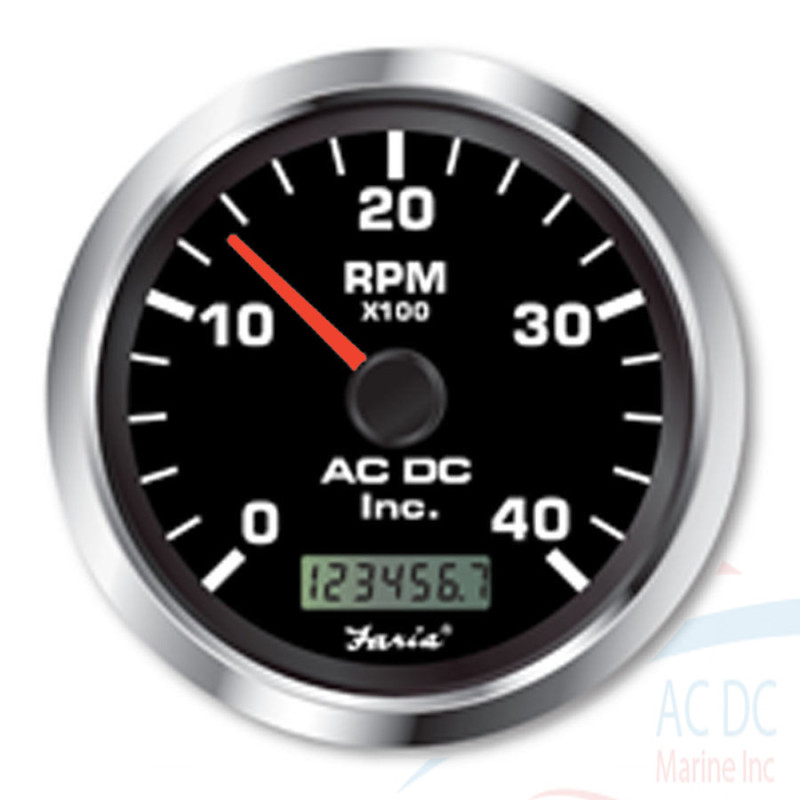

Mike, I believe you are referring to the hours on your diesel engine. If so then an hour meter is often incorporated in the cockpit engine panel tachometer gauge. Here is a pic of one but not necessarily from a Hunter 33. Here the hour meter is showing 123456.7 hours on the engine.

When I purchased my 2007 Hunter 33 in 2009, I believe the Seller showed me where I could see the Hours used.
Therefore, I believe I do have an Hour meter, but I do not recall where it is located.
Either on the ignition panel as shown on a previous reply, or close to it. Rare but could also be in the engine compartment. Finally, could be next to your electrical panel may I figure you would know. One way to find out if you have one is listen for its click. First disconnect the oil pressure wire from the sender to silence the buzzer, then turn the ignition key on and listen carefully. Most time if all is quiet you will hear it click. Good luck
